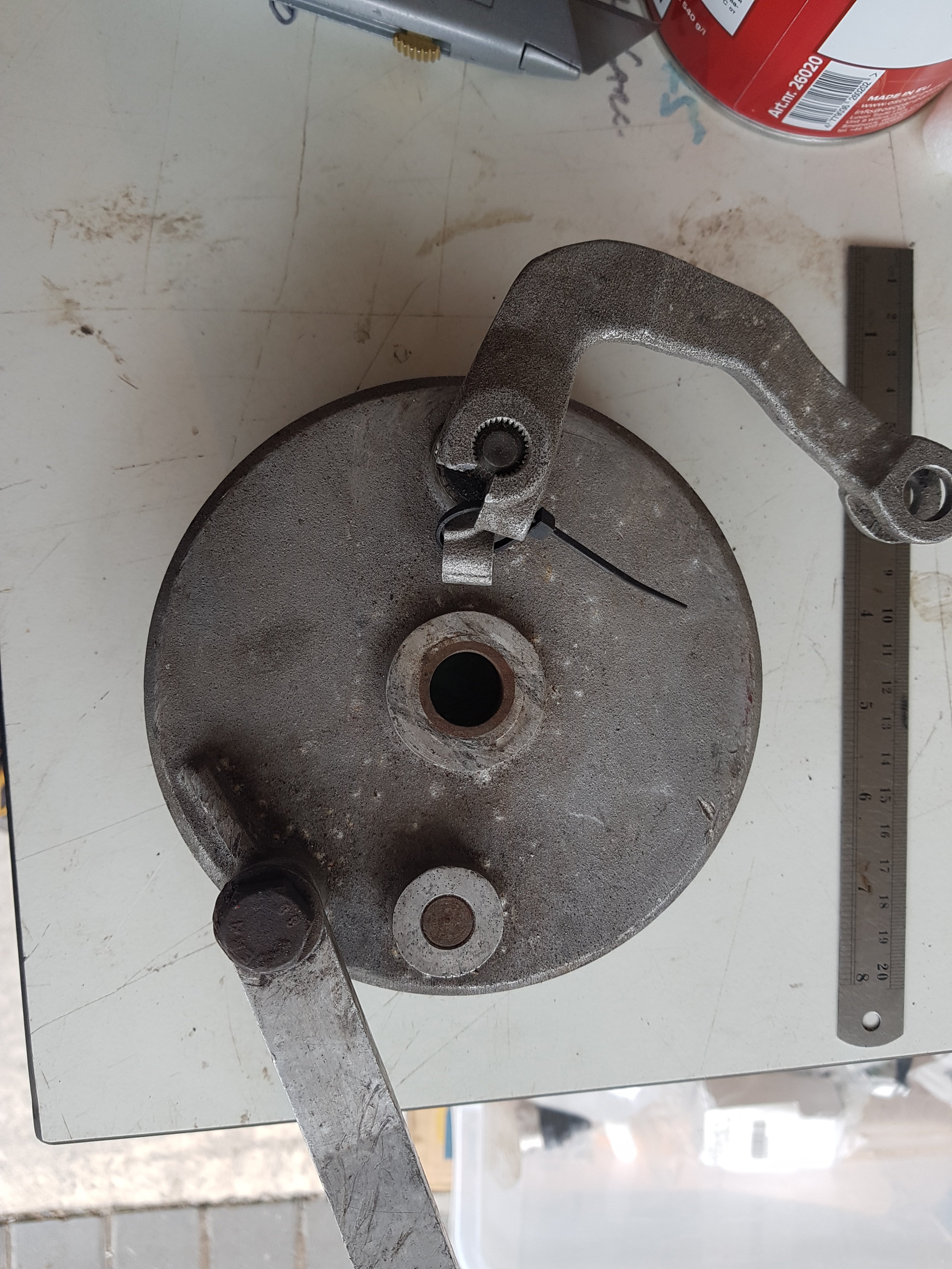

Does anybody recognise this rear brake plate, It's 133mm across shoes 12mm spindle numbers inside? Part number who knows. 340.16.002.03 montesa ktm husky?
Have never encountered a Brake Arm like that on any Sherpas, Pursangs, Fronteras, or Metrallas.
The casting doesn’t look to Bultaco as it a has much less smoother exterior than the usual Bultaco finish.
That’s just my thrupence worth. ?

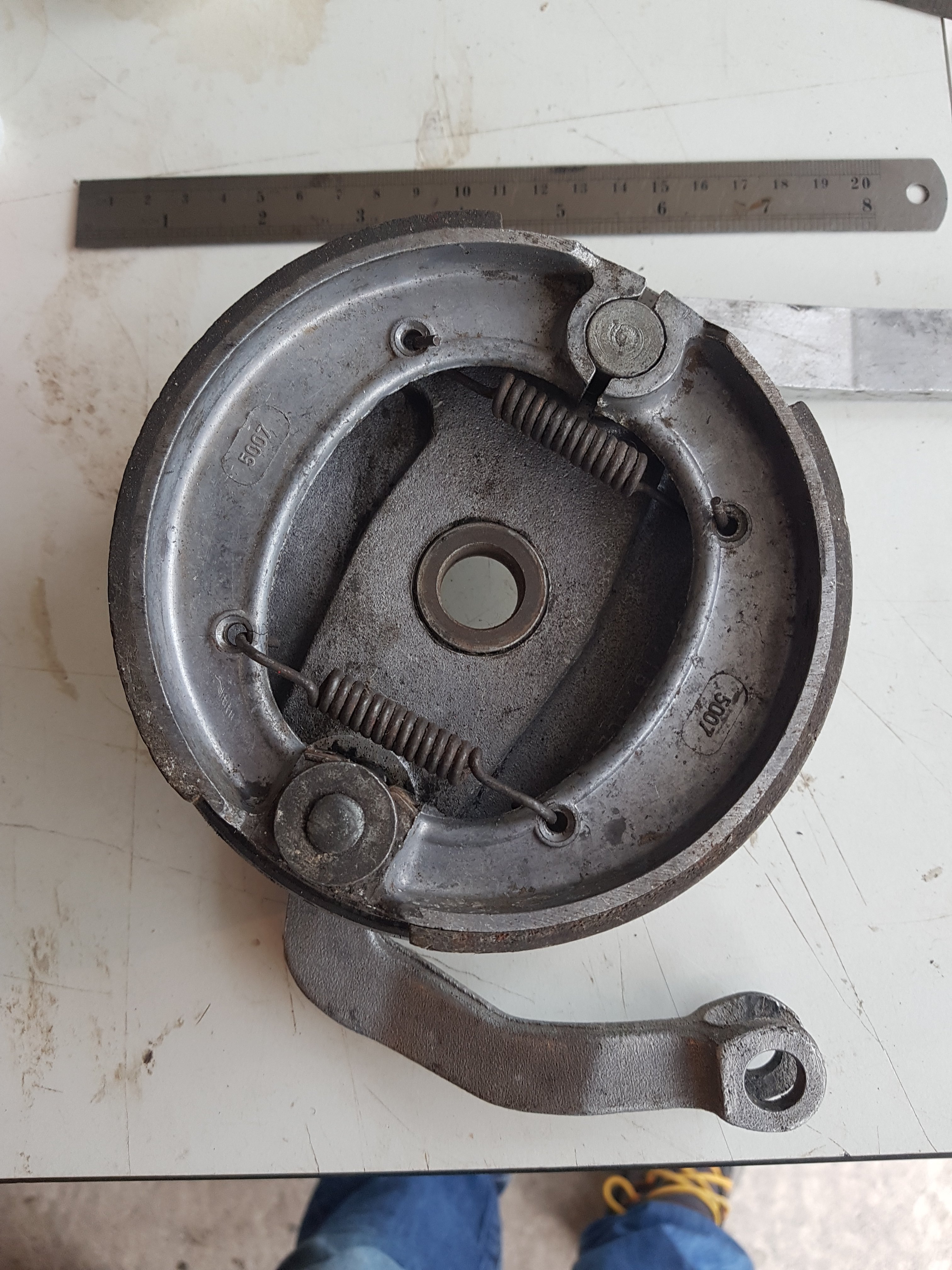

Cross referencing on the part number shown on your brake shoes (5007) indicates that they are aftermarket brake shoes that fit the rear wheel of a KYMCO 50cc 4 stroke step-through scooter
