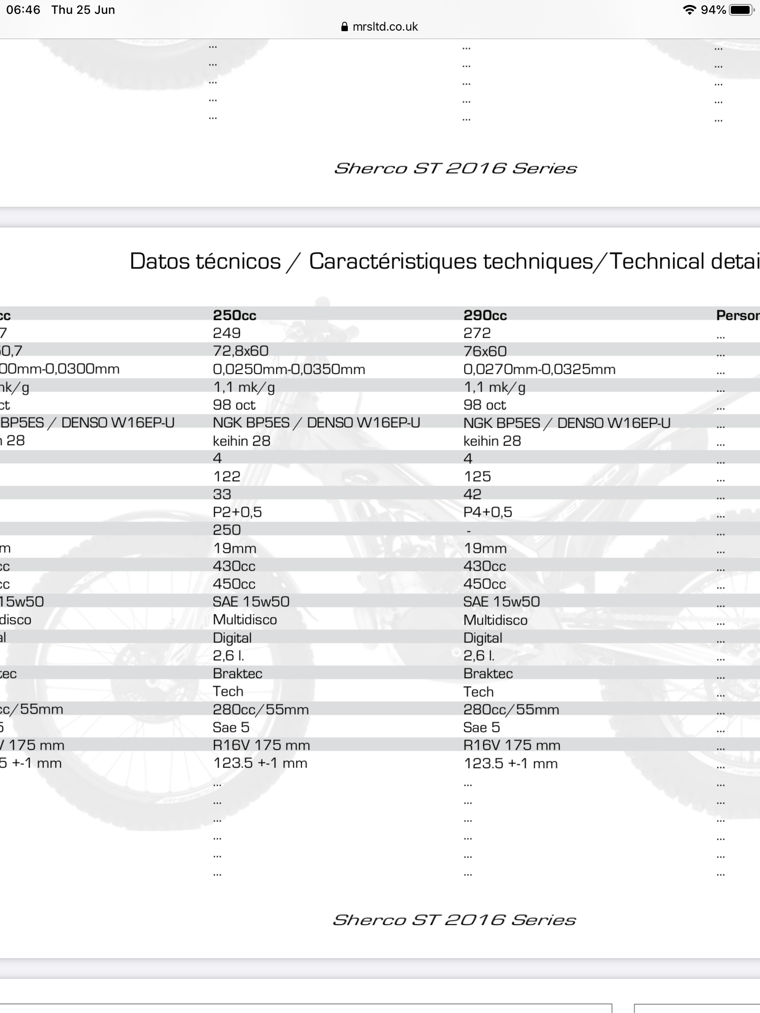

In the manual I’ve got it states that the pilot jet is 33, and the main 122.
As far as I know that’s what’s in there.

Just been on to my local dealer, I’ve been told that it should be 125 main, 45 pilot, needle second from top.
