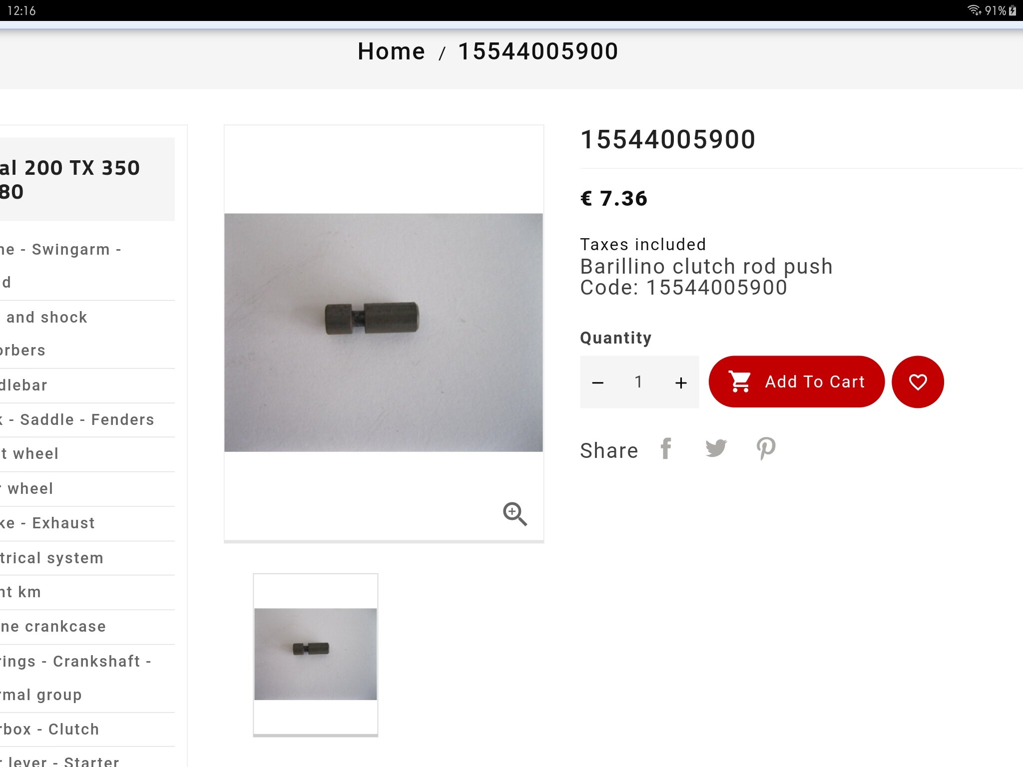

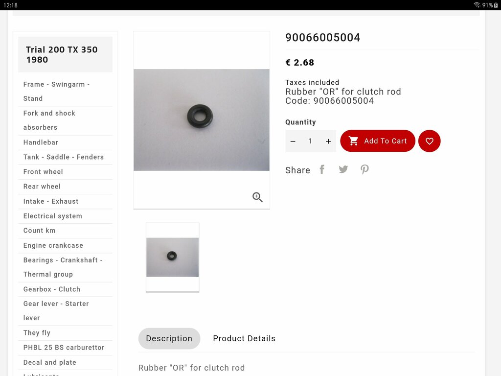

October 3, 20224 yr Hi got the same leak on my bike. Checked and the rods been replaced with a rod with no o ring...no the wonder its leaking. I've sourced one with 2 o rings, problem though they are from Italy 🤔 The parts are about 12 euro, delivery etc total 37 euro....24 GBP for delivery 🤮 £34 all in. See attached what they look like.
