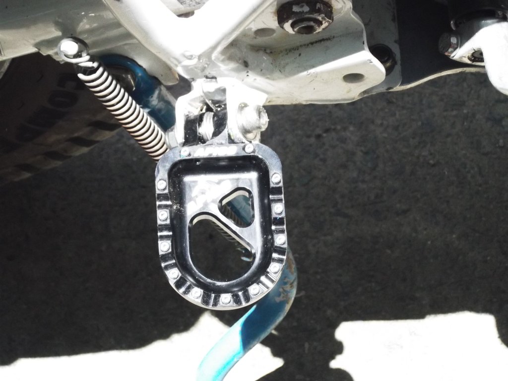

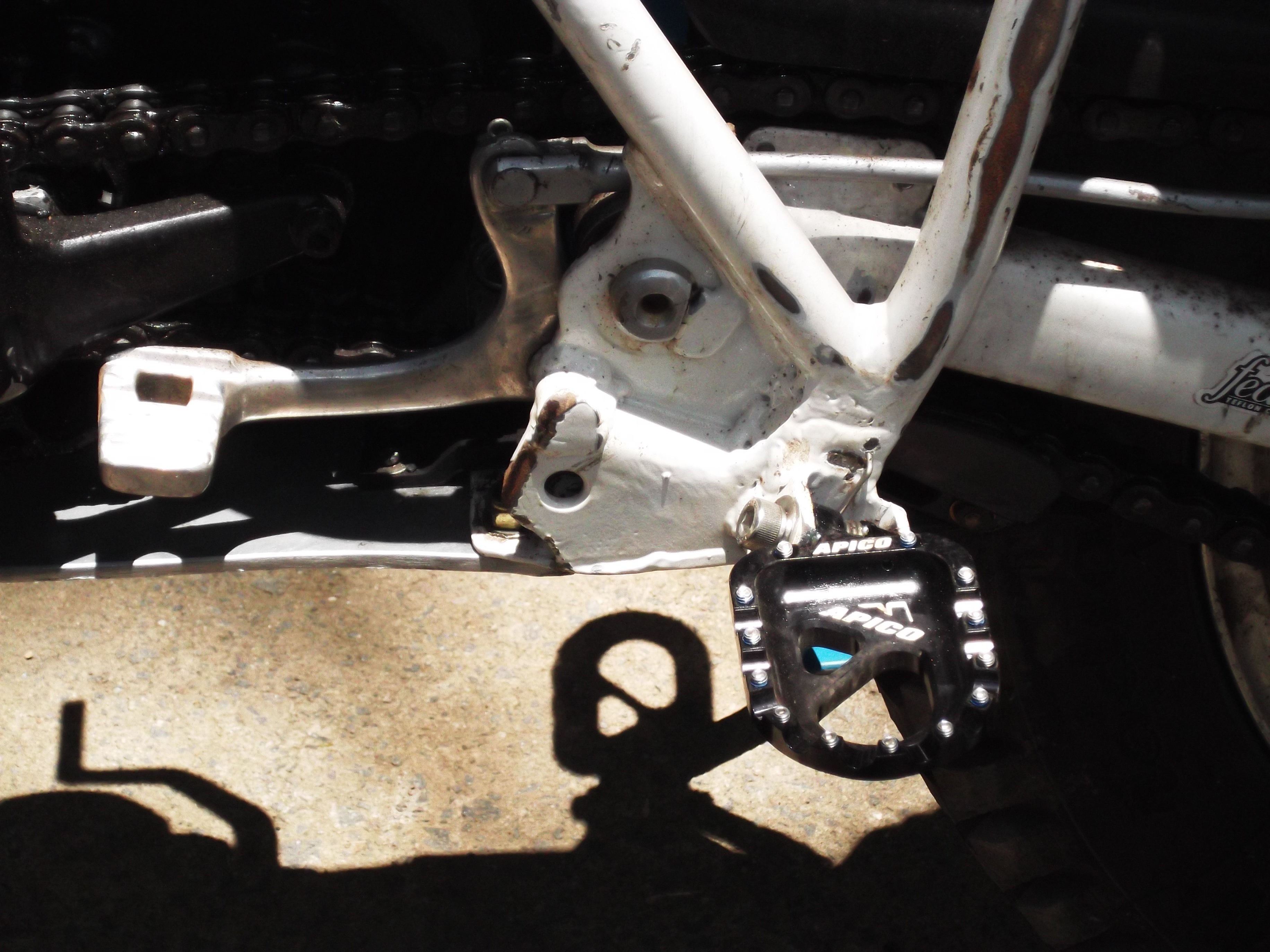

Something to consider when moving them back is the side stand, if you want to retain it this might be a limiting factor.
My sidestand spring is a fair way off my footpeg. I may look close in that photo but it`s not.
