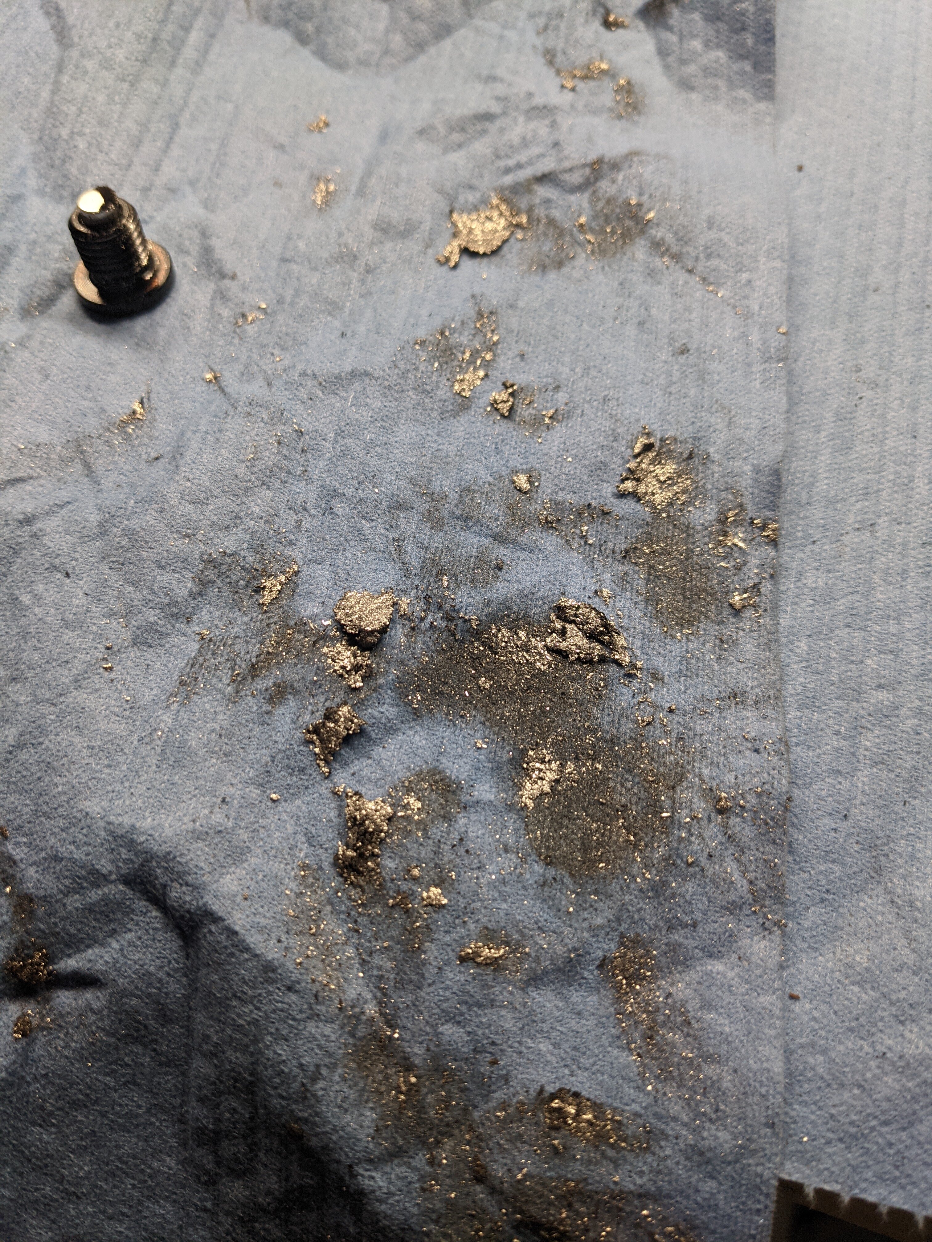

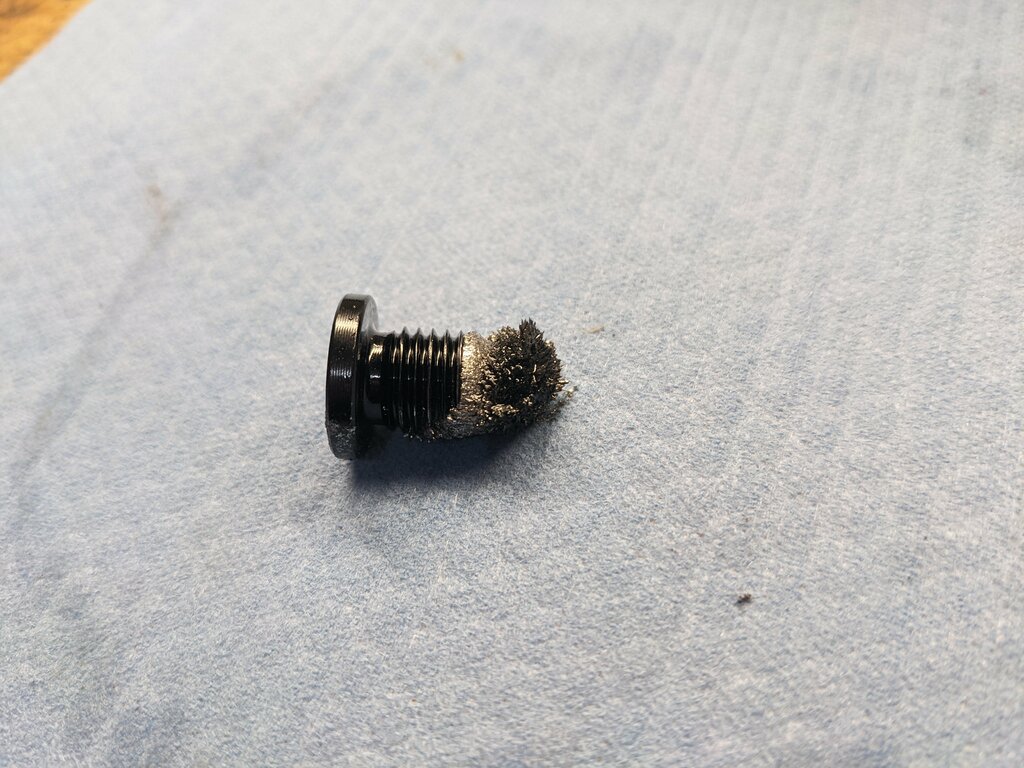

dakh Posted March 11, 2021 Report Share Posted March 11, 2021 (edited) Lots of metal flake in the oil and magnetic drain plug got a ball of the stuff on it, never seen anything that intense. Anyone done first oil change yet and had it look better? Edited March 11, 2021 by dakh . 1 Quote Link to comment Share on other sites More sharing options...
trapezeartist Posted March 13, 2021 Report Share Posted March 13, 2021 Ouch, that looks nasty. I'm guessing it's just the lighting that makes it look like brass (unless someone has invented magnetic brass 😀 ). Presumably the oil is lubricating the clutch and whatever reduction gears link the motor to the drive sprocket. As you're not clonking gears in and out I would expect negligible swarf, much less than a conventional gearbox. 1 Quote Link to comment Share on other sites More sharing options...
dakh Posted October 1, 2021 Author Report Share Posted October 1, 2021 (edited) 2 hours ago, CReamflourish said: I've just picked up a used Epure Race and just done a precautionary oil change, my plug looked very similar. Not sure exactly how much the bike has done with the previous owner, but based on condition and what the dealer told me, I'd say it's less than 10 hours. I'd like to think that there wont be as much on the plug at the next change. Mine didn't get better with the second change and then the clutch started slipping, I'm guessing from the metal shavings getting into it. I took it back to the dealer and they weren't able to make any progress on it for 6 months. I gave up and I'm getting an electric KTM freeride.. Not the same thing but I expect better manufacturer support than this POS. Edited October 1, 2021 by dakh Quote Link to comment Share on other sites More sharing options...
trapezeartist Posted October 5, 2021 Report Share Posted October 5, 2021 On 10/1/2021 at 7:27 PM, CReamflourish said: I've just picked up a used Epure Race and just done a precautionary oil change, my plug looked very similar. Not sure exactly how much the bike has done with the previous owner, but based on condition and what the dealer told me, I'd say it's less than 10 hours. I'd like to think that there wont be as much on the plug at the next change. After my previous post, I bought a secondhand ePure Race too. In light of this thread I changed the oil as soon as I got it. There was only a tiny bit of fur on the drain plug. Quote Link to comment Share on other sites More sharing options...
emonk Posted August 26, 2022 Report Share Posted August 26, 2022 I'd thought I'd add my findings since it was a concern of mine when I purchased my 2022 Epure race. I've changed the clutch oil twice now, and there wasn't much debris on the drain magnet for me, It looked normal and comparable oil changes on other bikes I've done. Quote Link to comment Share on other sites More sharing options...
