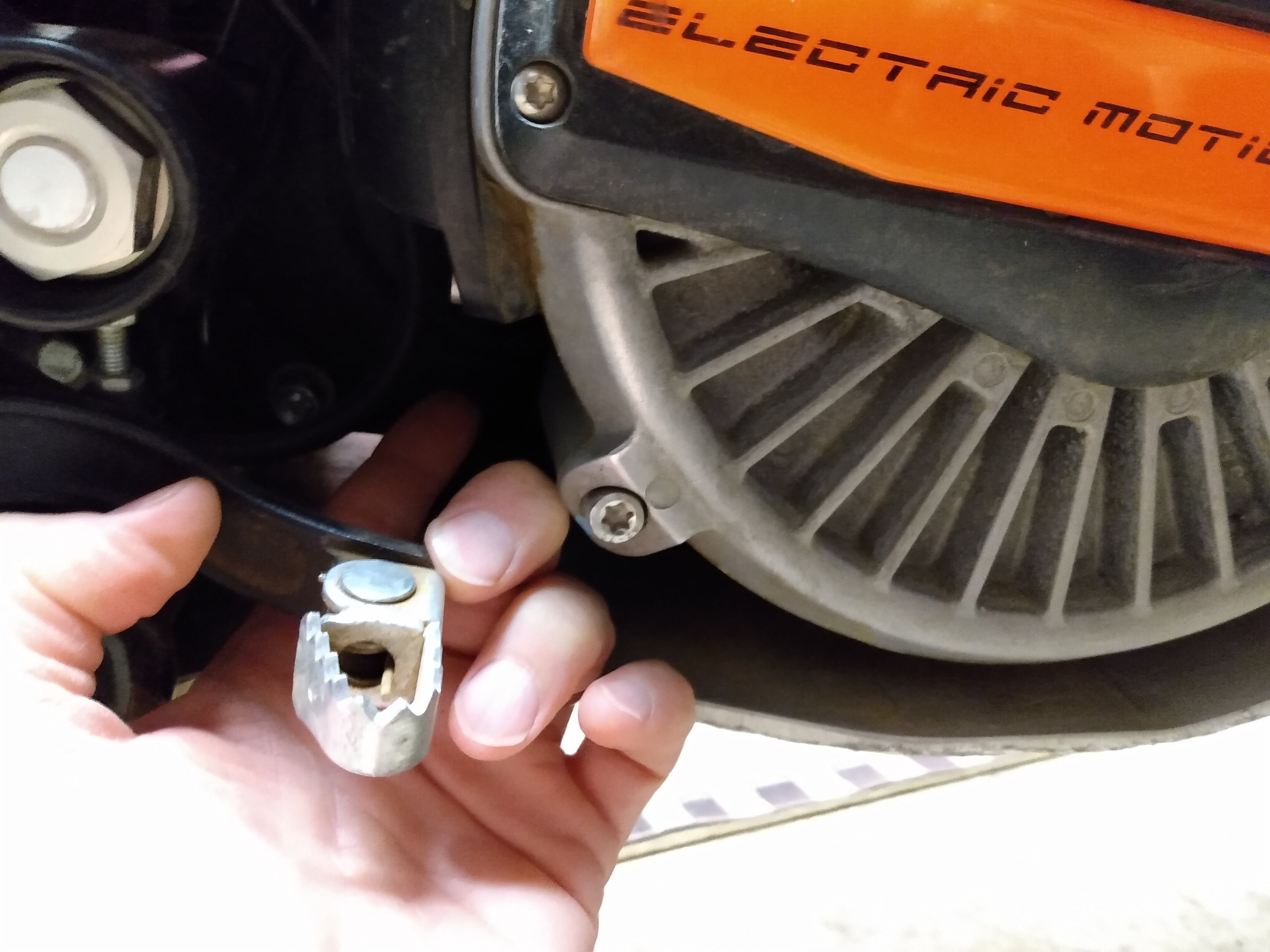

Joule Posted October 29, 2021 Report Share Posted October 29, 2021 16 minutes ago, dgshannon said: I attached a copy of the user manual for you, in case you don't have one. Epure User Manual 2021-2.0 .pdf 2.19 MB · 0 downloads My 2021 has a little window set back for viewing oil level. Index finger in photo is kind of pointing at it. Quote Link to comment Share on other sites More sharing options...

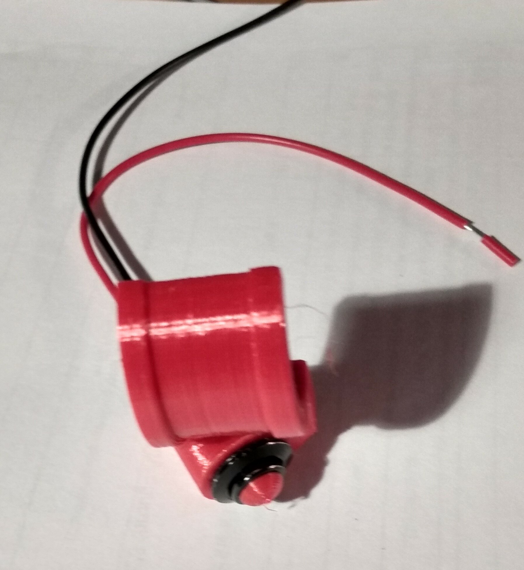

Joule Posted January 1, 2023 Report Share Posted January 1, 2023 Hello Nacho73, It might work. The FRB (I think on my 2021 epure Race there is a PRB dongle) needs to be able to supply the current for the Hall sensor in the throttle. I tried a hall throttle sensor which was pulling 5mA from a 5V supply and it affected the operation of the motorcycle. The haptic feedback on the MAP select stopped working. I could still cycle through the MAP settings, but the slight vibration normally associated with each press of the MAP button was gone. I did not keep the Hall throttle sensor installed as I am uneasy about lugging down the supply from the controller. If I've read the controller manual correctly it is likely the 5V domain is an isolated supply with a separate ground from the 12V domain (lights, not sure what else). I have not found a lower current draw Hall throttle. If you are successful please post the model of throttle you use. I did install a push button switch giving either full regen or no regen. It is nice. I use it a lot. Maybe too much as the one I built, photo attached is a cheesy switch and may possibly fail when I am counting on it. But, almost never ride in the wet and I like the angle of the switch mount which makes it pretty ergo. Quote Link to comment Share on other sites More sharing options...
