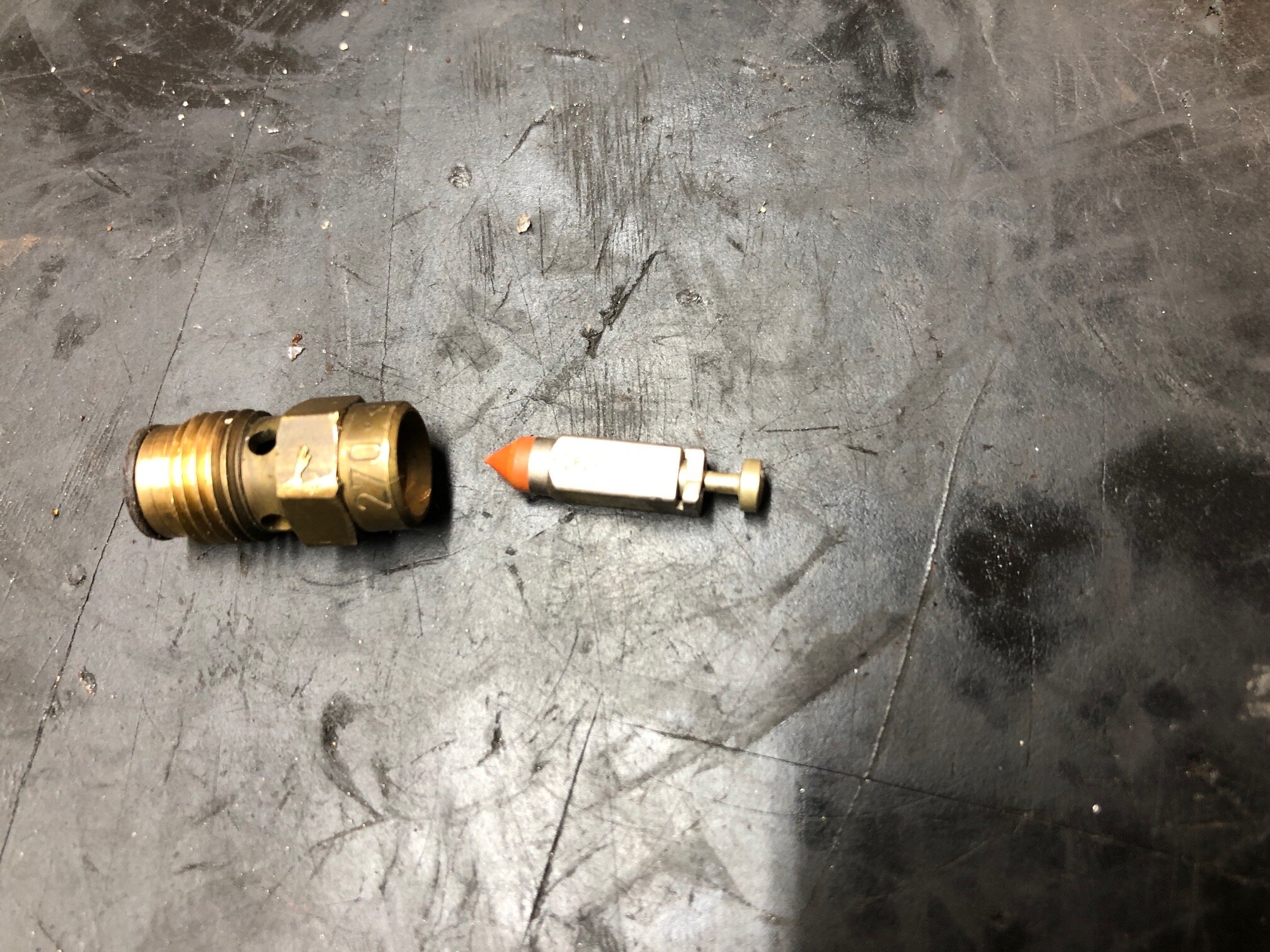

One thing I noticed though. I found a spare float valve and it's quite different than the one installed (I am attaching a picture of the spare one).
The one installed has a rubber tip and a "mushroom" end, for push/pull float arms (similar to this one https://www.partzilla.com/product/yamaha/3L5-14190-01-00), while the spare one (in picture) has a metal tip and a push-only end.
I haven't compared the two side by side, but I suspect that the previous owner may have installed the rubber tip valve to prevent flooding and that the installed valve is a bit taller.
If so, the stock 18.5 mm adjustment of the float arm would be wrong and the float valve may close too early.

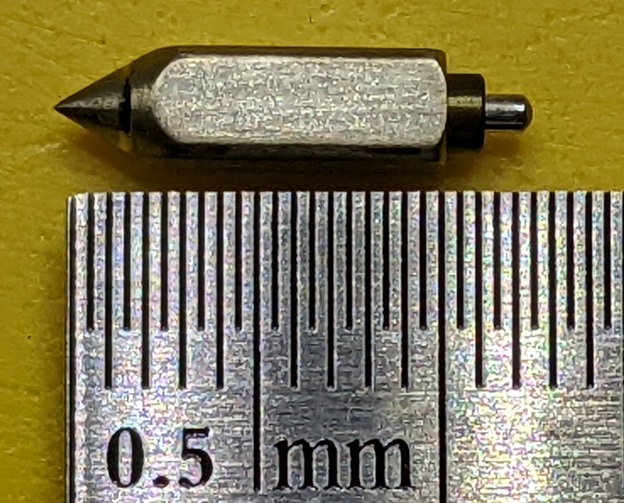

This is the float valve in the carb I have.  It is marked 270 on the brass part.
Thanks. I haven't checked the brass part, but the valve looks identical to the one in my carb.
