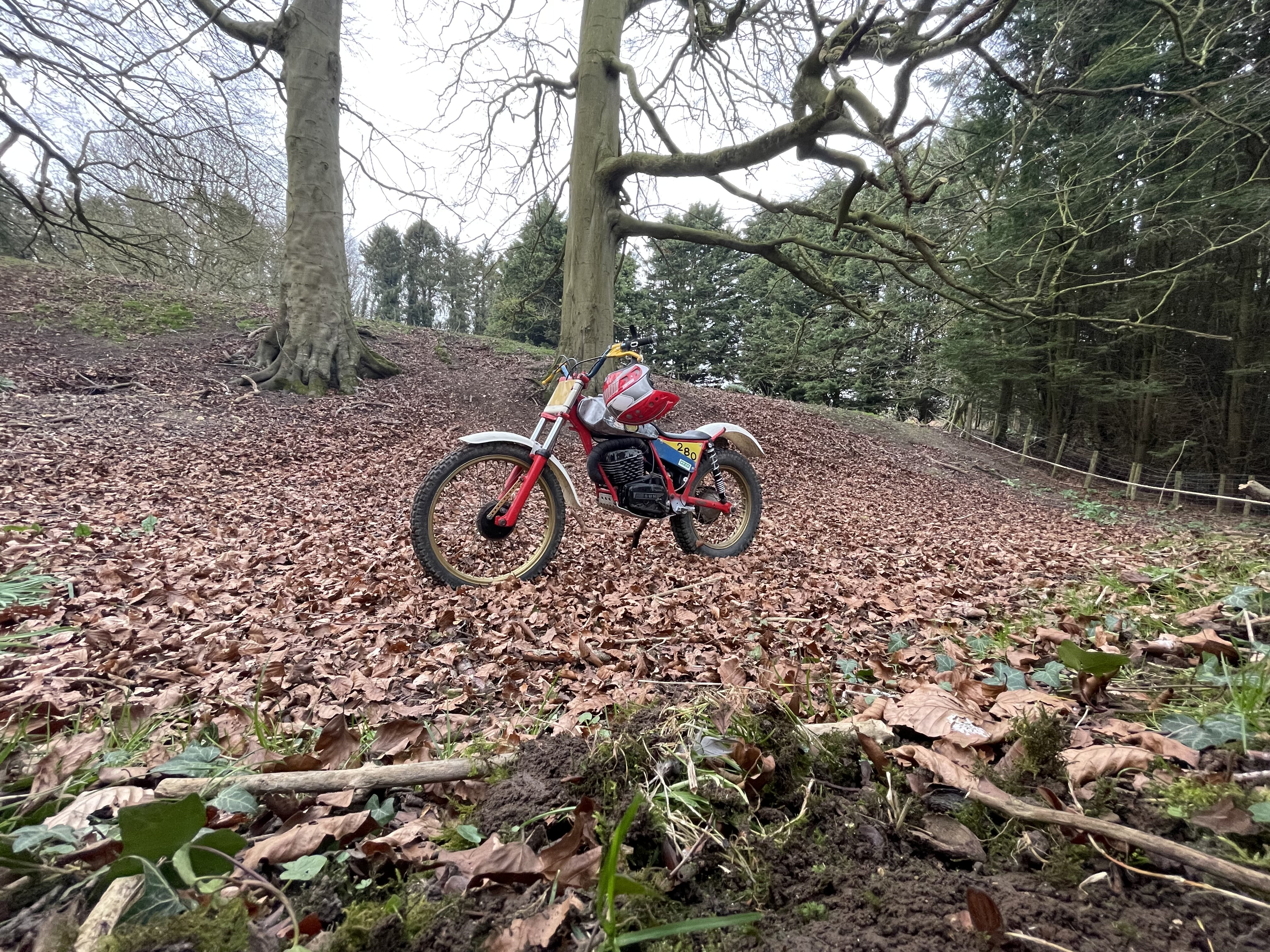

just though I’d introduce myself. my dads had this tucked away in a garage for the last 32years. After a couple of failed attempts to get it running in the mid 90s I though I’d have another go now technology is a bit better.
and here the bike is “finished” it’s meant to be a little ratty and rough around the edges. I don’t fancy turning up at some local trials events with a shiney new looking bike and being rubbish haha.
I went a little different on the tank

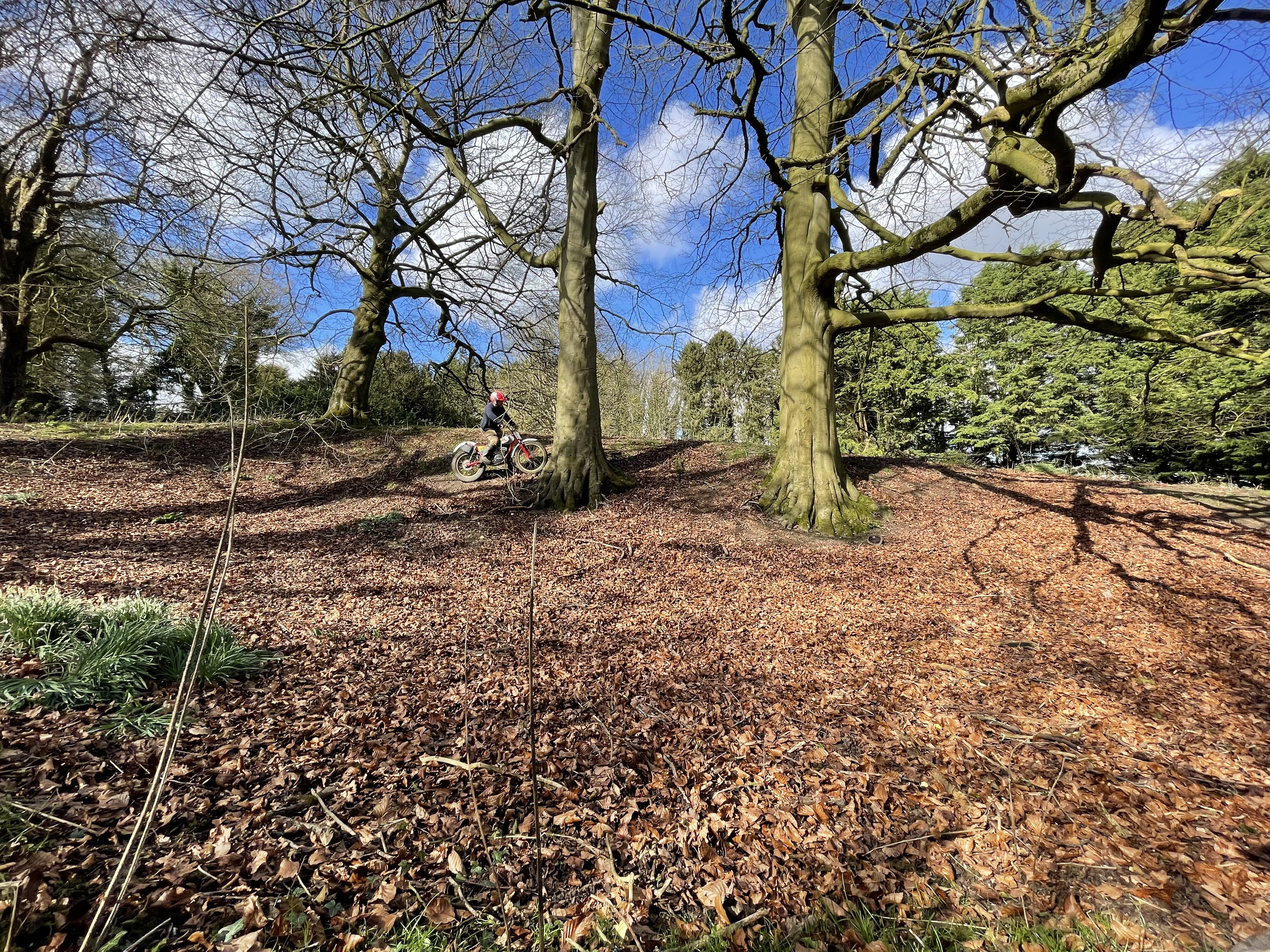

im lucky to have a little land to practice on and I’m living it!
