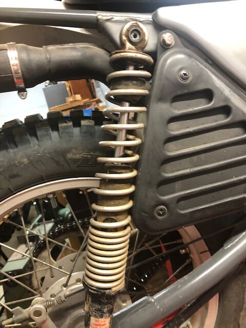

The Reflex shocks will not fit.  With stock shock mounts and stock spring diameter you would be lucky to get 10 mm longer shocks to fit.  The problem is that they hit the muffler.  I'm guessing that is the reason for the shock mount modification.
