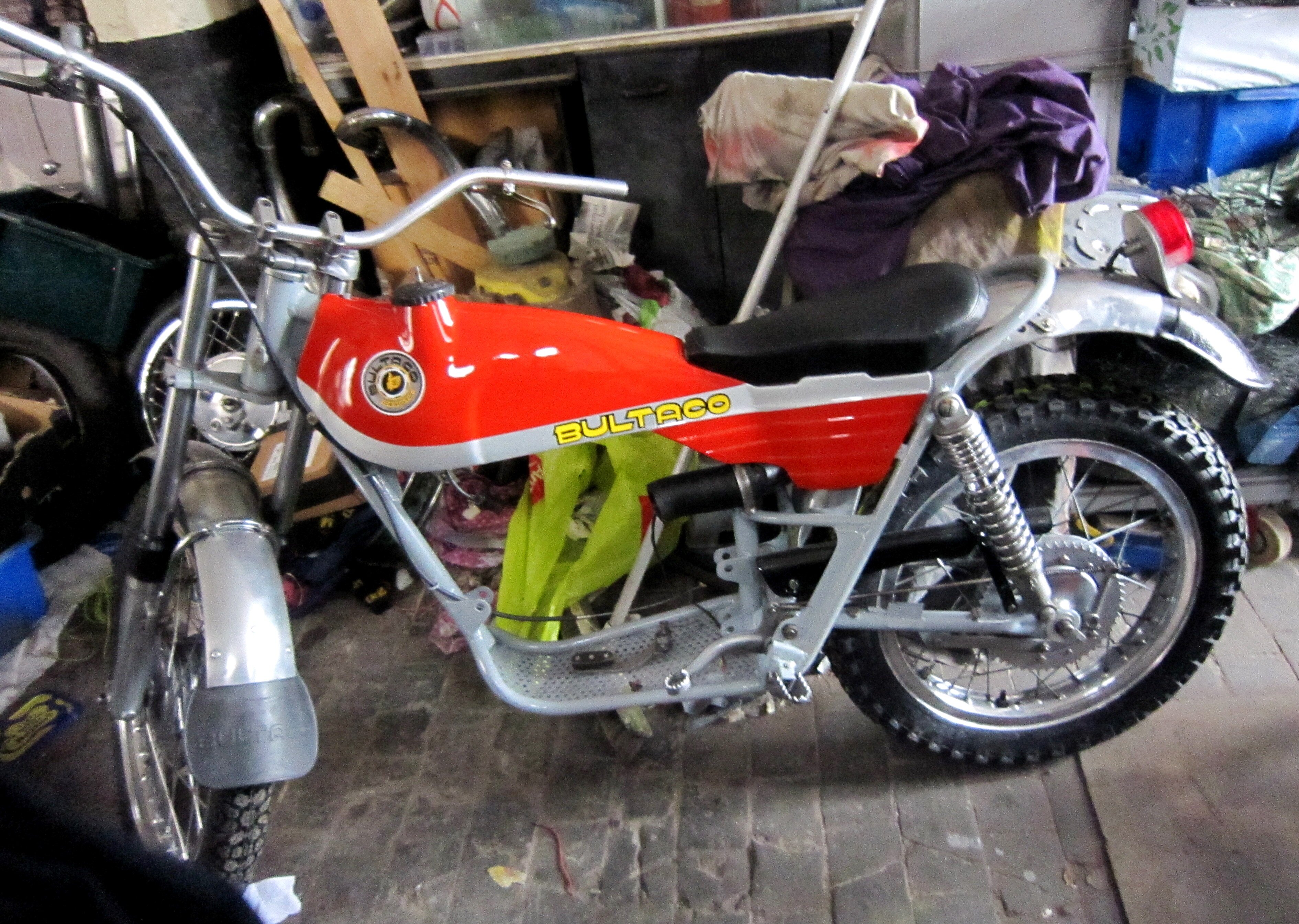

Hi all, well I have braved the cold and done a little more, mainly the tank and seat unit. Here is what she looks like now.

With pukka aluminium mudguards too. Complete with authentic wrinkles behind the rear frame loop!
