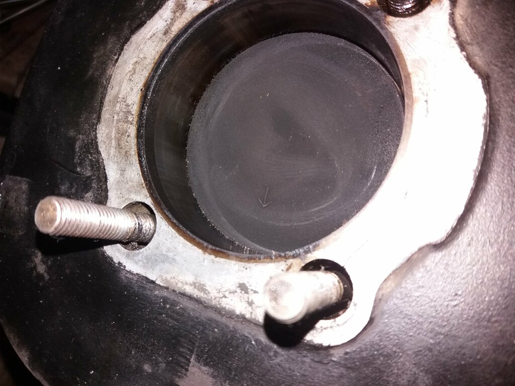

Hi please find photos of the barrel.
I have already had the rebore and it is out to 67mm.
I'm not sure what that would make it cc wise
A standard TY175 motor is 66 mm bore and 50 mm stroke which is 171cc swept volume.
Your cylinder at 67 mm bore and 50 mm stroke has 177cc swept volume.
After seeing your photo (showing 8 mm studs a lot longer than standard studs), I suspect that your crankcase cylinder mouth was earlier enlarged to match a bigger cylinder sleeve to allow the cylinder to have a bore somewhere in the range 70 mm to 72.5 mm and that "200cc" cylinder was later replaced with the standard cylinder that you are showing. If this is the case then it would be interesting to know if there has been something done to match the diameter of the standard cylinder sleeve with the enlarged crankcase cylinder mouth.
