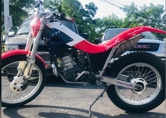

Avoid buying an obscure bike. I was eyeing this 90's Fantic near me because it is clean, very low $ and approriate for the basic plonking I do but research revealed parts availablity is almost nil. I then bought a '10 EVO and although it is considered ancient (as far as EVO's go) I'm very happy with it.
