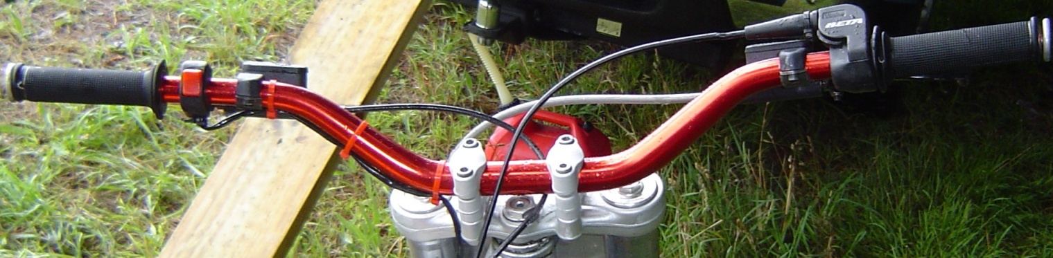

From the look of it they are just standard tapered bars. Beta had them on their '98 Techno and Scorpa have them on the SY 2 strokes. Both come from Domino (I think) and would be better than Pro Tapers as they come in a trials bend. You do need different clamps for either. About the only problem with them is that because your front brake and clutch lever assemblies do not have a taper they always some a bit loose part way through the day. I have started taking my small set of allen keys with me to periodically tighten things up.
Heres a picture of mine anyway;

That's rather odd Wayne, as the taper generally ends just at the bend to the control surface....at least on any of the ones I've used (Hebo, ProTaper, Renthal, Tag). The control surface should be the same diameter all the way along. Perhaps the Domino ones are slightly different.
I only have very small fingers, so my brake and clutch levers are probably further inwards than a lot of people would use. But I need to be able to use the controls effectively so am sort of stuck with the problem as the taper only ends about 1/2" from the grips.
I'm sorry about the picture being so big, I had shrunk it down a fair bit and then got feed up with fiddling with it......
