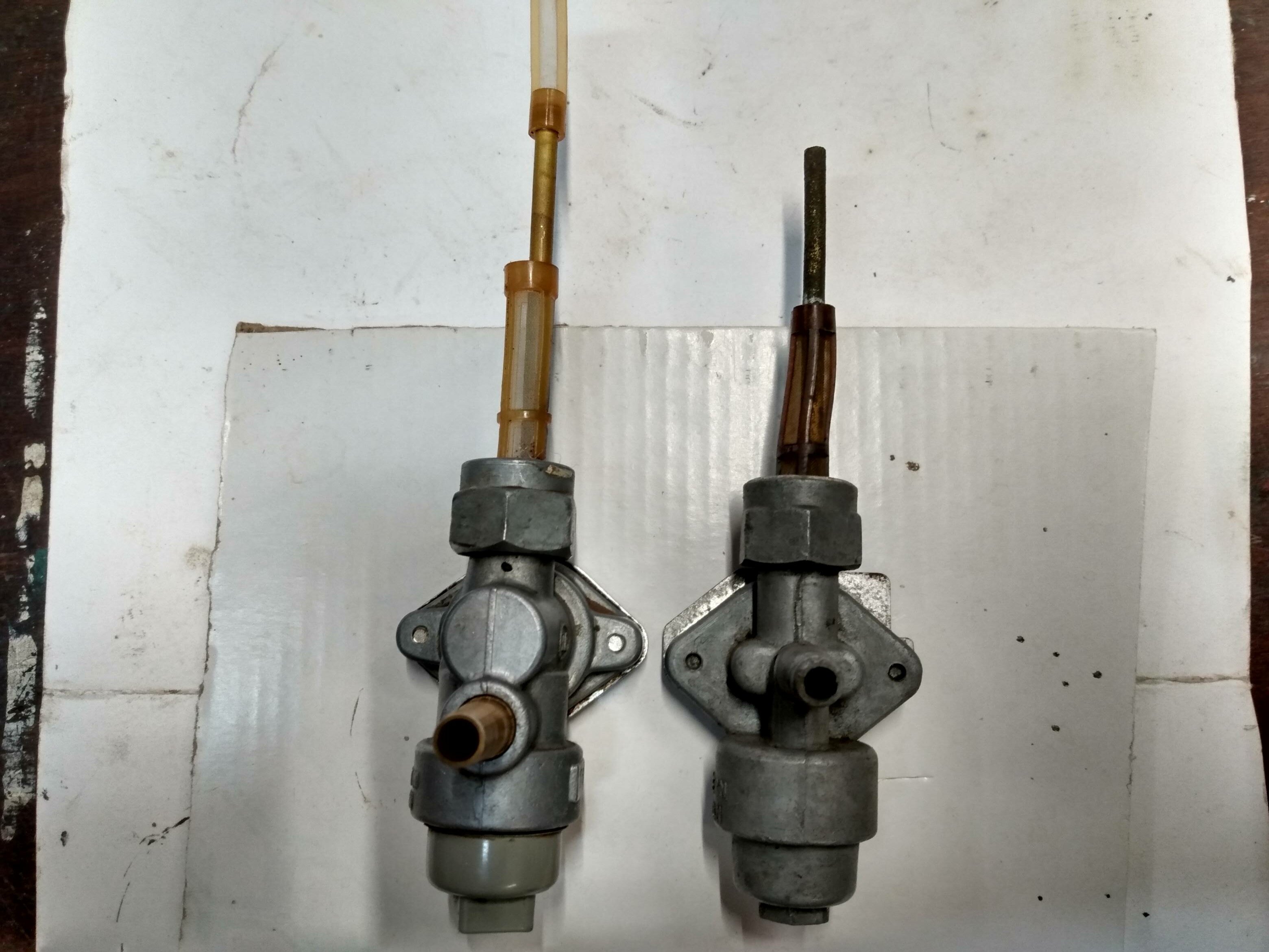

I'm going to try to download the pictures comparing the new vs. the OEM. The new is on the left and the OEM is on the right. This is looking at them from the backside. As you can hopefully see the outlet on the new one is lower than the OEM, and this is just enough to hit on the cable coming out of the carb top. That's why if a petcock had the exit to the right or the rear towards the rear wheel it would clear everything. I may have to further research metric threads.

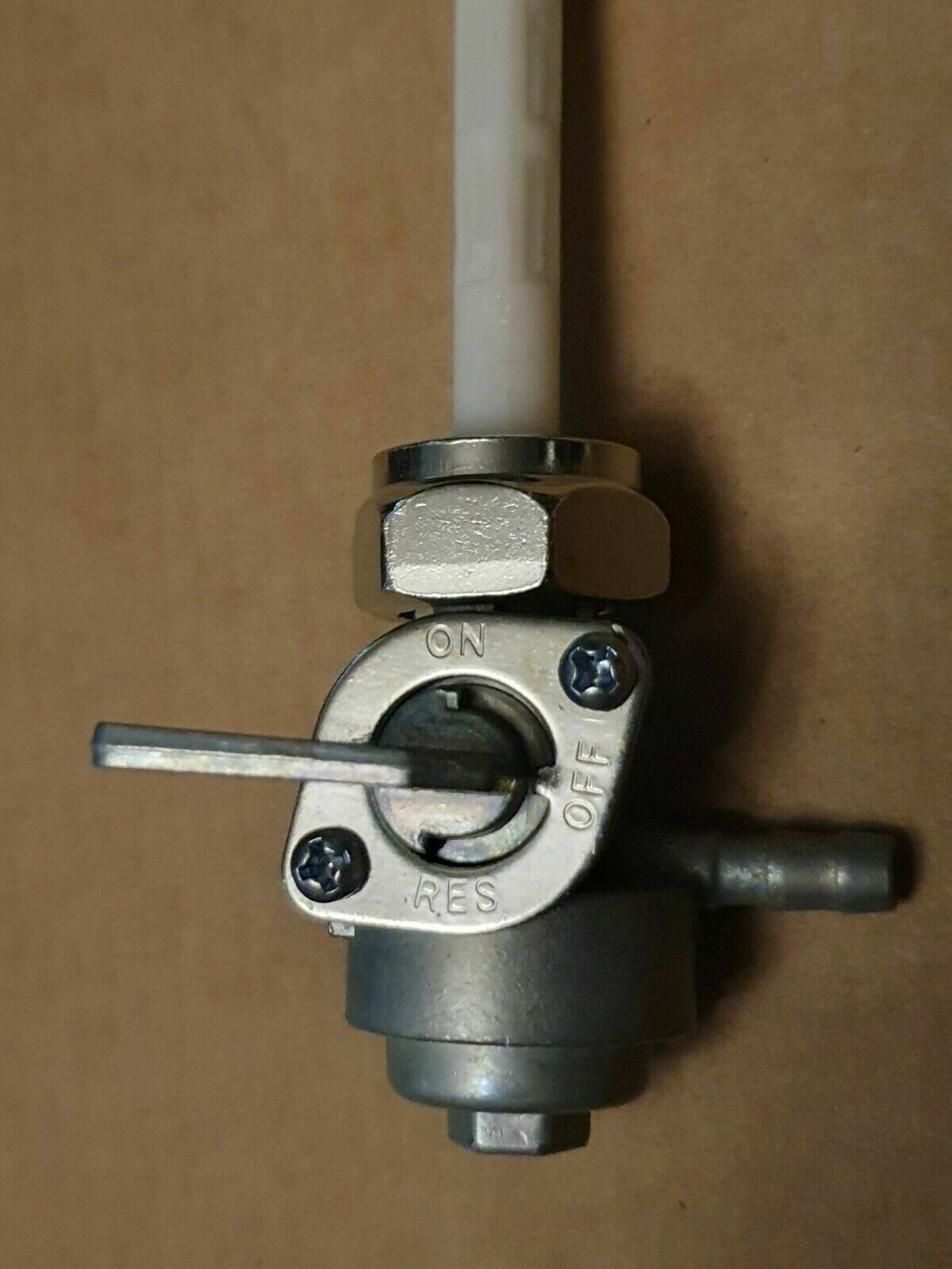

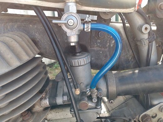

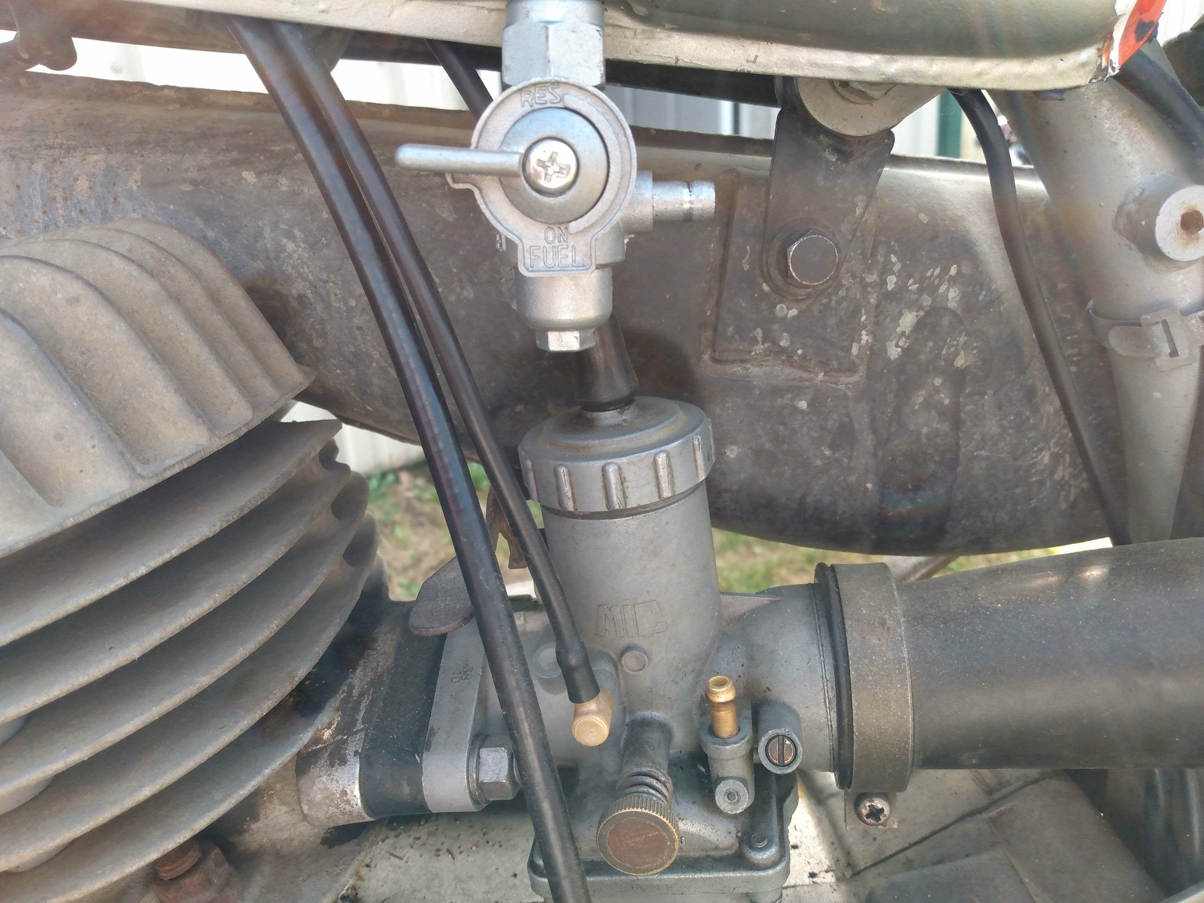

Well it has been a few days since my last post.  I have found a petcock that works and it is exactly the setup I was looking for. After an extensive search I came upon the website Dime City Cycles. After a couple of emails, Sam at customer support said they had a petcock and it was the correct thread, 14mm x1.5. When it arrived I thought I hit another brick wall. The thread was not 1.5, but something finer, perhaps 1.25 or even 1.0.  Fortunately I was able to remove the threaded collar from the new petcock and replace it with the original collar. The thread on the petcock body was the same as the original, and I was able to use the original Suzuki collar. I am having trouble resizing the second picture I have with gas line installed. I may try later, but here is the installed picture and we rode it yesterday without any leakage. I am satisfied with the results.
Lavern
Finally I got it small enough2045525080_4thResizedInstalledpetcock.jpg.4d5d2cf3aa925a630d2925d4a4e4efac.jpg
FYI the SKU# for this petcock is SKU: KL18-4170.  When I ordered mine it was the last one they had, and after just checking the SKU on their site it shows no results. I don't know if they'll be getting any more in stock.  I see that Dark Horse Motorcycle parts has it listed as a  FUEL PETCOCK - YAMAHA DT100 77–83 .  Maybe Partzilla or other OEM suppliers may have this.
LaVern
