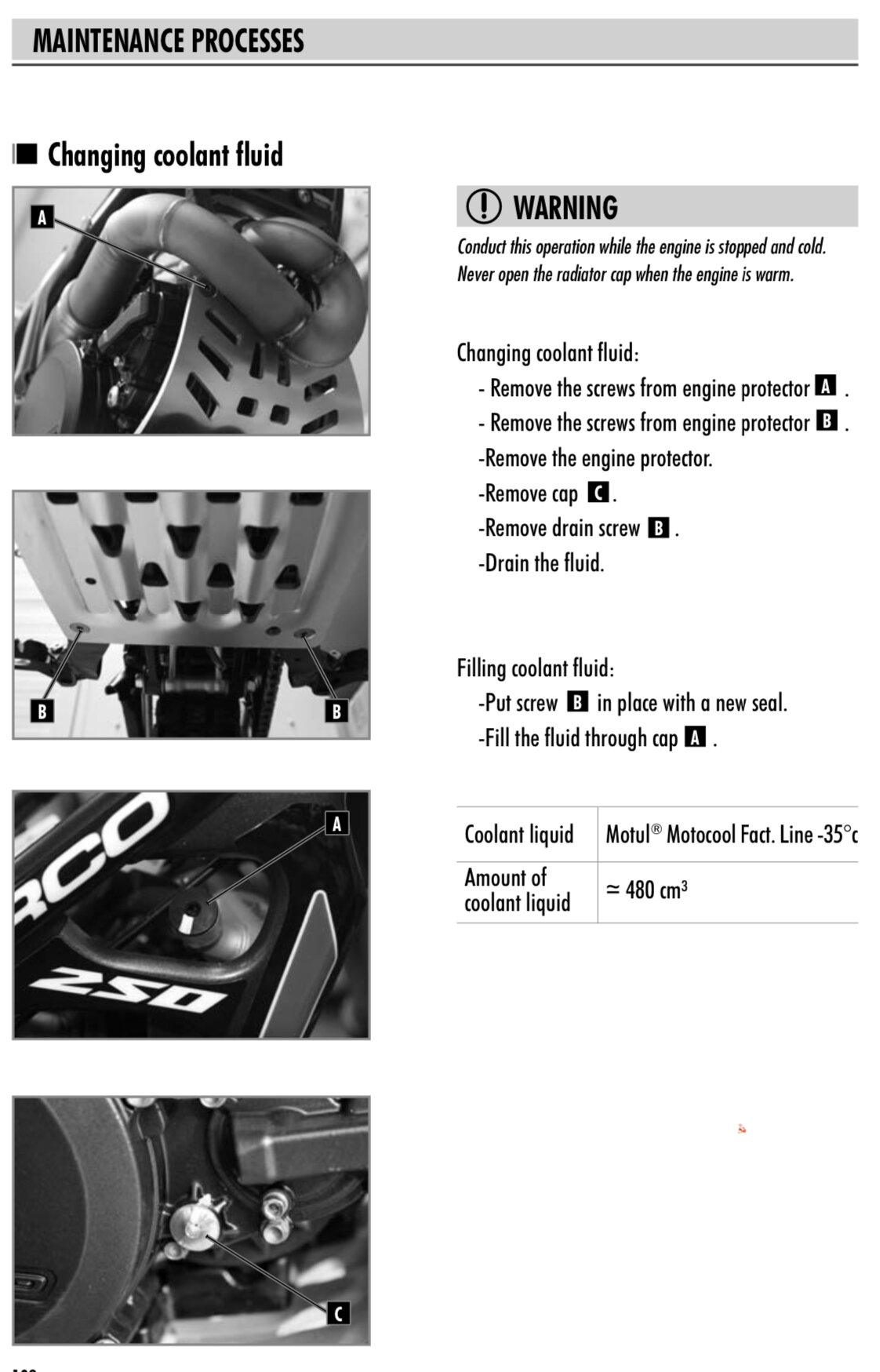

October 29, 20233 yr I have a 2019 250, which had a small coolant leak, hopefully just the bleed screw washer on the pump cover, it’s the first newer Sherco I’ve had so I’m not totally familiar with them, the info online is quite scant about the rad top up and bleed, the manual has the bleed screw and oil top up as the same thing I think, can someone confirm it’s wrong please? Also is the top up procedure as simple as fill rad oped bleed screw on cover nip to 10nm re top up, is there an overflow for expansion? Edited October 29, 20233 yr by godzilla

October 30, 20233 yr This manual page can't be more wrong No need to remove bash plate Cap C is for gearbox oil. Bolt you need remove is M5 bolt (allen 4) on pump cover
October 30, 20233 yr Author 4 hours ago, cascao said: This manual page can't be more wrong No need to remove bash plate Cap C is for gearbox oil. Bolt you need remove is M5 bolt (allen 4) on pump cover Thanks for the reply’s, I won’t even be removing the bash plate the change the oil let alone the water. I’m surprised Sherco hasn’t corrected it. https://www.sherco.com/wp-content/uploads/SHERCO-MANUEL-TRIAL-ST-Serie-125-250-300-2022.pdf
