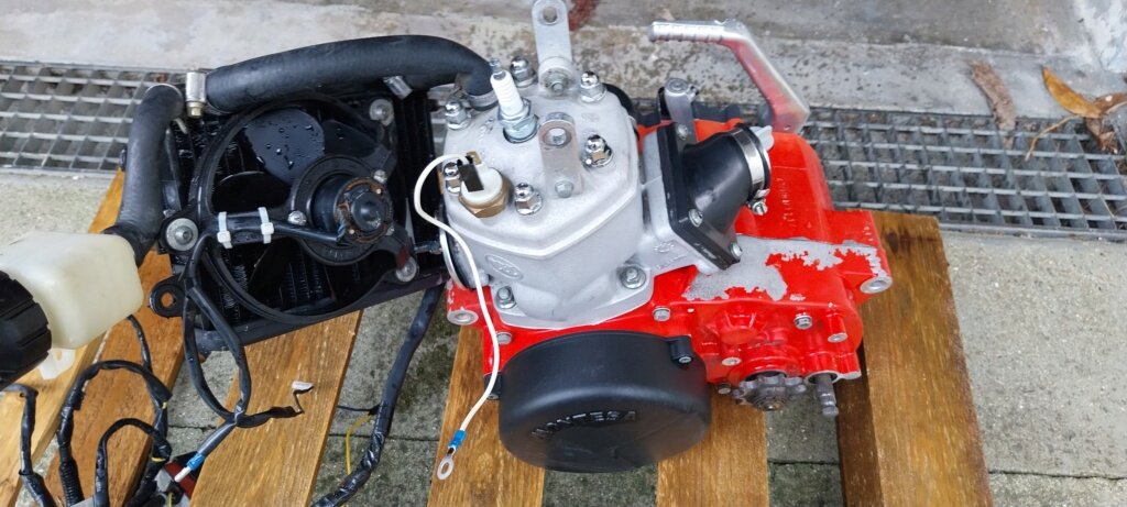

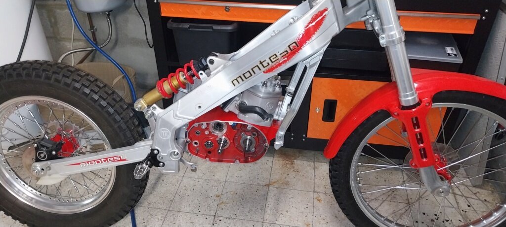

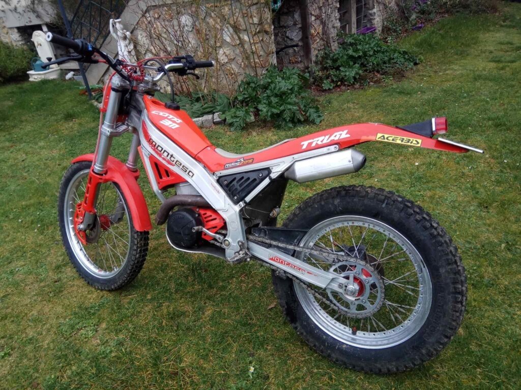

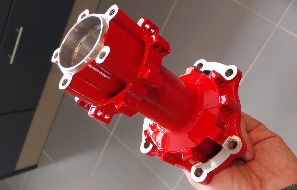

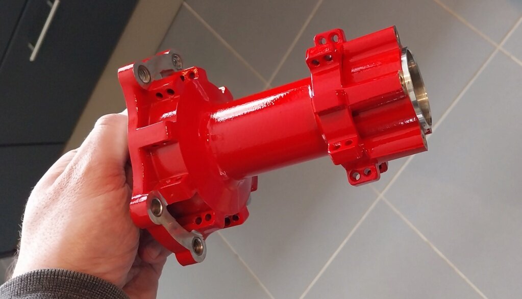

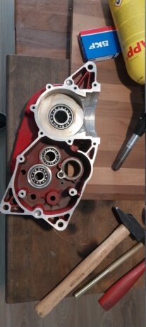

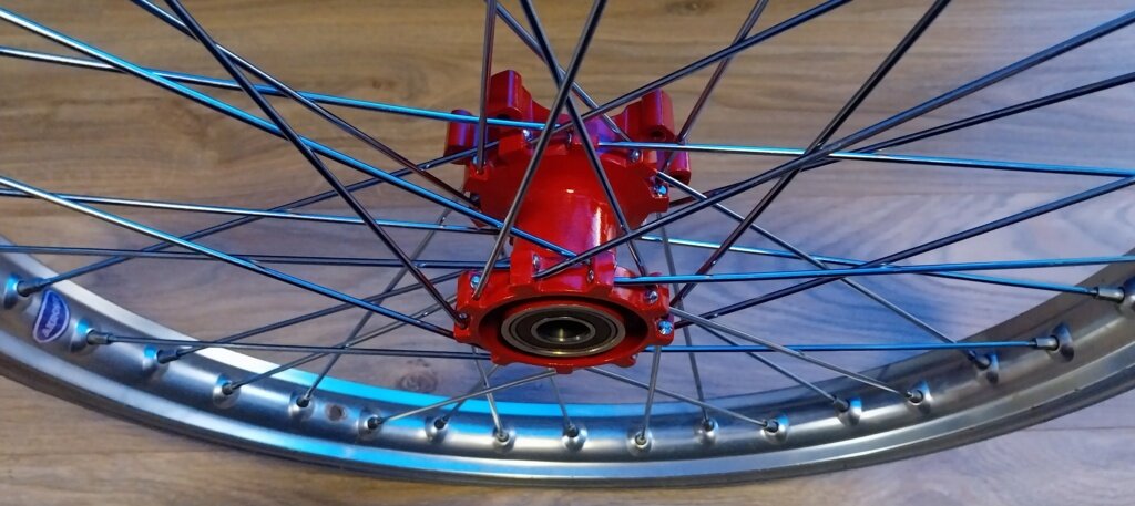

ahell Posted February 22, 2024 Share Posted February 22, 2024 (edited) I found this bike 2 years ago. I like big alloy frame bikes and the 311 is an interesting model. Not a design masterpiece , not fashion bike, but cool. The bike is in good condition. Let start by the wheels. Cleaning everything, paint job, new bearings (I love working on wheels) I have a brand new platics set. The engine need paint job (main bearings, seals, maybe piston will be replaced) Marzocchi shock need full service. Every rubber parts will be replaced as usual on +20yo bikes ... (carburator, fork, hose, seals, grips, tyres... ) Calipers and master cylinder will be restored. I hope you enjoy Alain from France. Edited December 11, 2025 by ahell 6 1 Quote Link to comment Share on other sites More sharing options...

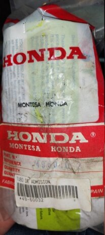

ahell Posted February 28, 2024 Author Share Posted February 28, 2024 I replace all synthetic parts wherever possible on all motorcycles I restore. I couldn't find an intake pipe. It's done. The same goes for the clutch cable and the exhaust pot heat shield. Ideally, I would find a silencer. Otherwise, I will do the repairs on mine. 1 Quote Link to comment Share on other sites More sharing options...

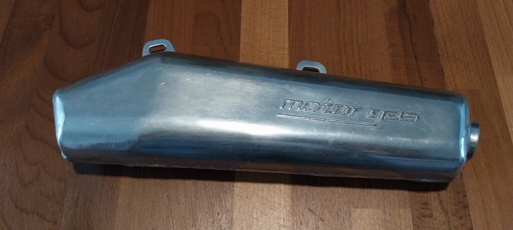

ahell Posted March 6, 2024 Author Share Posted March 6, 2024 (edited) Nice silencer not OEM but pretty cool. Edited March 6, 2024 by ahell 1 Quote Link to comment Share on other sites More sharing options...

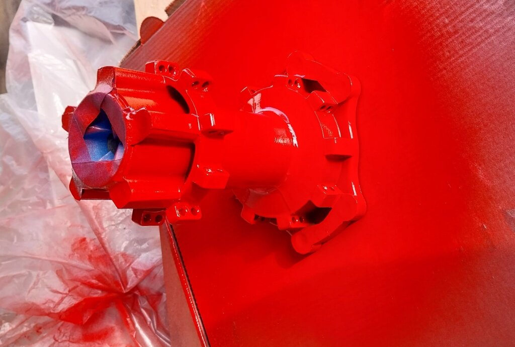

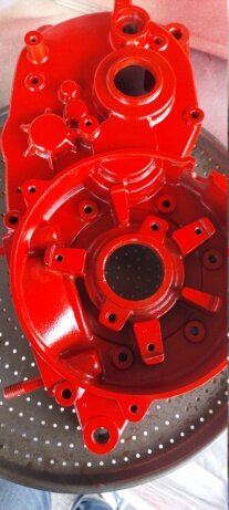

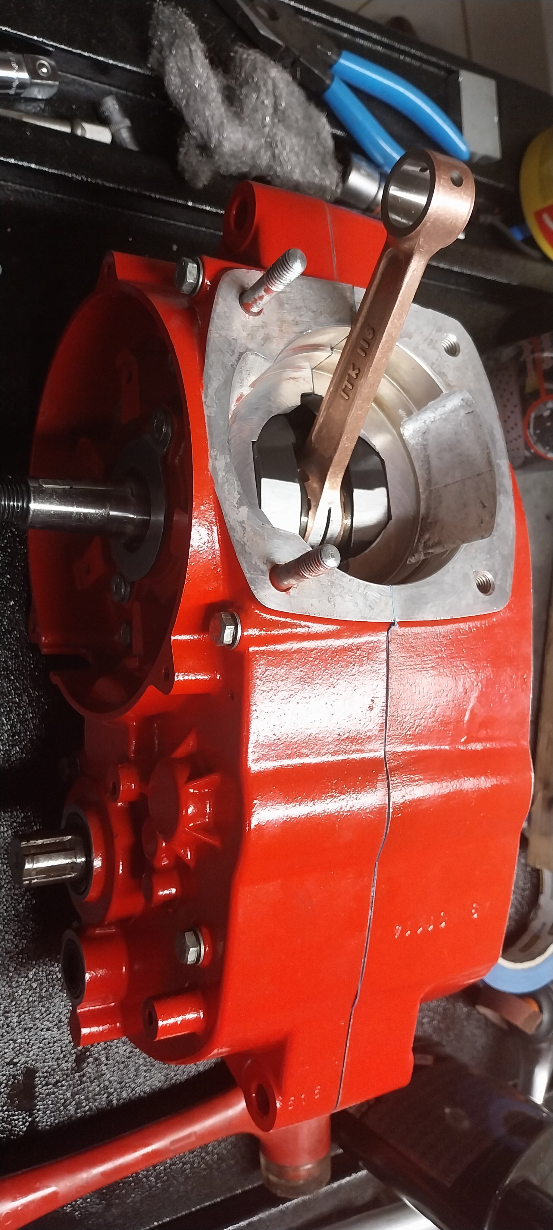

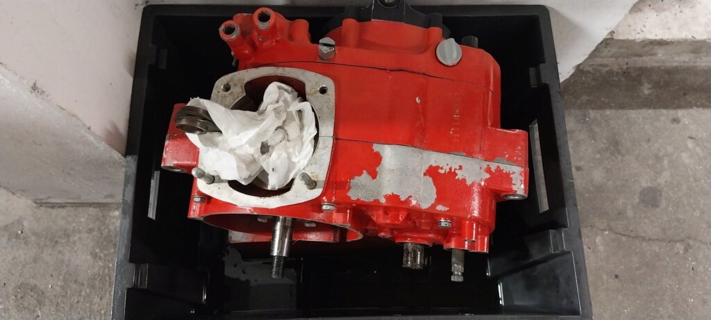

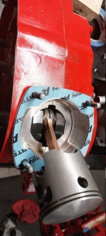

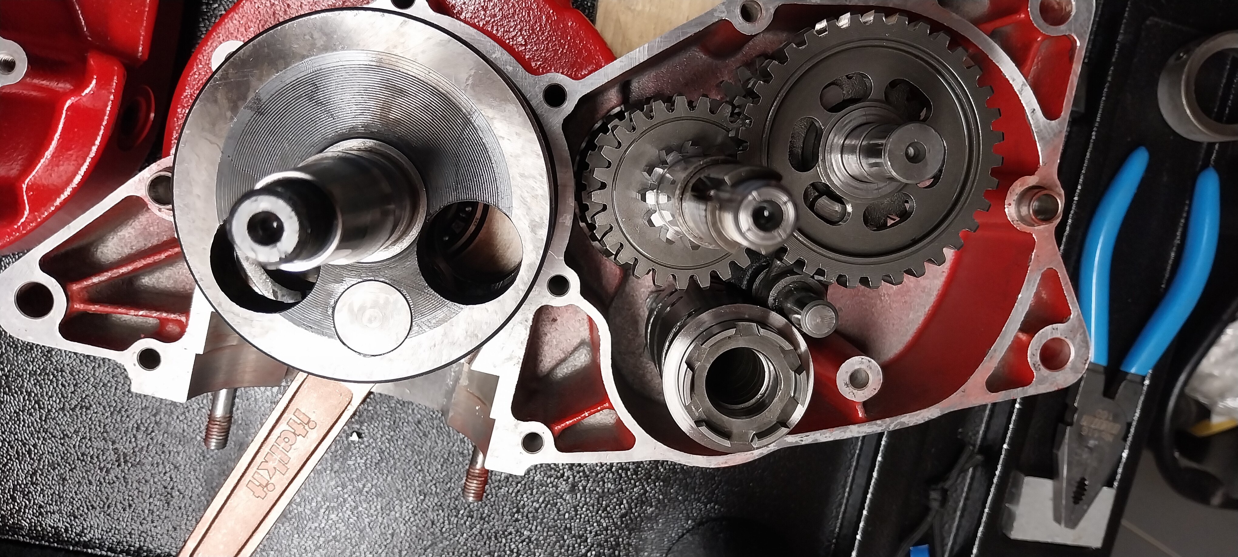

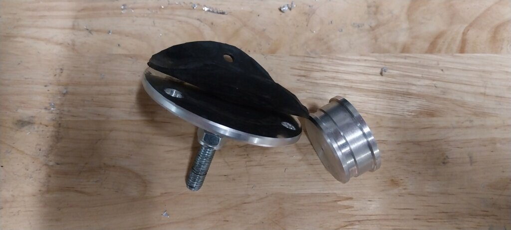

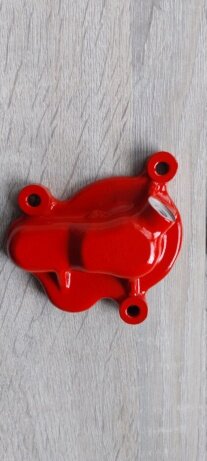

ahell Posted April 11, 2024 Author Share Posted April 11, 2024 (edited) I made a pair of intake & exhaust caps. (I don't regret buying a lathe) Washing in an auto center. I insisted on the painting which was going away. (I'm going to repaint all that) Back home, drying. Disassembly with no other surprise than 2 cylinder studs in love with their nuts. The cranckshaft is beautiful. No rust from what I saw. The connecting rod looks good. The ignition housing is well ventilated. No rust at all. Just dust. Edited April 14, 2024 by ahell 1 Quote Link to comment Share on other sites More sharing options...

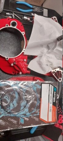

ahell Posted April 17, 2024 Author Share Posted April 17, 2024 Next order: Engine bearings Dellorto gasket kit Quote Link to comment Share on other sites More sharing options...

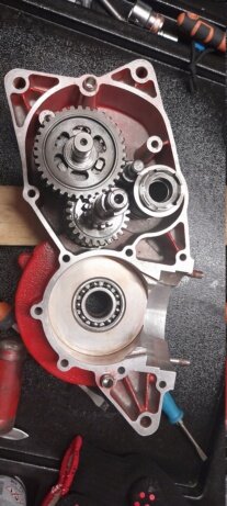

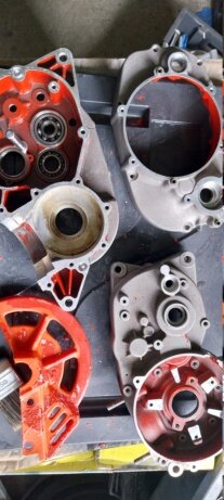

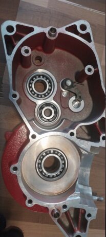

ahell Posted May 2, 2024 Author Share Posted May 2, 2024 All new brearings and seals. 1 Quote Link to comment Share on other sites More sharing options...

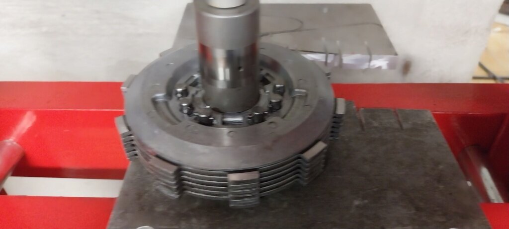

ahell Posted May 4, 2024 Author Share Posted May 4, 2024 I'm waiting a new conrod to finish the engine. All new bearings, seals, original piston Gilardoni, original new cylinder, new rings, new clutch ... all new engine ! 🥰 Quote Link to comment Share on other sites More sharing options...

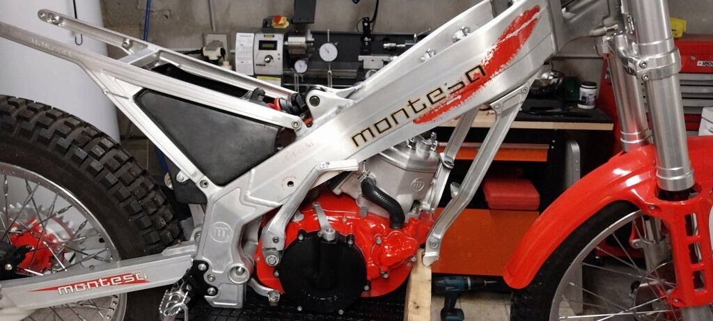

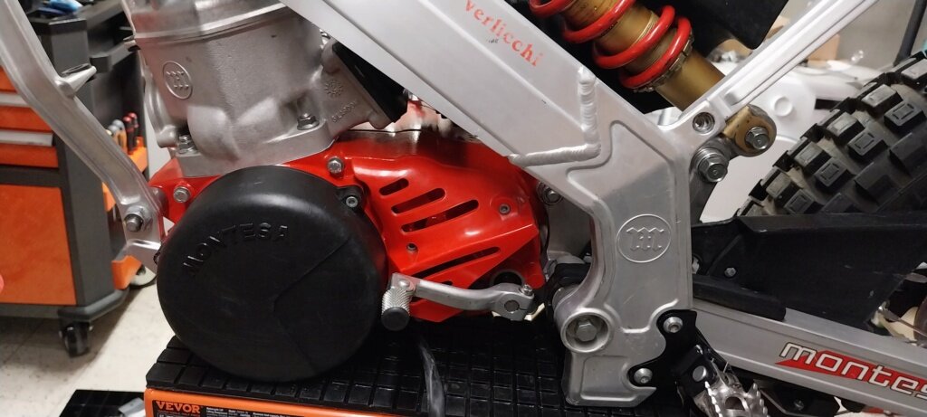

ahell Posted May 15, 2024 Author Share Posted May 15, 2024 Today, Piston, rings, cylinder, clutch, selector, clutch arm, carburetor gaskets, spark plug, intake pipe, valve box, cylinder head, air box rubber, rear frame: new original! Used air box in good condition. I ordered clutch and throttle cables. It feels good to be moving forward, but I still have work to do. It took me quite a while to gather the parts for this machine. When I compare it to the TYZ, there is a world between the two. The Yamaha was much more modern in design and manufacturing. This 311 was really the “before” Honda engine. Quote Link to comment Share on other sites More sharing options...
tommybuildsbikes Posted August 30, 2025 Share Posted August 30, 2025 Hey man this looks great i’m about to start a project of my own, do you happen to have a photo of the exhaust and airbox as i don’t have one and can’t find any online so hoping to source one similar Quote Link to comment Share on other sites More sharing options...
