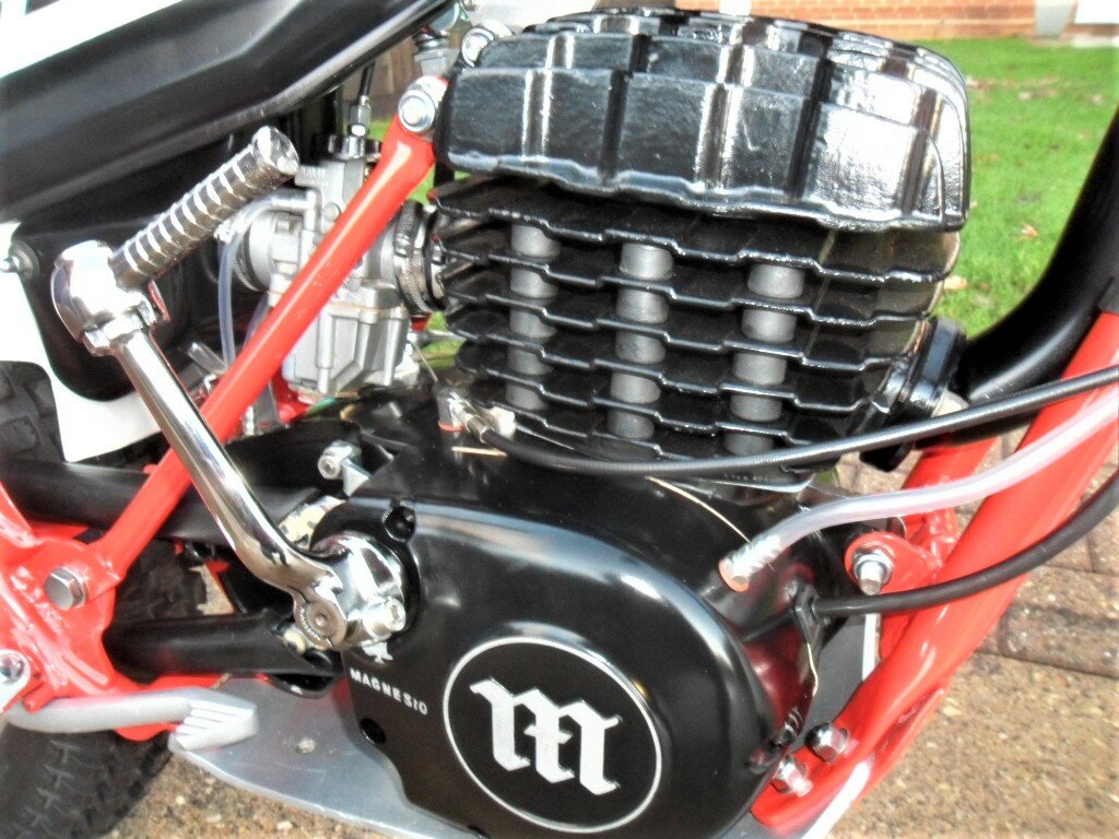

I think that the cover you describe will fit the earlier 247 models.
My 1982 248 looks like this on the drive side
Thank you for our reply. Unfortunately your photograph show the correct type of timing cover. My cover is the whole length of the right hand crankcase, covering the drive sprocket. I  think a photograph of mine  would be an advantage to identify it
Thank you,
Peter Lee (Cornwall)
You may have a 348 cover on your bike that has been cut down as they are the same dimensions...
