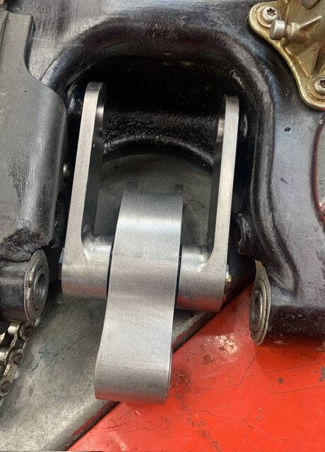

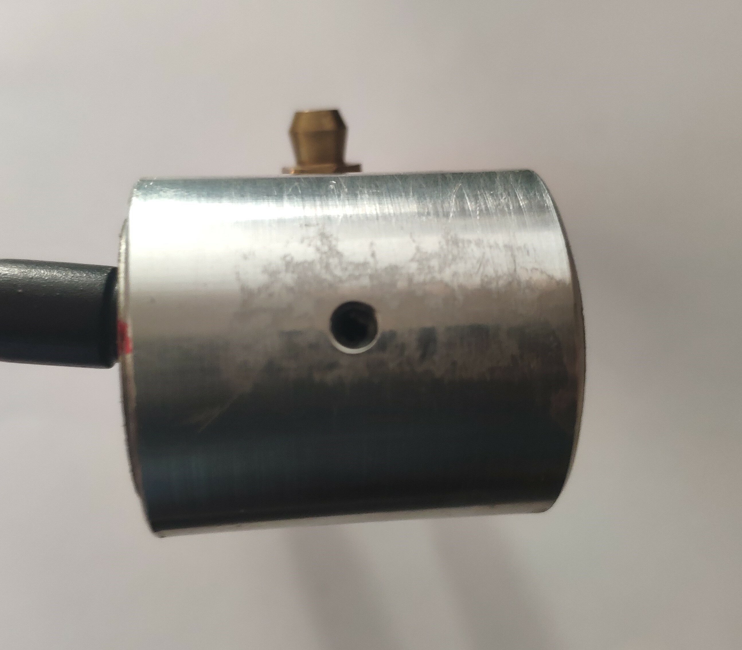

 The grease fittings are there- I used flush ones that use a ‘needle’ type end. Three of them could have ‘regular’ zerk fittings, but the one for the main pin does not really have enough room.
Before I sell any, I want to make sure everything is just right. I have made some little mods.  I wanted to keep as thick as possible for strength, but also need to have clearance for the Ohlins or the Olle dampers since the springs are a bit different in size.

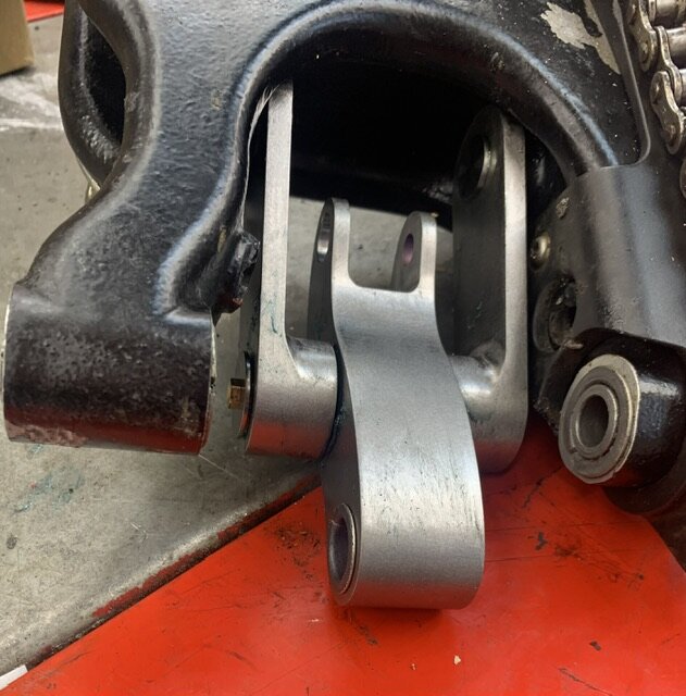

I have the slightly modified version installed. I very slightly changed some tolerances (the place making them follows better than I expected). And had to change the ‘dogbone’ to similar thickness to stock, although a bit taller. (Would not clear Olins).
I really like the almost flush grease fittings.  They work really well and easier to access. Just require a very inexpensive adapter.
Works great!

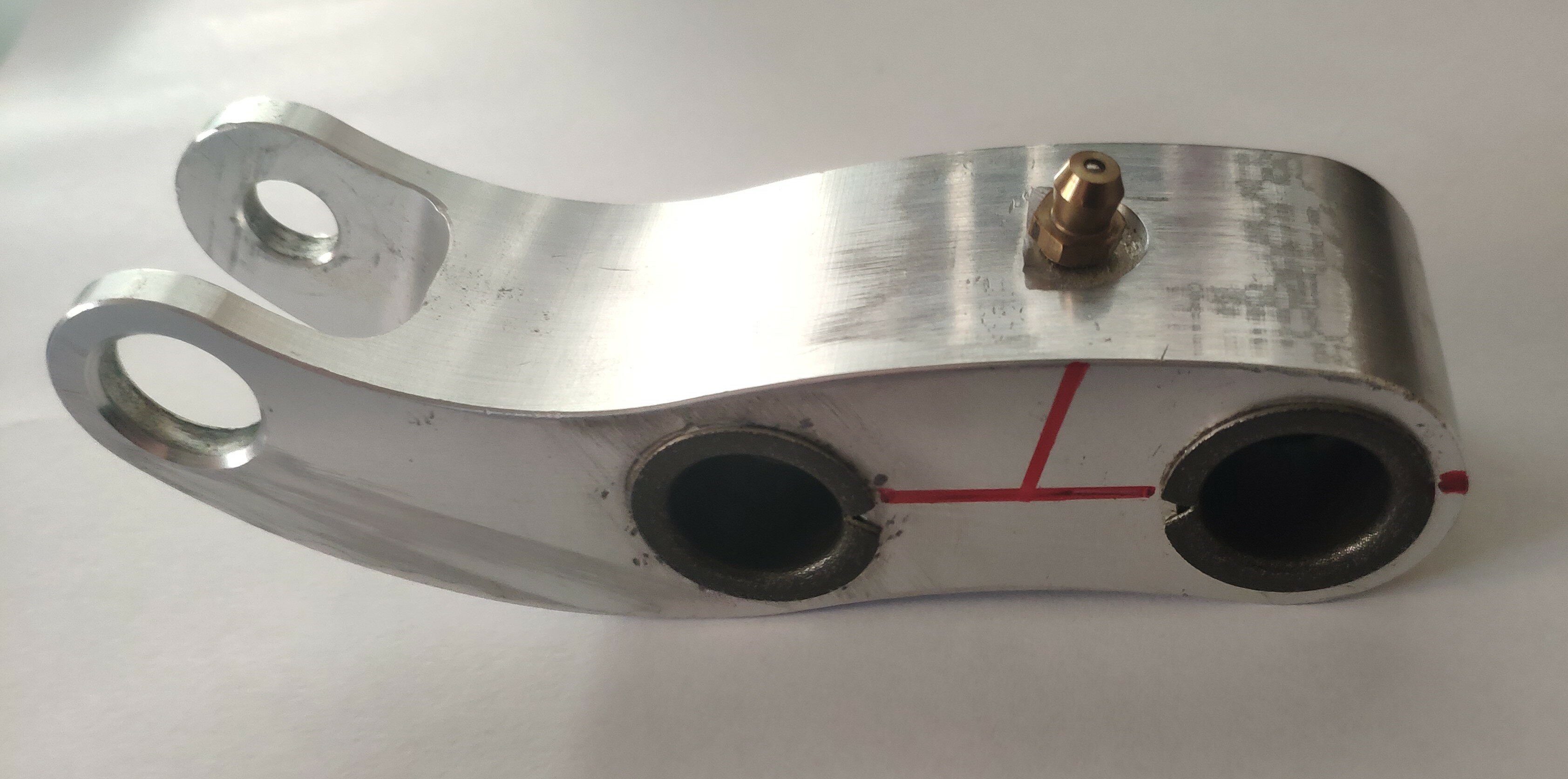

       This consisted of drilling the shocker linkage axially 2.5mm diameter (highlighted in red) from the very end through both the pin bores and tapping the end and fitting an m3 grubscrew with some pipe sealer to plug it off. This hole passes centrally between the four bushes in the linkage, this was then cross drilled into at an angle and the start of the hole squared off and tapped to suit a m6 grease nipple or zerk depending what side of the pond your from!This allowed both pins in the shocker link to be lubricated without any spanner work. A flexi hose on a grease gun and with a bit of practice and you could get quite perficient at locating the nipple on the link.( Hair around it comes to mind)😮

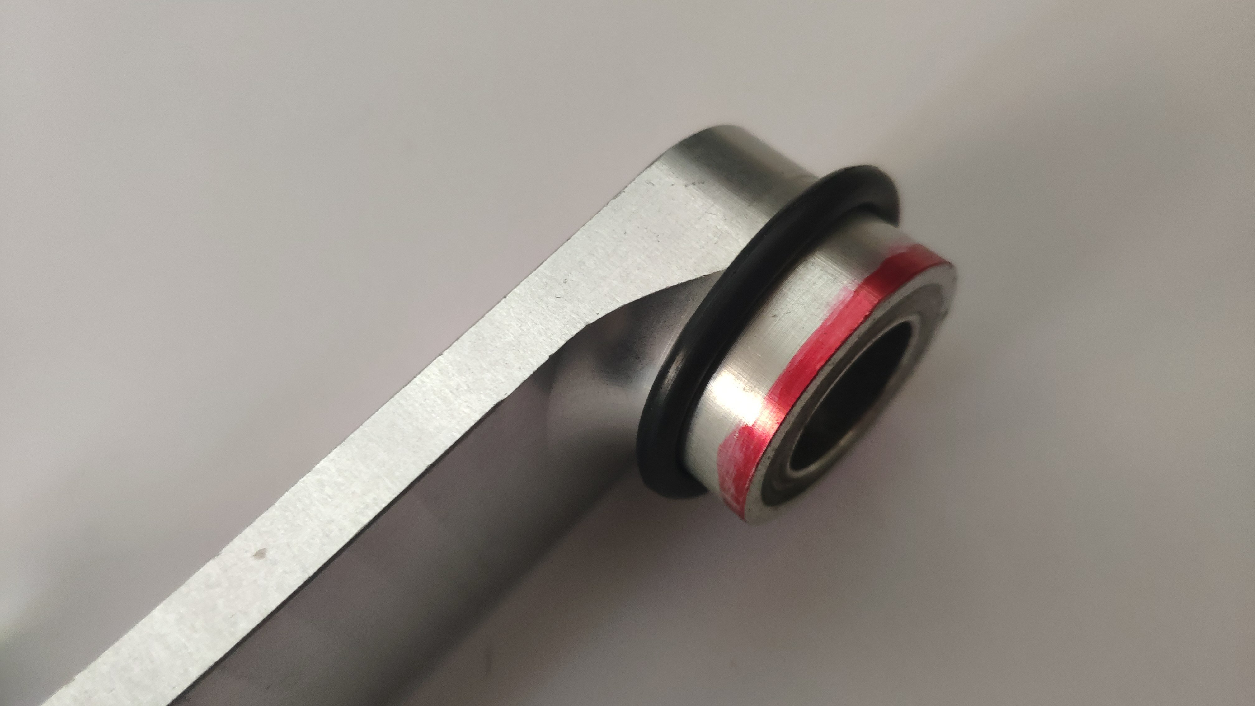

      I used to chamfer the two swing arm links as highlighted in red and fitted an o ring to each of them,this needs to be tight around the boss so it pulls into the chamfer and against the shocker link to keep the dirt and water out. The o ring in the photo is only for illustration purposes only as thats all i could find. Sorry I dont have  any potos of any modified ones. The link pins that went into the swinging arm were cross drilled and a slight grease groove ground on them. To lube them the m6 screws were removed and a m6 nipple (zerk) screwed in and a couple of shot of greased applied to to lube them and flush them out and the fitting removed and the original screw refitted
