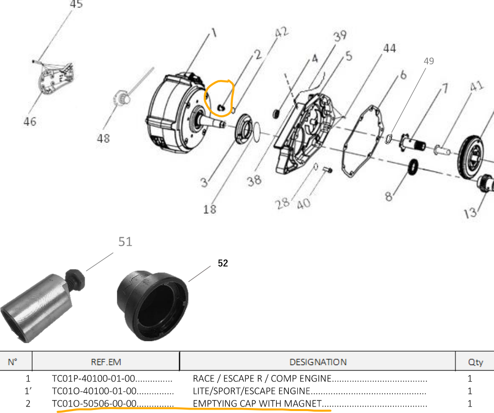

WIX-ONE Posted June 18, 2025 Author Report Share Posted June 18, 2025 12 minutes ago, motovita said: You mentioned an Allen head drain plug, maybe if you post a photo of that plug and it's location perhaps the mystery can be solved. Depending on the year and model of your bike you may not have a gearbox. It doesnt have a gearbox mate its an Epure Race 21 so its just the clutch The drain plug is this one I just want to know if i can get a generic one the same rather than having to get a specific one ordered in. Quote Link to comment Share on other sites More sharing options...
konrad Posted June 18, 2025 Report Share Posted June 18, 2025 On 6/7/2025 at 9:36 AM, WIX-ONE said: Also i need to replace the drain plug as the allen thread has rounded, can i get a generic one from anywhere (UK) and what size is it as the parts list doesnt state the size? Fill and drain bolts are both M12 x 1.5 1 Quote Link to comment Share on other sites More sharing options...

WIX-ONE Posted June 19, 2025 Author Report Share Posted June 19, 2025 12 hours ago, konrad said: Fill and drain bolts are both M12 x 1.5 Brill thanks mate Quote Link to comment Share on other sites More sharing options...
