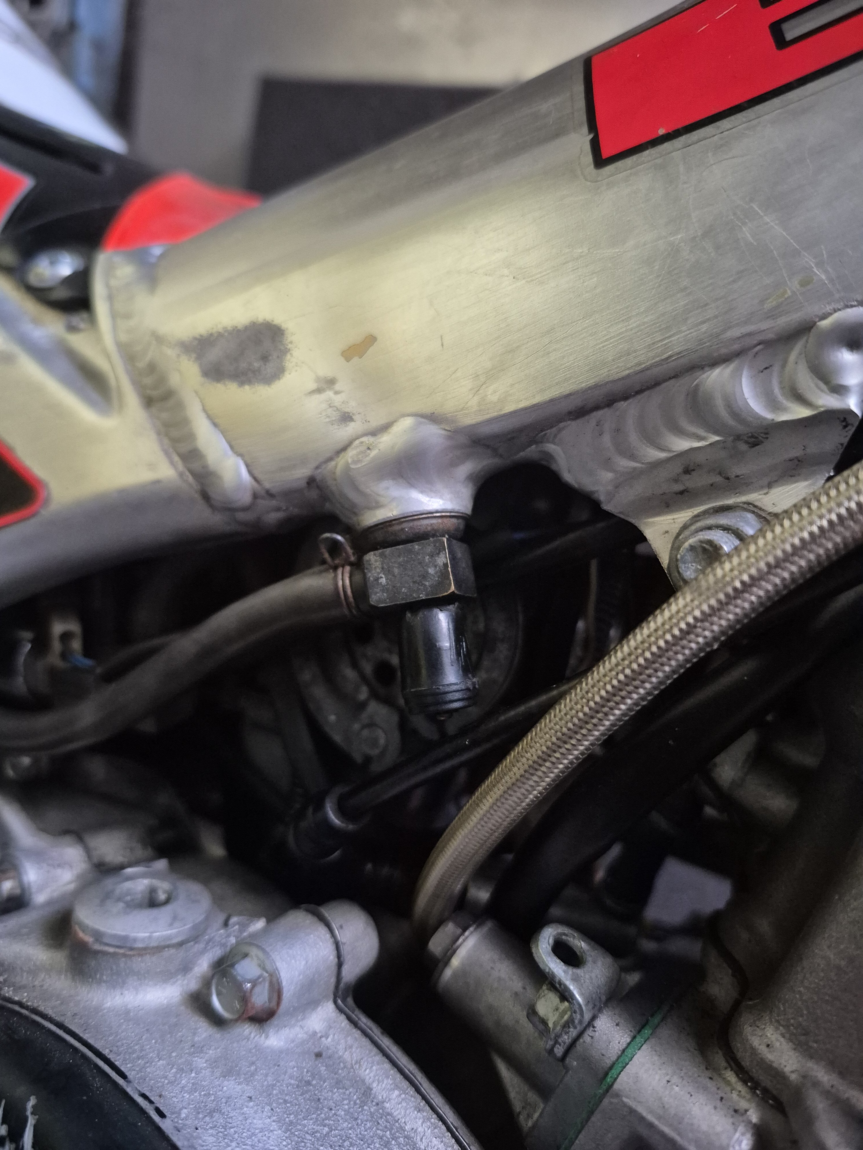

Noel09 Posted June 26, 2025 Author Report Share Posted June 26, 2025 Ah thanks. I'm going to do all fluids and filters before riding. Looking to rebuild clutch master as it's dragging and leaking at master! Fork seals are leaking and front wheel bearings are gone. Looks like petrol is weeping from somewhere under tank. That tap on the tank looks to be broken or different from the manual too. Loads of little bits to do. Thanks for help. Quote Link to comment Share on other sites More sharing options...
lemur Posted June 26, 2025 Report Share Posted June 26, 2025 Fuel tap on your bike is a little strange and over-engineered as a result of being fitted with a carburetor instead of fuel injection, Wheel bearings only last a year or three at best. Fork seals wear quickly if the slide bushings are not set perfect, note that when you get new aftermarket slide bushings you might need to do some careful hand file work on the parts to make them fit well, I clean and dry fit the bushings to inspect for clearance, fit or stiction and then finish the assemble. 1 Quote Link to comment Share on other sites More sharing options...
