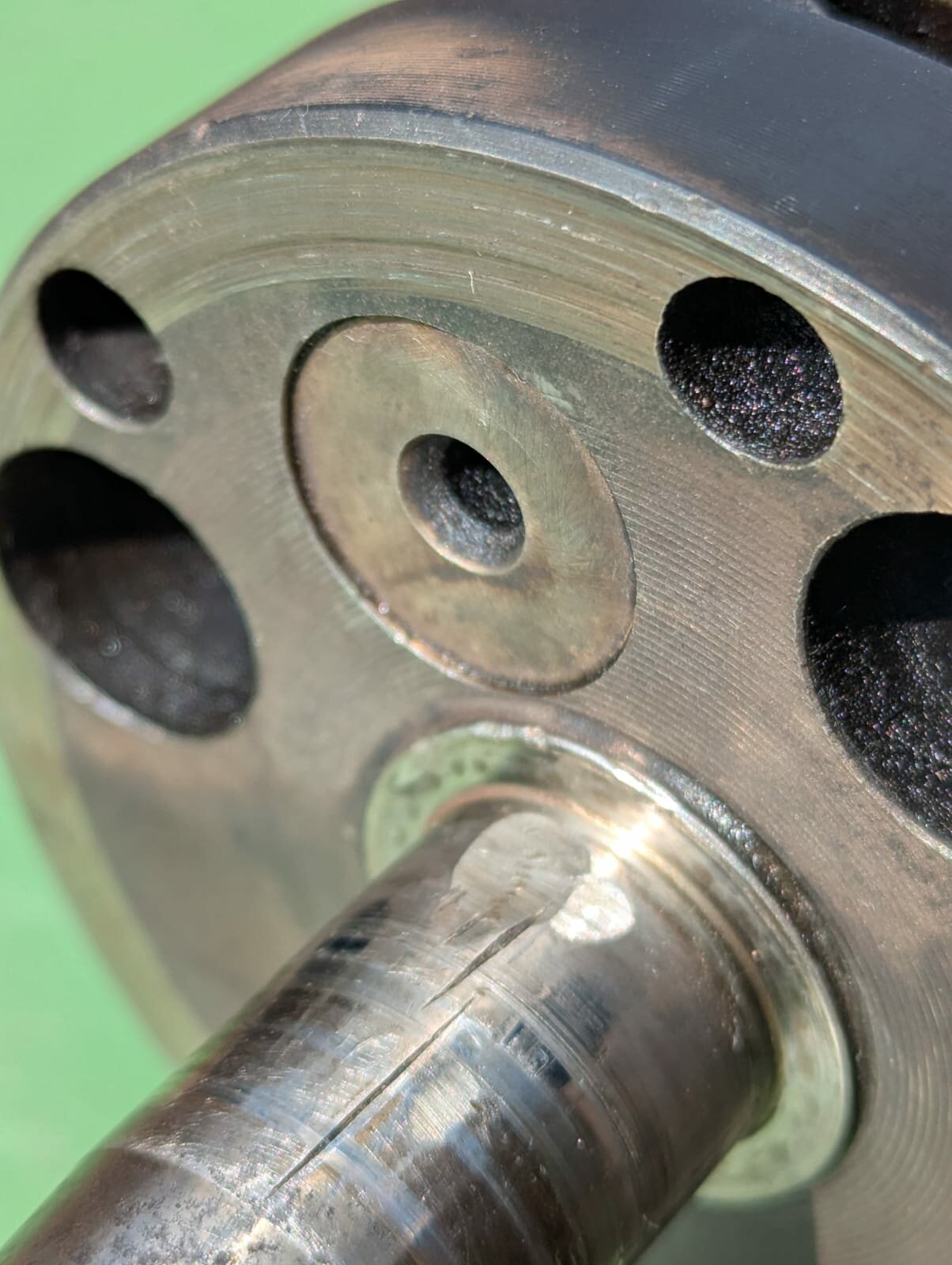

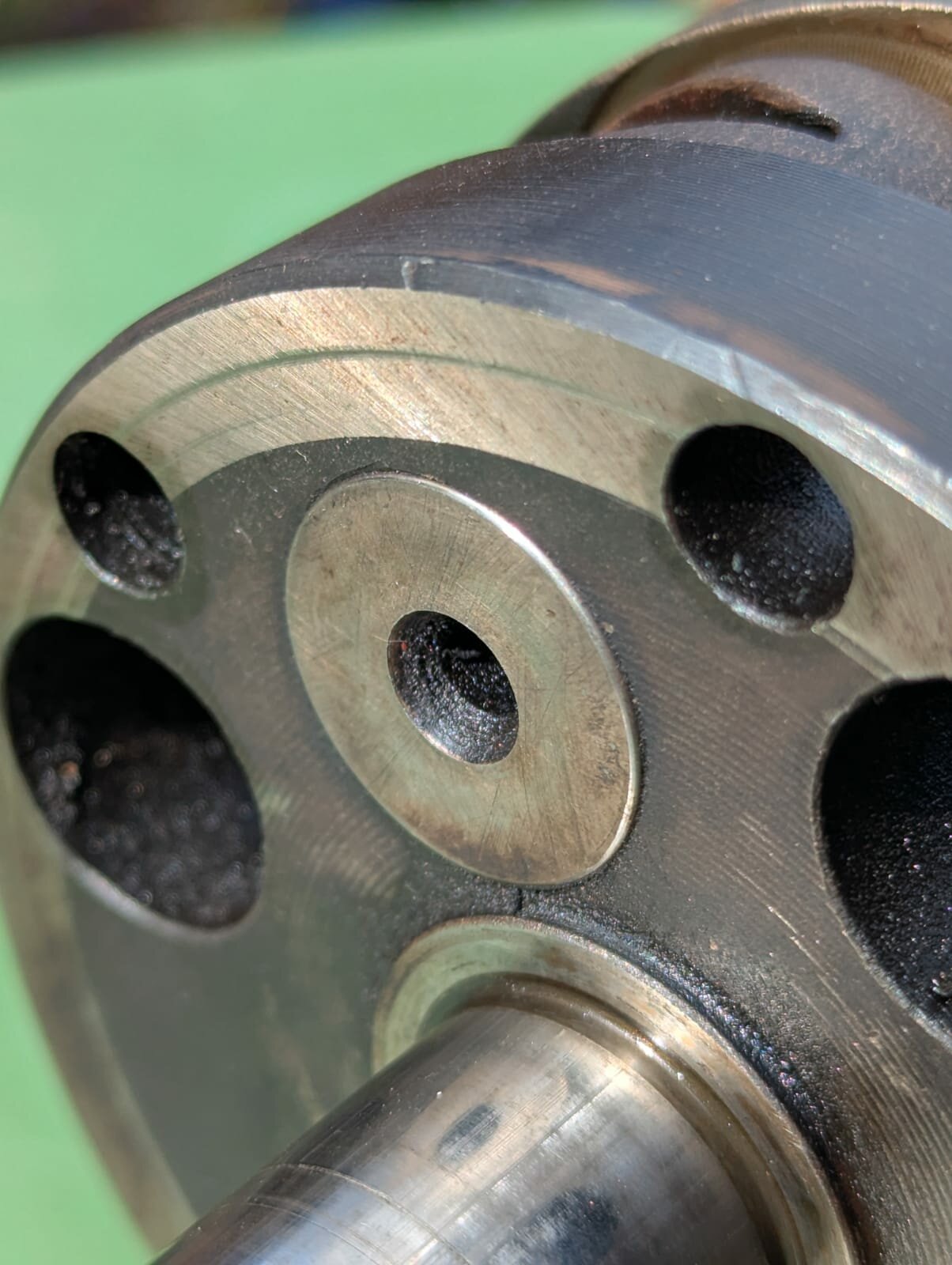

Slackdabber Posted September 4, 2025 Report Share Posted September 4, 2025 (edited) 199A Rebuild progressed smoothly....until, the slightest tightening of the engine bolts and the ignition side crank flywheel is binding on the LH Crankcase. Main bearings are where they should be and the crank belongs to this motor. Any thoughts/suggestions please? Also the crank pin isn't flush with the crank halves, on the LH side which is fouling, it is recessed, on the other half it is very slightly proud. Should it not be flush on both sides? Edited September 4, 2025 by Slackdabber Additional info Quote Link to comment Share on other sites More sharing options...

lineaway Posted September 5, 2025 Report Share Posted September 5, 2025 (edited) So I looked at your pictures. Show us how the pin sits in the crank from a side view. Most rods only needed 18 thousands clearance. Granted I have luckily not done a bul. Edited September 5, 2025 by lineaway 1 Quote Link to comment Share on other sites More sharing options...
Slackdabber Posted September 5, 2025 Author Report Share Posted September 5, 2025 Crank pin position Quote Link to comment Share on other sites More sharing options...
lineaway Posted September 5, 2025 Report Share Posted September 5, 2025 There you go, it is not pressed all the on the one side Quote Link to comment Share on other sites More sharing options...
konrad Posted September 5, 2025 Report Share Posted September 5, 2025 Is that a crack? Quote Link to comment Share on other sites More sharing options...
Slackdabber Posted September 5, 2025 Author Report Share Posted September 5, 2025 11 minutes ago, konrad said: Is that a crack? No, doesn't appear to be looking through a magnifier. Quote Link to comment Share on other sites More sharing options...
konrad Posted September 5, 2025 Report Share Posted September 5, 2025 1 hour ago, Slackdabber said: No, doesn't appear to be looking through a magnifier. Can you feel anything with a sharp-tipped scribe? A crack could explain the problem you are having. Another thing to consider is the history of the crankshaft. After repeated pressings, the pin/crankwheel interference fit can become too loose. If you have a dial indicator and a means of supporting the crankshaft, measuring the runout could tell if the crank wheels have shifted position, Quote Link to comment Share on other sites More sharing options...

stevem75 Posted September 6, 2025 Report Share Posted September 6, 2025 Often, when assembling Bultaco engines the crankshaft will bind on one crank case half after the case halves have been torqued to specification. Generally speaking the crank can be given a quick swat with a dead blow hammer to “center” it in the cases. It will spin freely once centered. Your crank does need to be repaired. The pin isn’t sitting flush on the one side and it isn’t pressed fully on the other. As well there does appear to be a crack in the one crank half. Good used cranks are easy to find and can be rebuilt with a new rod kit to bring back to oem standard. On the inside of all Bultaco crank wheels are balance factor numbers. Be sure you do not have more than a two number spread between the halves. You had also asked about the rod moving side to side excessively. In the mid 70’s Bultaco was having trouble with Sherpa cranks seizing. Most times this would occur during higher speed applications such as riding a road section for several miles. The crank thrust washers were seizing and causing catastrophic damage. The fix was to remove the washers and use small end spacers at the gudgeon pin between the rod and piston to align the rod on the crank pin. Your crank is this design. It’s normal and desirable. It still is pressed together using 22 thou clearance on the crank bearing, and gives a much more reliable running crank at higher rpm. Steve 3 1 Quote Link to comment Share on other sites More sharing options...
