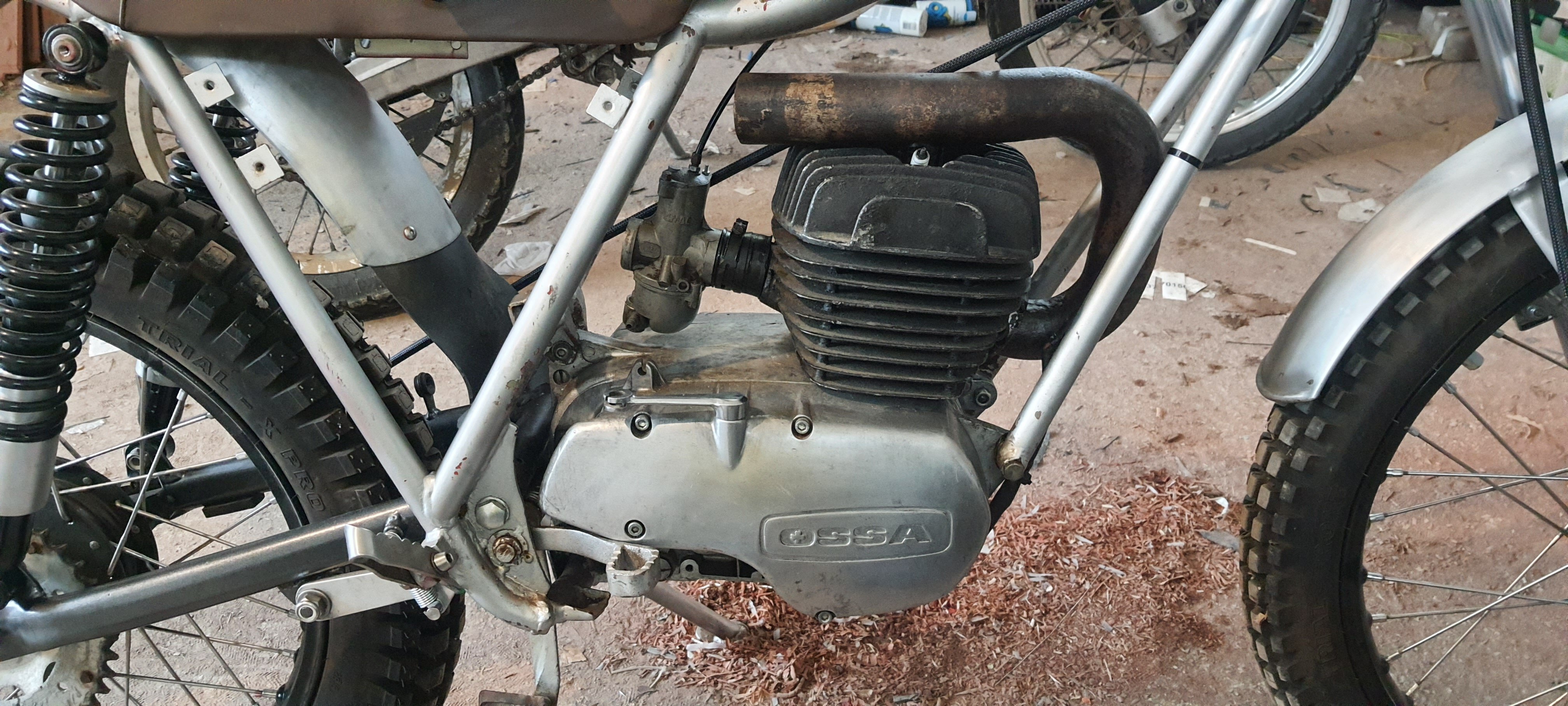

Triad Posted October 23 Author Report Share Posted October 23 This is the engine fitted, the exhaust and carb in place. I found a guy who's got a MAR 350 partially broken in parts in his garage but doesn't seem happy to sell the kickstart lever etc. without the whole engine block. 🤨 I still need the kickstart lever and the 2pins Motoplat coilpack to try to start it... from there I'd at least know for sure the engine works and could start looking for a better clutch cable, rear brake cable, silencer etc. Quote Link to comment Share on other sites More sharing options...
