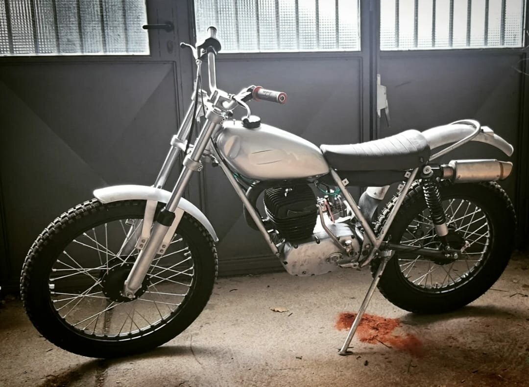

Triad Posted January 23 Author Report Share Posted January 23 Should be close! So, just as a reminder: 1973 Ossa Explorer with late 70s Pioneer engine, Koso PWK30 carb, PVL coil. Still needs a decent silencer as that chinese crap touches the rear tyre. Just fitted the tank, air filter, tank+petcock, fuel hoses, clutch cable. Quote Link to comment Share on other sites More sharing options...
