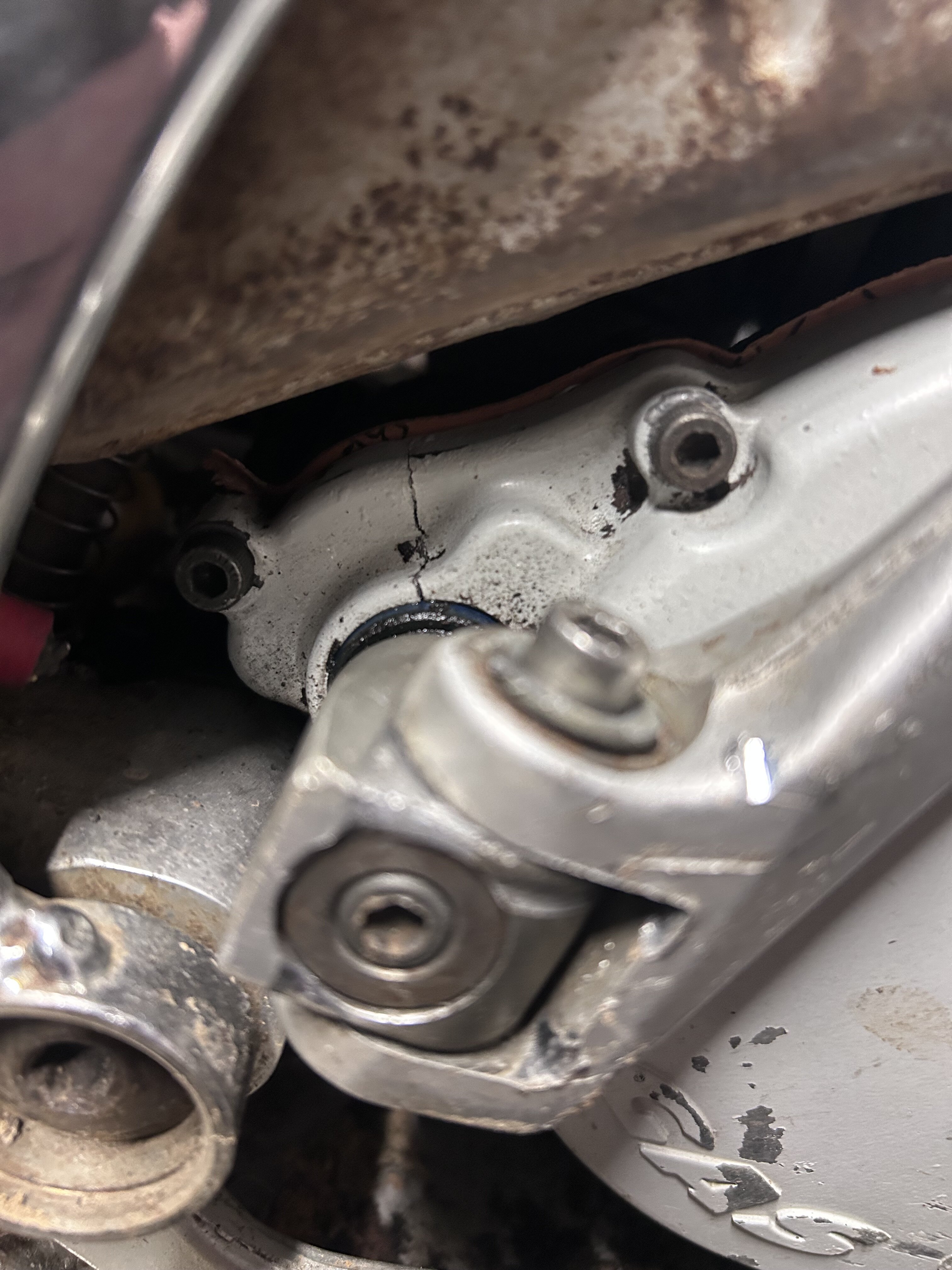

Ive a small issue with my bike , it can be tricky to start, it feels like the kickstart is only engaging at the bottom of the stroke of it.
I know this model can have a knack to start but any feedback or help would be great.
Also the clutch casing has a crack in it (please see attached photo) where kickstart runs through which I’d assume would not help. What could cause this to crack ?
Again any feedback and help would be greatly appreciated
Cheers
Paddy

Hey Pat, I’m no expert but I think the crack in the casing is your problem. It was probably kicked very hard in its life and cracked. Now, it’s my guess, that the kickstarter flexes the shaft just enough so that things are not engaging properly. The kickstart pinion gear and shaft may even be damaged due to the flex. My suggestion would be to open everything up, examine the shaft and gear. I’d also get a new clutch casing or potentially weld the existing crack. Good luck!

Hi Ron
I’d a feeling I may be at fault but there’s no harm in asking the question. I’ll start ripping into it in the next few days and hopefully all isn’t too bad.
Thanks for the reply mate

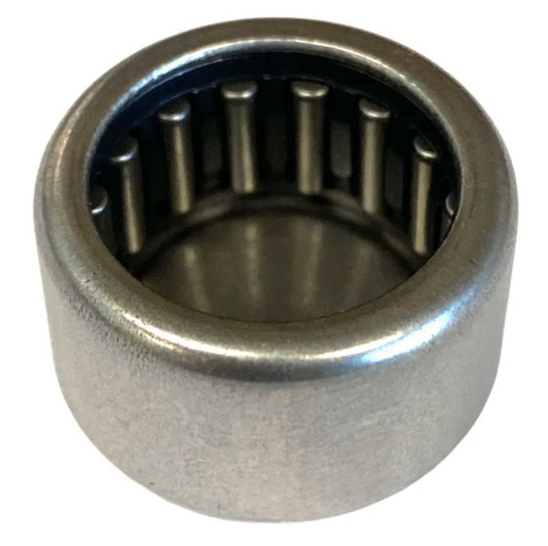

Hi Pat, a tip from doing a tonne of these over the years, you will need to replace the internal bearing that is in the crankcase that supports the kickstart shaft. The GasGas part number is MT2802260067.
When this gets worn over time it allows the shaft to move at the furthurest part inboard, and this then cracks the case. If you dont change that it will happen again.
There is a huge amount of stress on that bearing and they need replacing over time. It has a "blind" bottom , so it is like a cup. It can be knocked out easily with a drift from the left side of the bike - yes the LEFT side! If you look from the left side just below and behind the carby area on the crankcase right side you will see it's "bum". Once you remove the kickstart shaft you can knock it out to the right with a drift.
You MUST do this when replacing the case.
