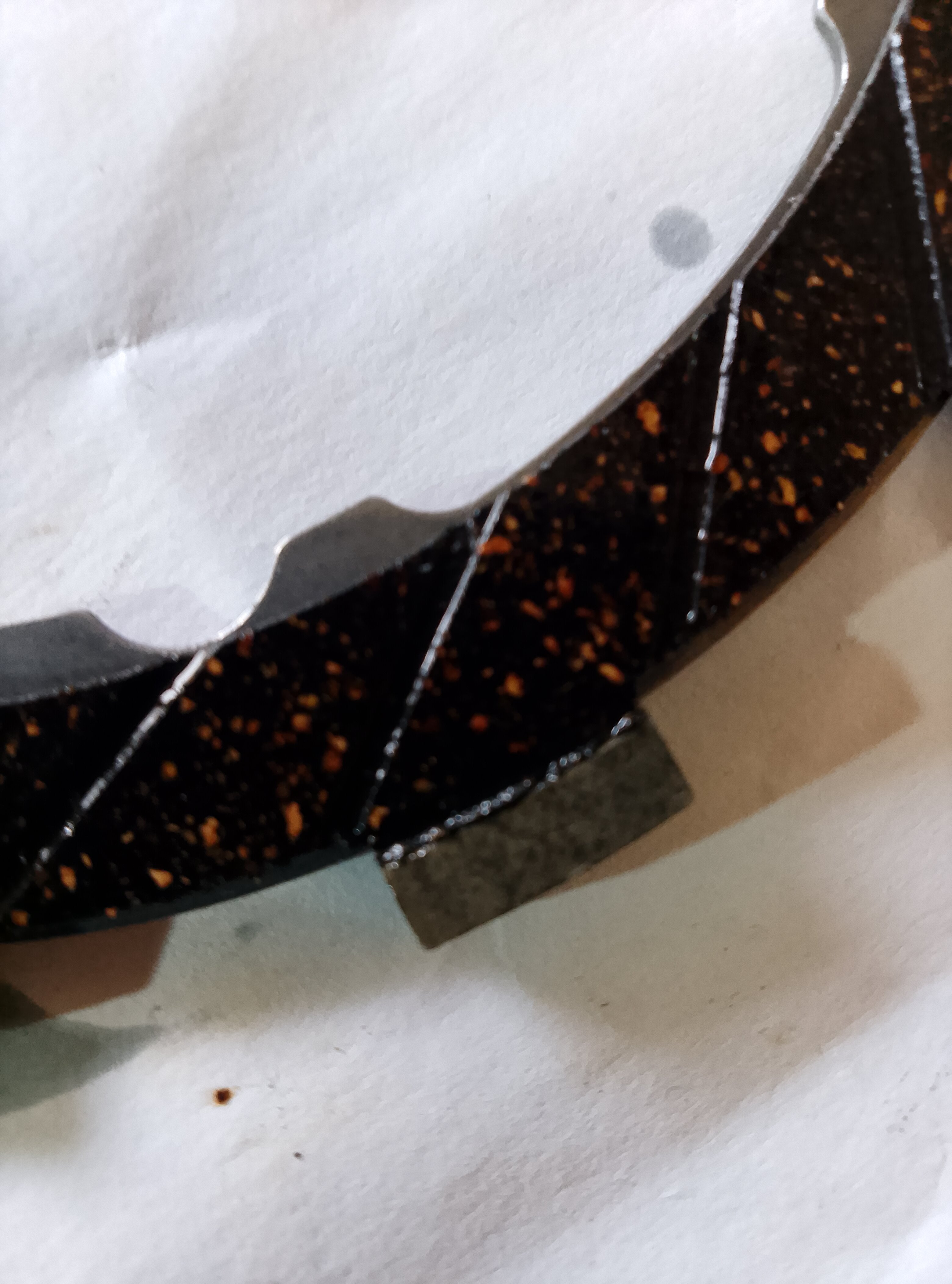

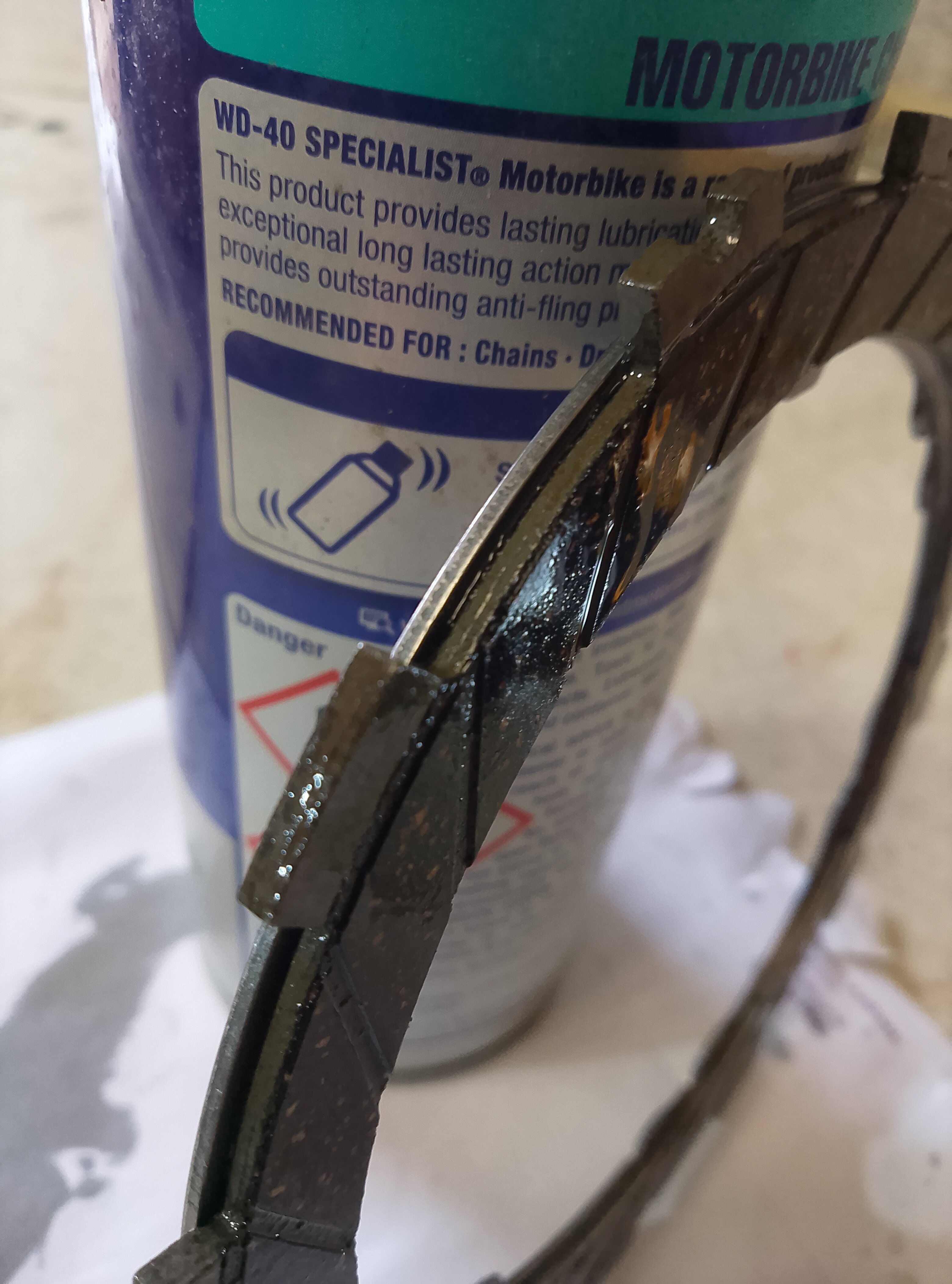

lemur Posted March 6 Report Share Posted March 6 Interesting the slots between the pad contact surfaces appear directional, do the slots go in the opposite direction on the other side or is the disc basically shaped like an impeller? If the pads operate directionally that might make a huge difference depending on how it is assembled. 1 Quote Link to comment Share on other sites More sharing options...
trevbul1 Posted March 6 Author Report Share Posted March 6 18 minutes ago, lemur said: Interesting the slots between the pad contact surfaces appear directional, do the slots go in the opposite direction on the other side or is the disc basically shaped like an impeller? If the pads operate directionally that might make a huge difference depending on how it is assembled. I'll have a look next time the plates are out. Too cold today! Cheers, Trevor Quote Link to comment Share on other sites More sharing options...
