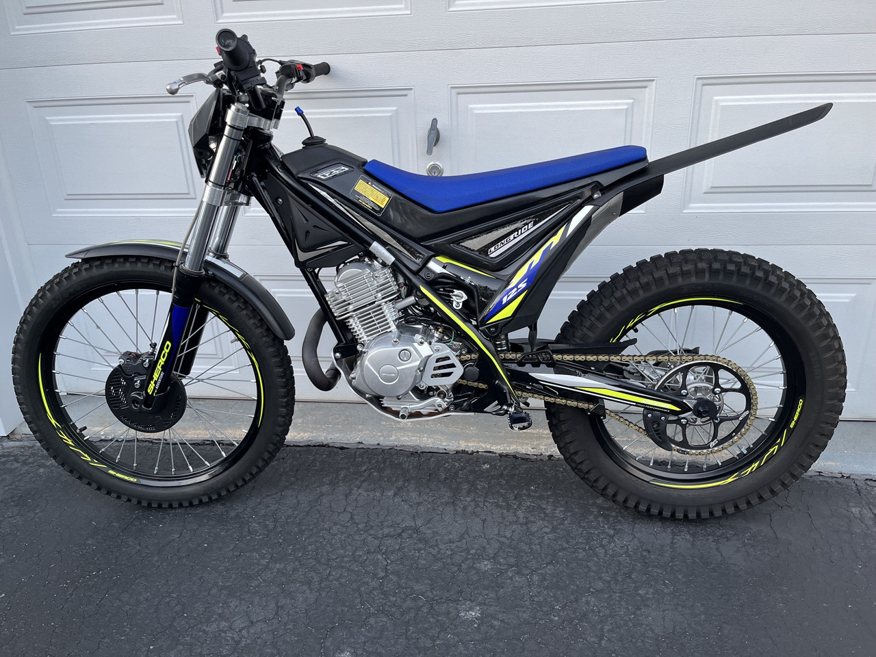

The small (trials style) tank that came with this bike does not fit very well as it extends deeper into the chassis and hits the solenoid and also pushes the cables tight underneath. So I just live with it in its intended config as a Long Ride. It's ultra quiet and perfect for idling around practicing balance!

That is a nice picture.  It looks like it has less ground clearance than standard trials bikes.  Is the correct?  The ground clearance looks a bit like a TL250 which I think is one or 1.5 inches less that most bikes.
