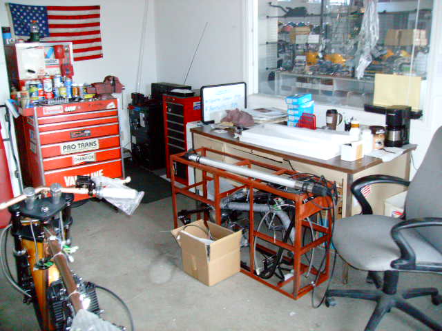

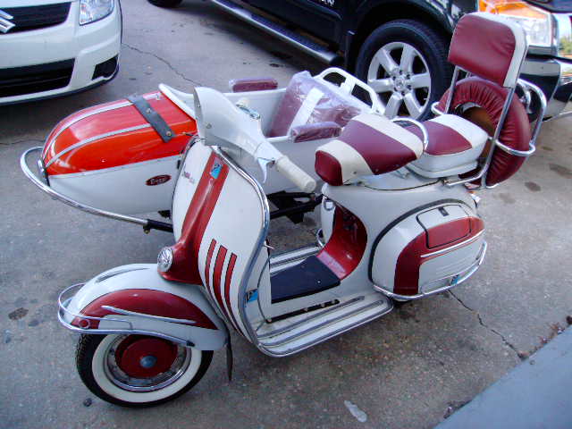

I found a competitive sidecar for Bob and PW ... Just think , they could ride it to events and save on transportation costs too ! Attached Image: K6.JPGAttached Image: K7.JPG

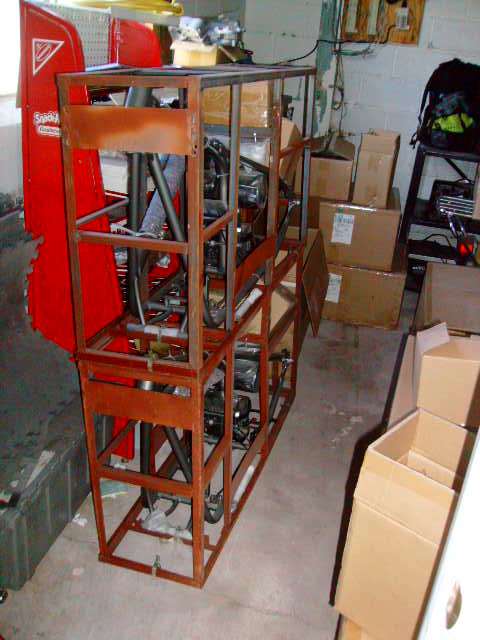

:rotfl: :rotfl: Sorry guys just kidding , but you would not beleive what folks will pay to keep their vespa's in top form ... Yeah I switched from cars to working on motorcycles, scooters , and the random moped . And oh yeah , I'm building these too to pass my free time ! alot more rewarding than cars are these days B)Attached Image: K2.JPGAttached Image: K4.JPGAttached Image: K5.JPG
And yeah , thats a copper plated frame... Wait to ya see the vtwin 250 we got cookin'
