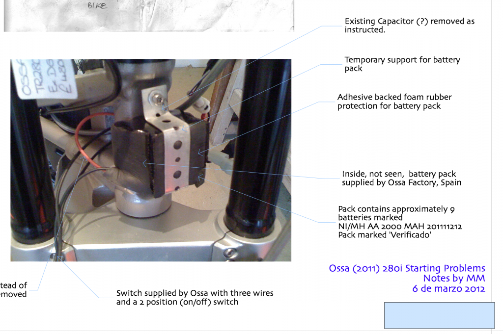

Very similar to the original Ossa factory mod for the early bikes, only theirs was a cluster of AA batteries. Below is the 'hand made' Works diagram. It did transform the starting. Switched on at start of play (bog standard switch) and left on until the end of the event. One small characteristic when switched on, there was a small fizzing sound for a couple of seconds which I took to be the pump charging the injector. Also if the tank was empty there was a distinctly different sound. Crude but effective.

It's a much more complicated schematic though. OSSAs battery pack (8 x 1.5 volt AAs) makes 12V then. With 9V there's no fuel-pump noise when you activate it, hence I think 9V just helps to support the circuitry (and capacitor) to have just enough start-voltage to improve the firing up engine. 12V battery pack is proabaly is even better support and hence it even starts up the fuel pump, but this huge battery pack weights a lot too I reckon vs a small lightweight 9V battery.
