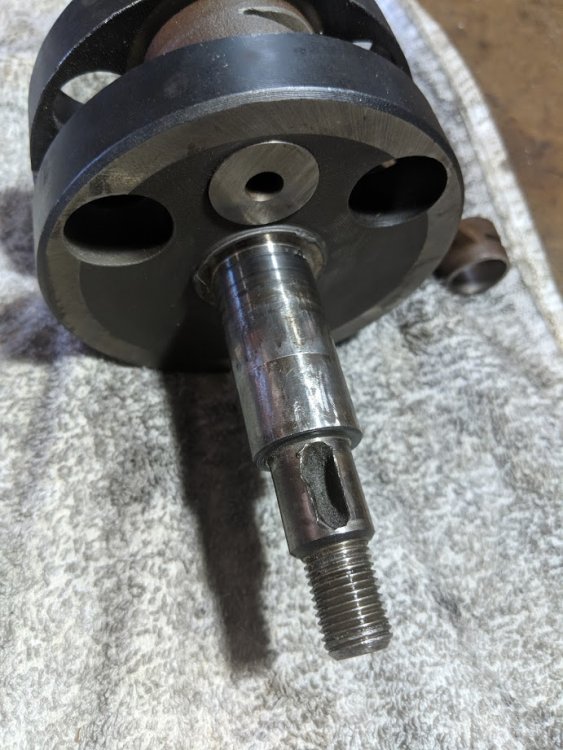

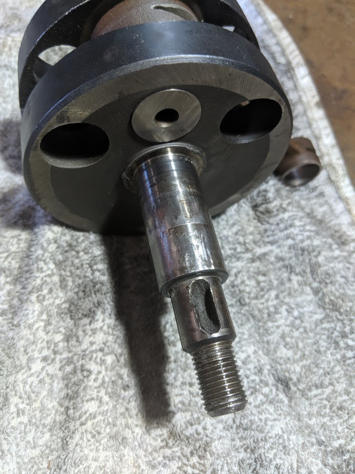

Fairly standard Bultaco failure to shear the drive side key when something goes wrong. One Bultaco I bought recently had that nut welded to the crankshaft! Being a Sherpa T it was a slow process grinding the weld away inside the drive side flywheel recess.

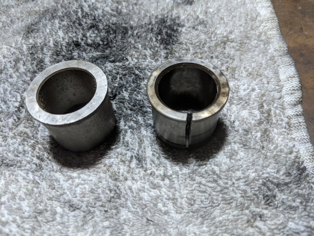

Hi again,
After many different attempts I finally got the seal "bobbin" off by cutting it off. I suspected to find some sort of adhesive under there but actually it's that the shaft seems to be too tight. The new bobbin is the same tightness, if I push it on the shaft I'm never going to get it off again.
feetupfun, you said you find them to be a light push fit, have you ever seen them tighter? I'm thinking I'm going to have to get something machined, either the crank shaft or the inside of the bobbin.

I've pulled apart two more Bultaco engines since then and in both cases that seal sleeve came off without effort. The knowledge that a new seal sleeve jams on the shaft means that the problem is probably the shaft. Being a very close fit, it would not take much of an imperfection to make the sleeve jam, so I would probably study closely to see exactly where the new sleeve starts to jam and try and find what the imperfection was and then deal with it. It may just have something there that can be removed with a hand-held oil stone. If you heated the shaft when you were trying to get the old one off, there will be combustion deposits and maybe some oxide that should be removed (there are deposits visible in the photo). You should also clean the inside of the new sleeve of any rust spots. A scotchbrite scouring pad is good for removing deposits like rust, combustion product and oxide film.
I can see a lip about 12mm in from the flywheel shoulder that indicates that the shaft has been deformed a bit. It may not be that bit of deformation that is your problem area, but deformation of the shaft somewhere is likely to be the cause of the jamming sleeve. The high areas can be reduced or removed using an oil stone. If you have doubts about knowing which areas are high you can colour the shaft with a whiteboard marker or with chalk and do a test fit. The high bits where it jams will be wiped clean.

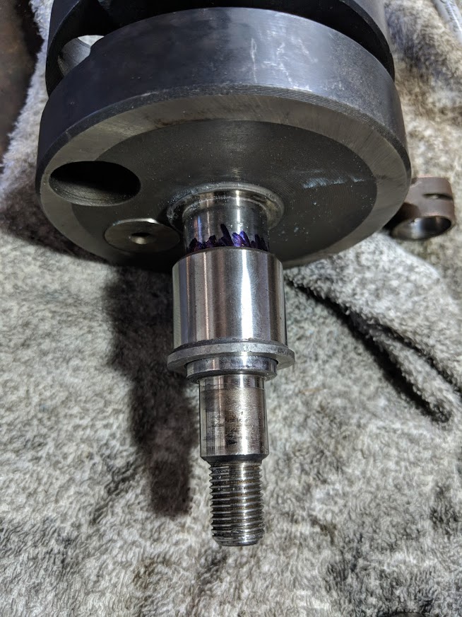

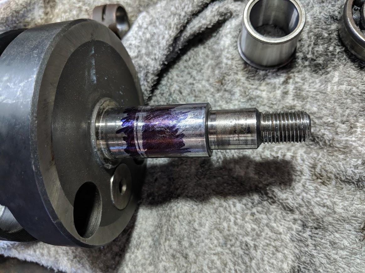

Well I went at it with an oil stone and it soon appeared that I would need a lot more to get the sleeve onto the shaft, I ended up having to use a fine file. Hopefully, by working slowly and on the high spots I kept the thing round. I was careful not to touch the shaft under where the bearing fits.
Next, to check the crank webs are still true, heaven knows what this engine has been through to cause these things :(

So, since doing the work to the crank I've been thinking that the crank I have must be from an earlier bully with two bearings on each side. The ridge visible must have been the line where the second bearing came up to. So now I'm worried that by taking off what ever metal I have I've put the shaft out of round, not to mention what ever else dimensions might be different with this crank.
There is a friend of a friend that I will be able to take this to, hopefully I will be able to compare with the correct crank, and also check for run out on the shaft.

Hi Mate, I am nearly 100 percent sure, that there is no difference between cranks wit two or three bearings. I found them in several sherpa and alpine engines. The difference is the seal holder. on the picture left side for one bearing, the right one for two bearings drive side. there also exist different seal sleeves. a long and a short one...greets
