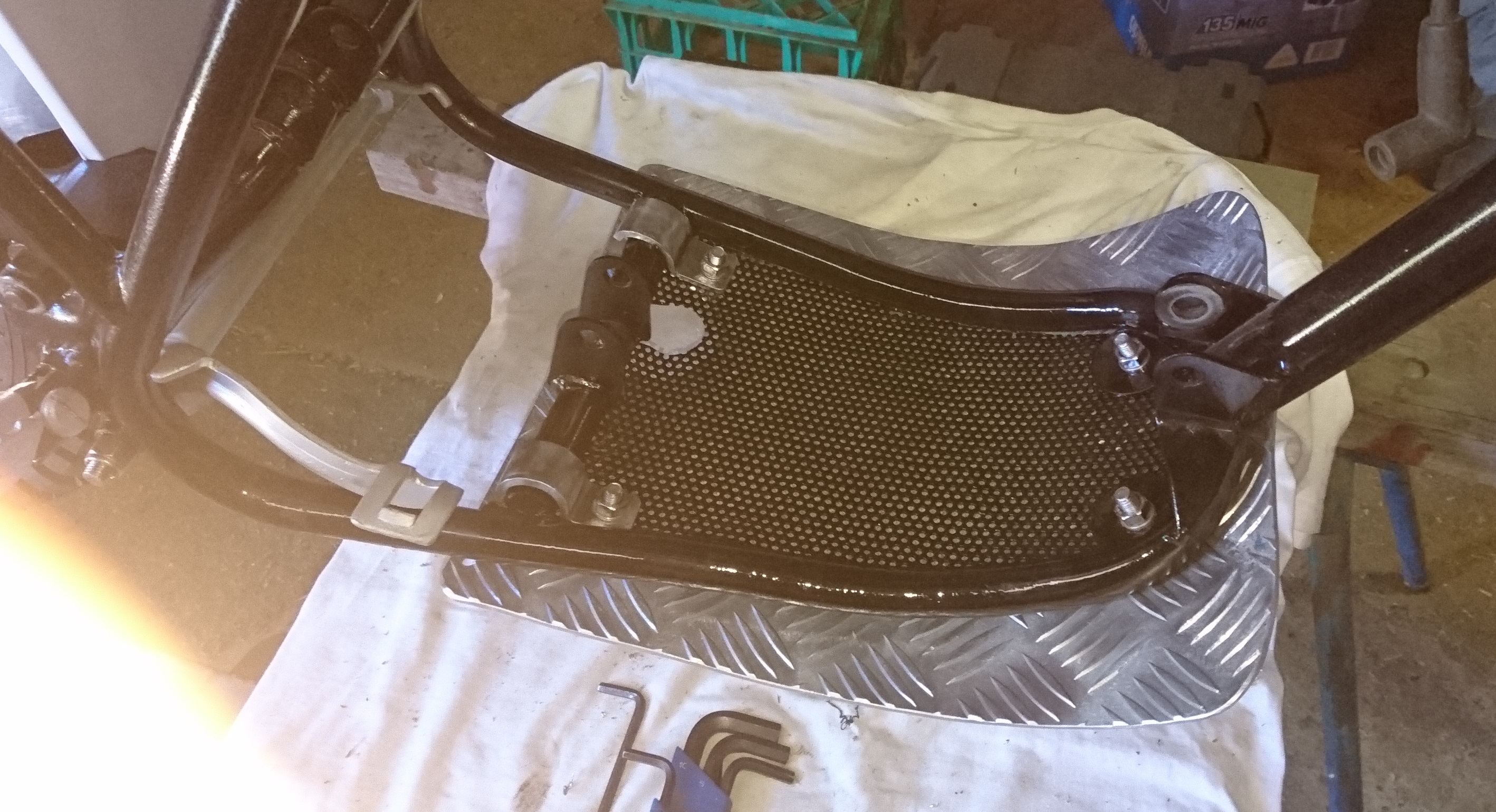

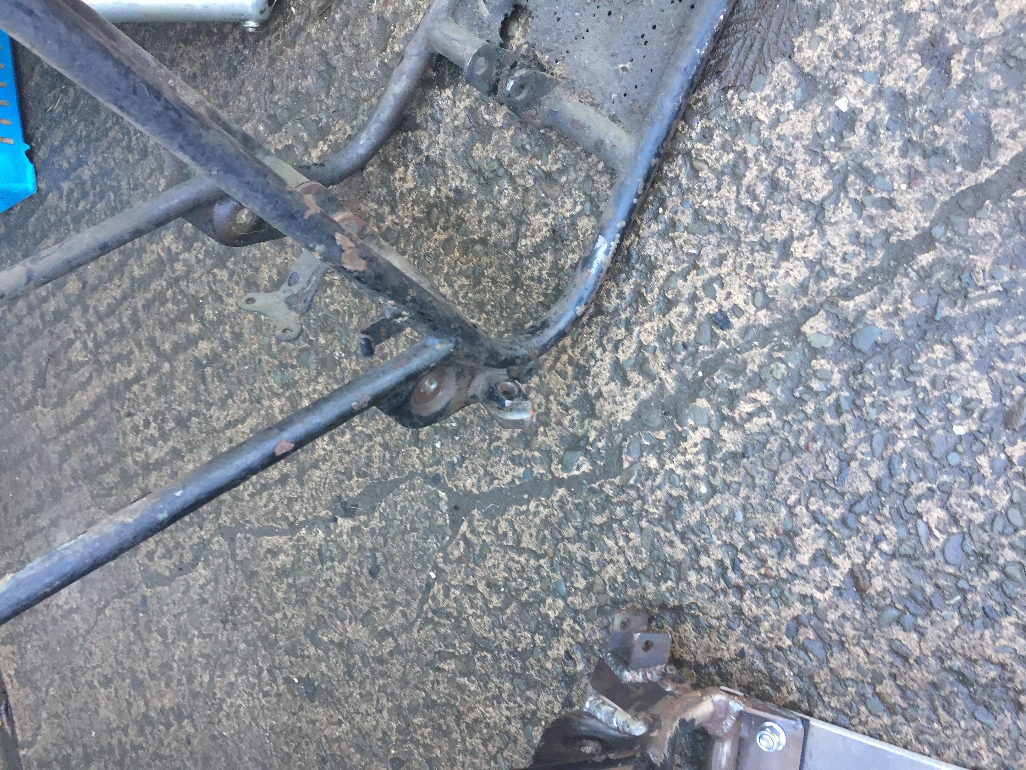

After all the feedback and pictures I've started making the new bash plate. Looking at the trashed side cases on my bike and the Renthal one, I understand why they designed it like that, simply to protect the leading edges of the magneto and clutch cases without compromising ground clearance - they obviously weren't concerned about damage to the lower frame tubes. I can also understand that as these bikes were built to do a task and longevity wasn't in the original plans.
I decided to go similar to the bottom picture keychange posted, except I'm making the back edge a bit longer to go under the rear cross-member. I had some 4mm diamond plate aluminium left from a previous job, so using a piece of that, the diamond pattern will be topside as I didn't want anything underneath that could snag on a log or rock and it won't make any difference on the topside. Still have to figure how I'll attach it and will post a picture when it's fitted to the frame.
2 people like this

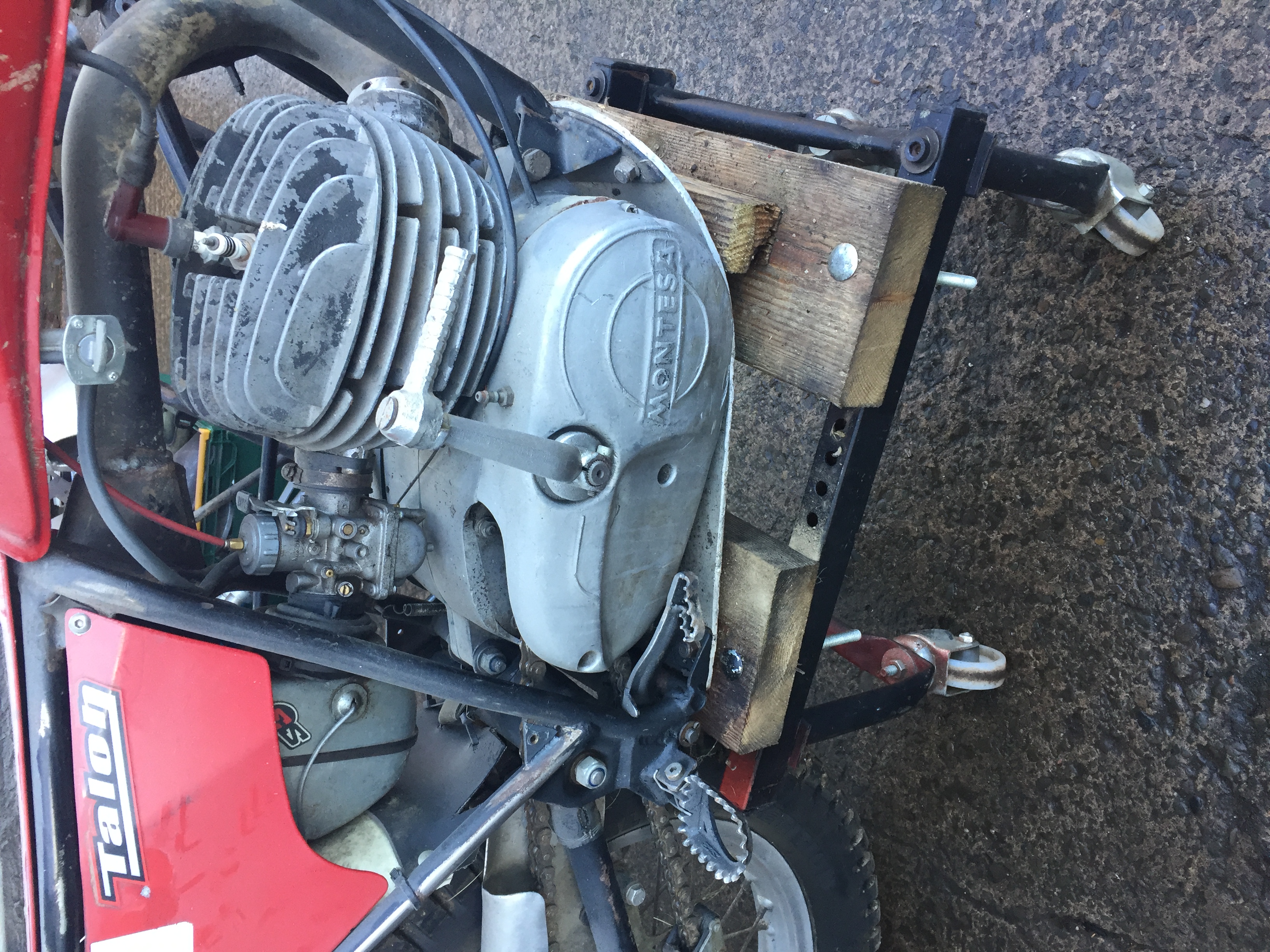

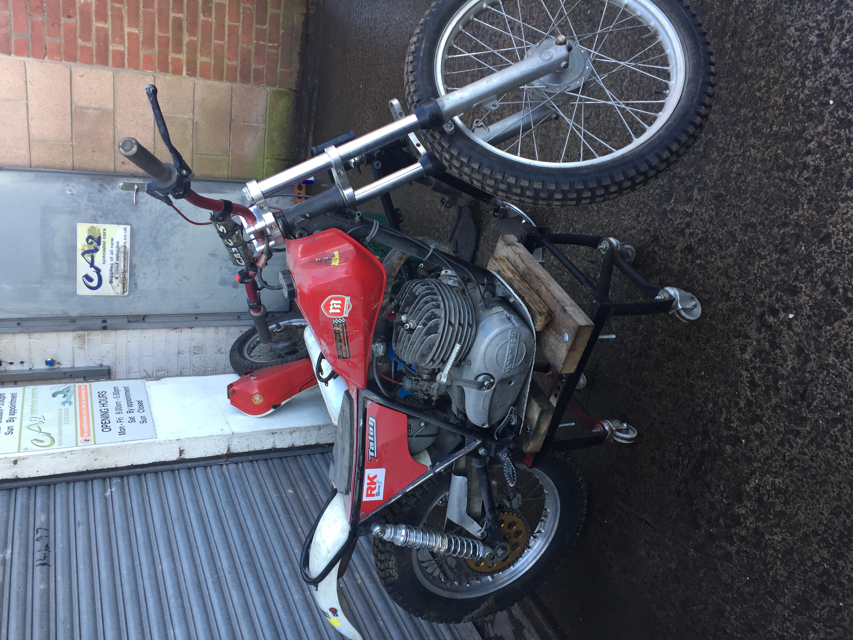

Better late than never. Here are a couple of photos of 348s. One has the loops and I think it is the final model 348 frame.
The other one is my 348 ride bike and the side pieces are made of curved 3mm steel plate welded to the frame rails. It was like this when I got the bike 15 years ago and it works pretty well so I have left it as-is

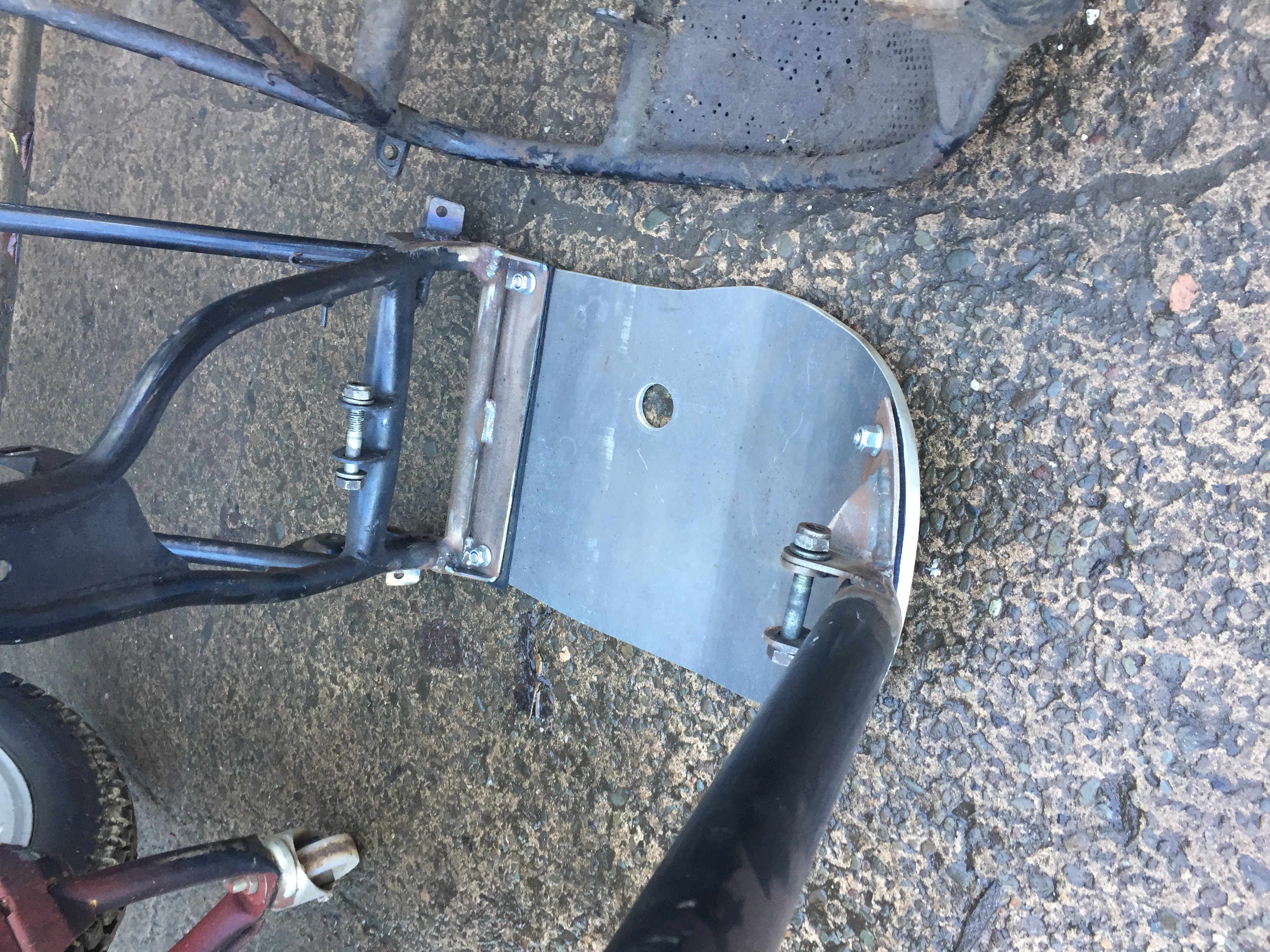

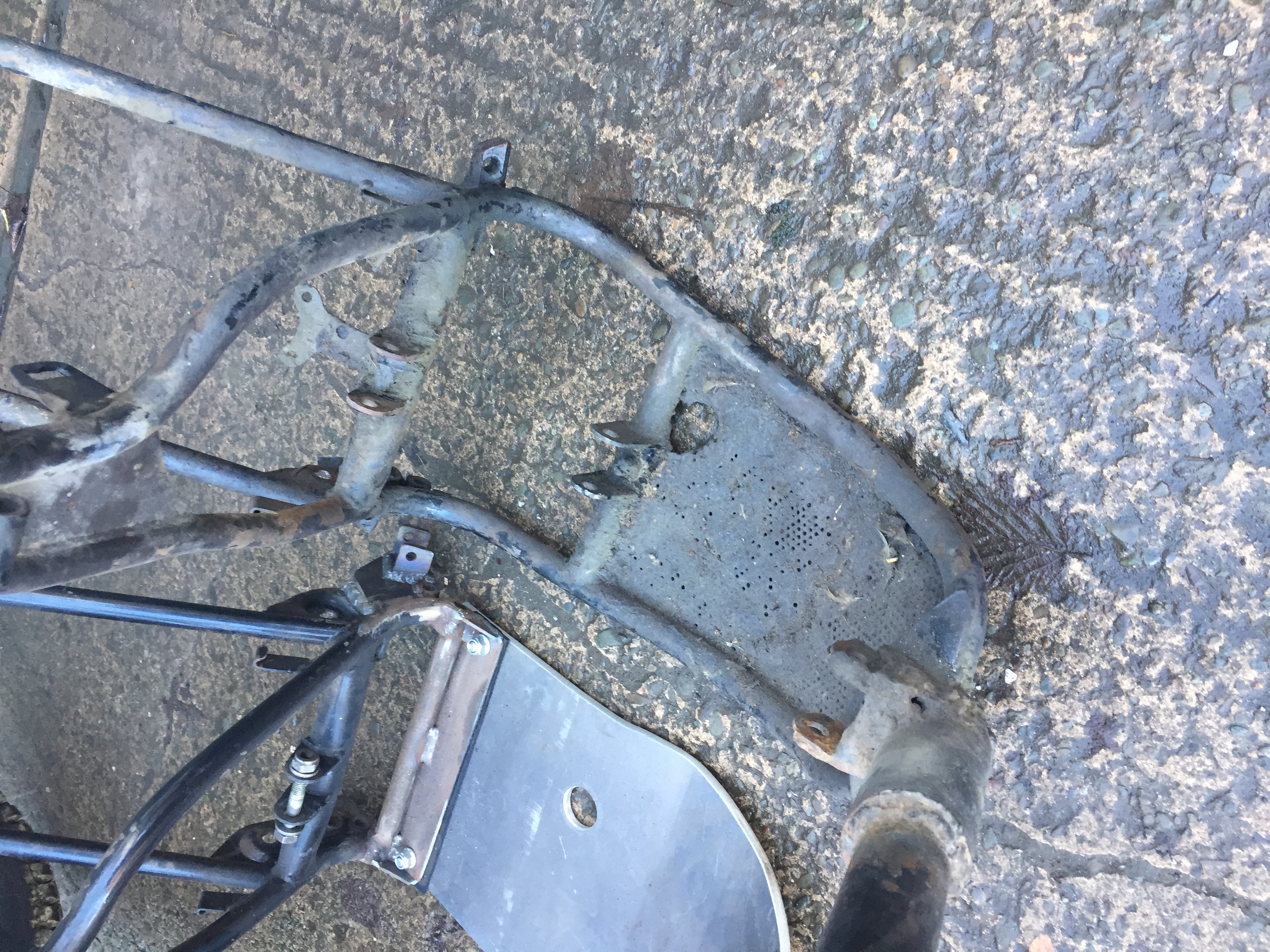

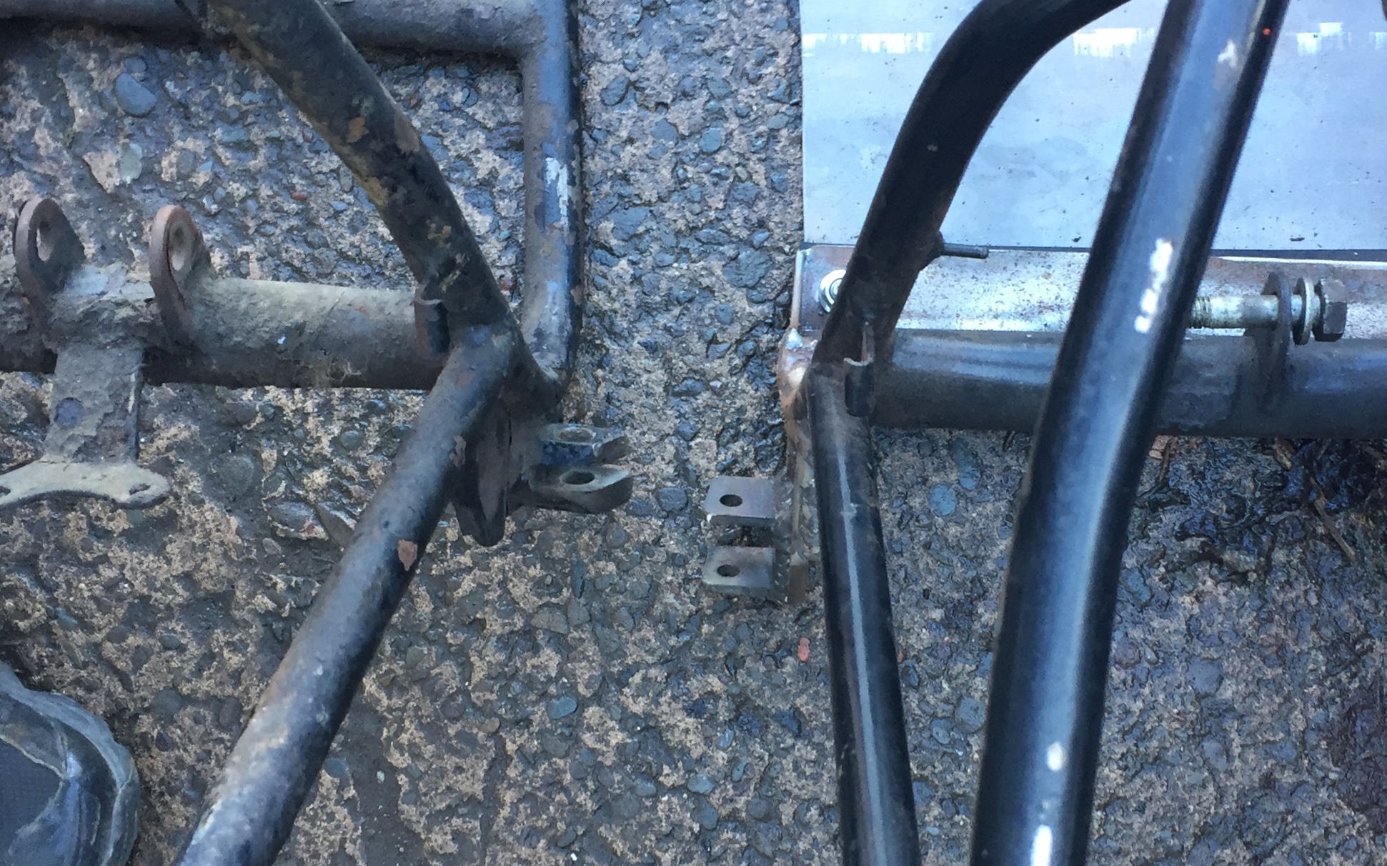

Picture of new bash plate below - I built it as I said above - looks pretty with the diamond pattern on top and is nice and smooth on the underneath "contact" surface. Got it shaped up pretty close, then fitted it and "massaged" it to be a neat fit to the bottom rails - may have to massage the edges a little more when the engine goes back in, but happy enough with it as it is for now.
3 people like this
