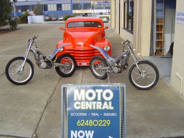

It runs a 454 Chev, or 7.4 litres with all the go gear. Its a 1948 Chev, the only original part is the cab, and thats had a 6" chop, the rest is fibreglass on a homemade chassis.
here`s a pic of my other toy, this ones got a mother of an oil pump. Piece of crap to get into Trials sites though. Wonder what Mr Honda RS knows about these.!!!!!!!!My pickup
