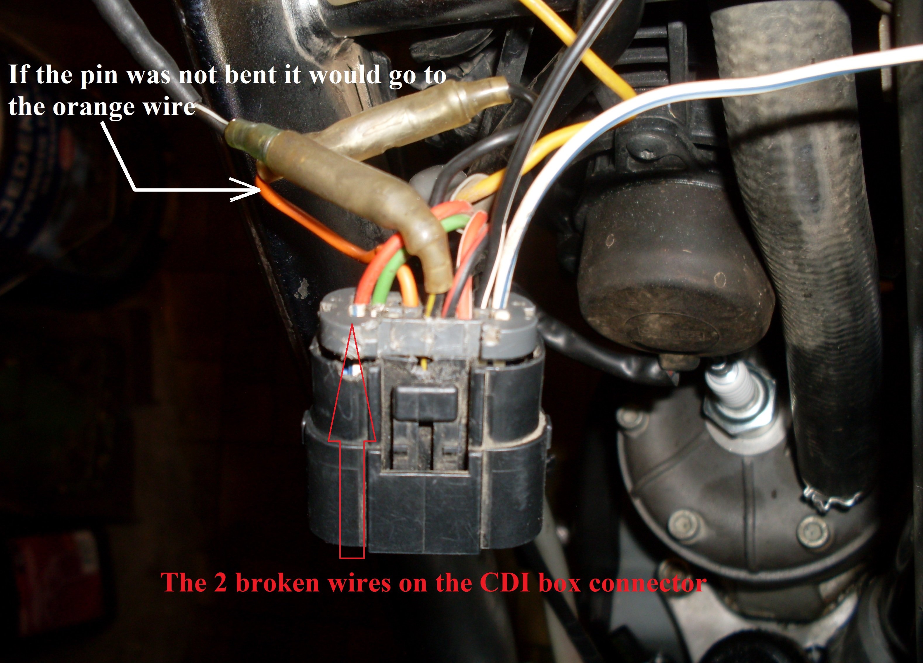

    No reply are needed since i have straightened the pin that was bent. No way that the bike came like that from factory with a pin in the CDi box bent so it "hooks" up with the pin in front of it and goes to an empty slot in the CDI connector on the stator harness.

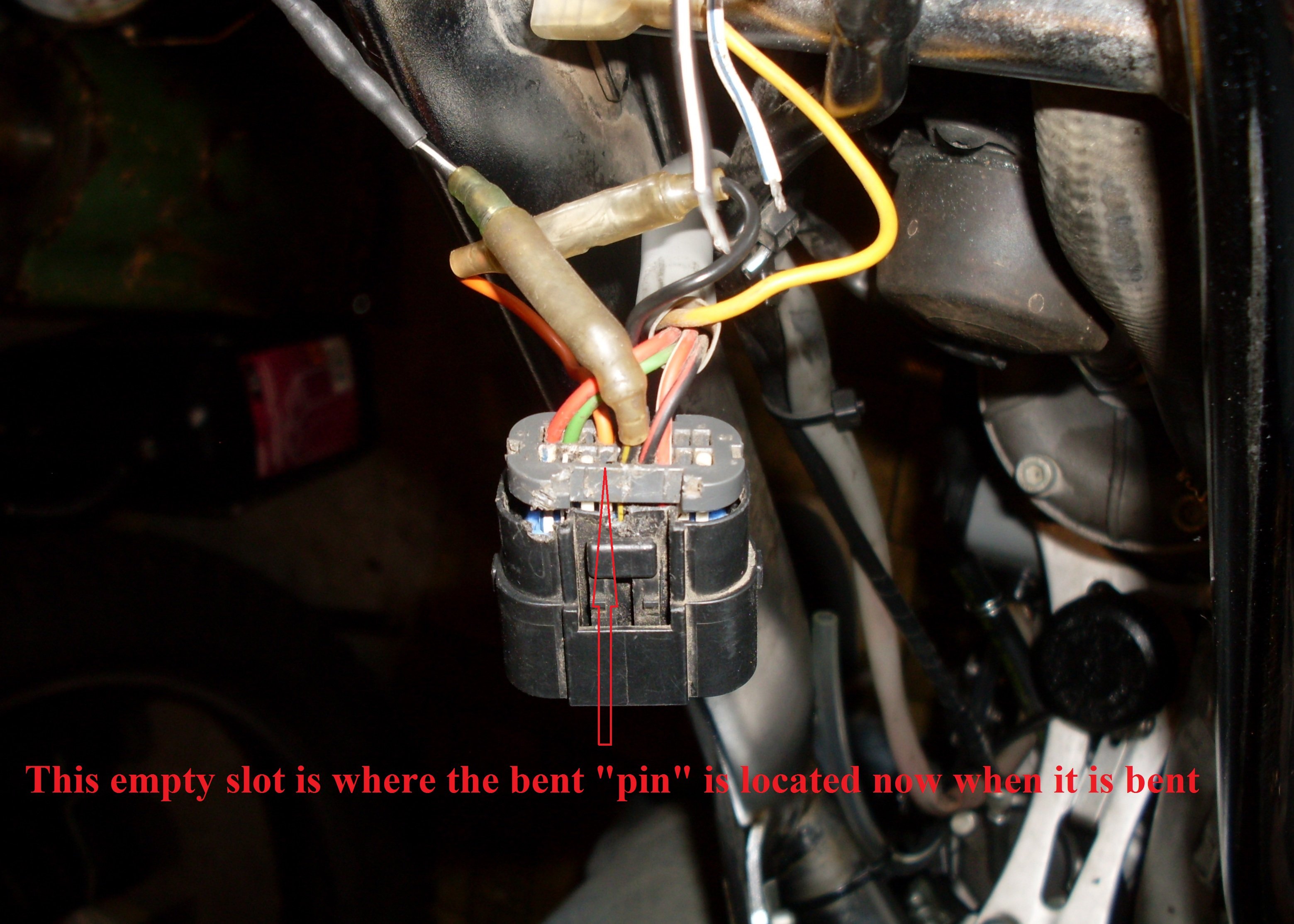

    Now after i straighten the pin it goes to the orange wire on the CDI connector on the stator harness

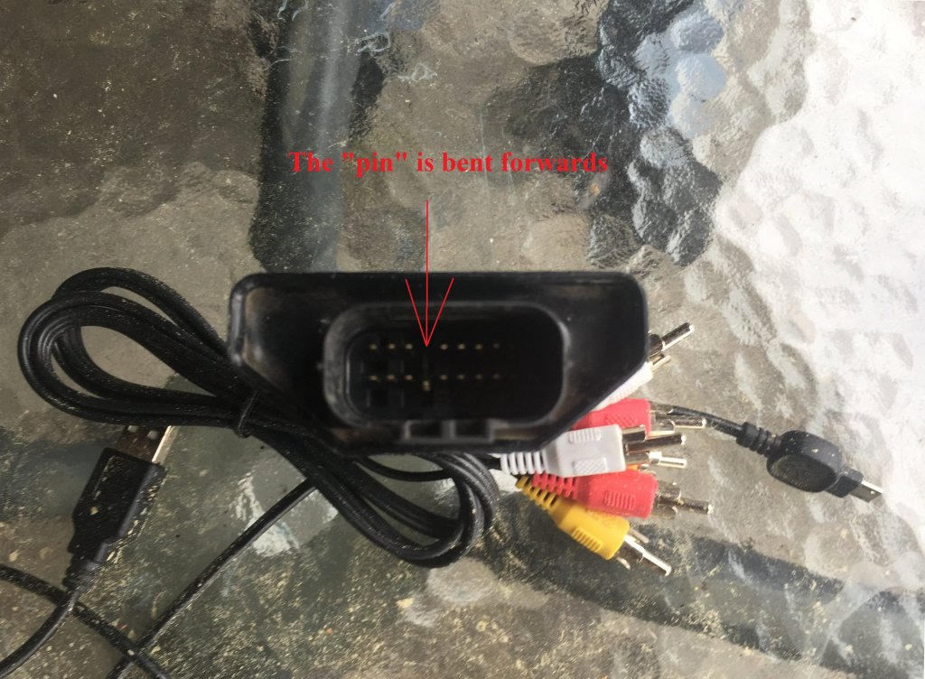

    Not easy to see which pin was bent on the CDI box
  2. Here is a picture showing where the bent "pin" sit in the connector now that it is bent.See the picture 4 below:
    The picture have red arrows and text on it
    If the "pin" was straight like all other "pins" it would connect to the orange wire behind the empty slot in the connector
    Pic 4. This is where the bent pin sits now when it is bent. 2005 Gas Gas TXT 125 Pro.JPG

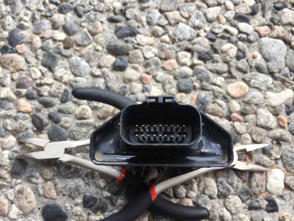

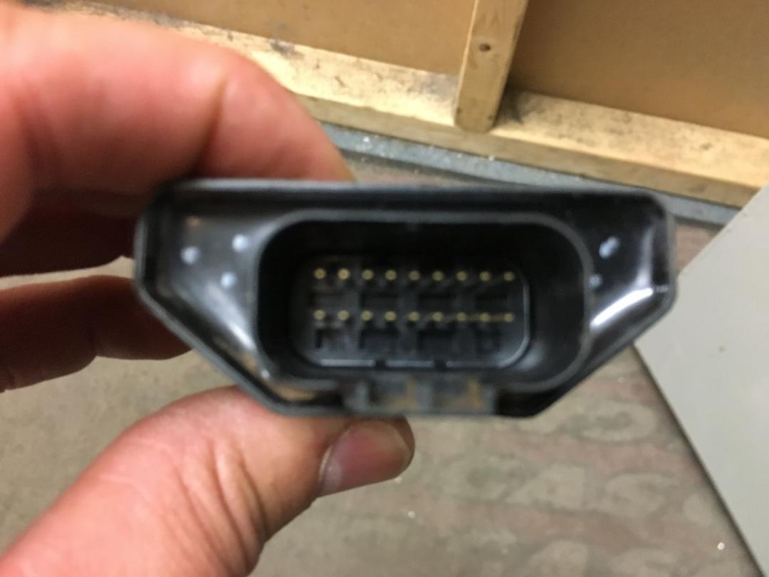

    Here is a picture of a CDI box i received from TrialsBreakersUK
    No bent pins. But the "pins" in this box looks to be round while on the CDI box on my bike the "pins" are flat
    All the letters and digits is identical except the last 4 letters and digits  to the CDI box with the bent "pin" on my bike

  5. I was checking the spark on my 2005 Gas Gas TXT 125 Pro when i noticed that 2 wires on the connector for the CDI box on the stator harness was almost broken off.
    The wires was only hanging by 1 single strand in the wire each so that explains that i did not have a spark at each stroke of the kick panel
    I replaced the 2 broken wires with new ones that have the "end pin" that goes down inside the stator harness connector for the CDI box
    But when i looked inside the "connector" on the CDI box i can see that one of the "pins" is bent so it goes to an empty place in the connector on the stator harness. See picture 1
    If the bent "pin" was not bent it would go to the orange wire on the stator harness connector for the CDI box. See picture 2. This picture also shows the white wire with a blue stripe and a black wire with a white stripe that was broken off but this is repaired
    The blue seal and orange end cap that usually sit inside the CDI box connector on the stator harness was not present on my bike. Someone have taken off the blue seal and end cap. See picture 3
    That they have taken off the blue seal and orange end cap i think makes it  more easy to bend a "pin" when putting the CDI box and connector back together
    TrialsBreakersUK sent me a picture of a CDI box for a 2005 Gas Gas TXT 125 Pro and the CDI box they sent a picture of have only straight "pins". No bent pins.
    Checking the number on TrialsBreakersUK I have the identical numbers except the last 4 letters and digits. The last 4 letters and digits on my CDI box ends with 4K08. On the CDI box from TrialsBreakersUK the 4 last letters and digits ends with 5D26
    The bent "pin" and the last for letters and digits is the only difference of the CDI box on my bike and the picture of the CDi box from TrialsBreakersUK
    Do any here know if the bent "pin" in the CDI box is supposed to be bent like it is, or do you think the "pin" have been bent by accident?
    It must be more easy to bend the "pin" by mistace since the blue seal and orange end cap is missing and that makes room for more play so it is more easy to bend any of the "pins" on the stator harness
    Hope any members here can help me out here
    Picture 1. Bent "pin inside the CDI box. Is this supposed to be like this or is it bent by accident?
    Picture 2. The bent "pin" would connect to the orange wire if the "pin" was not bent. Now that the "pin" is bent it would sit in a empty slot next to the black wire with a red stripe in front

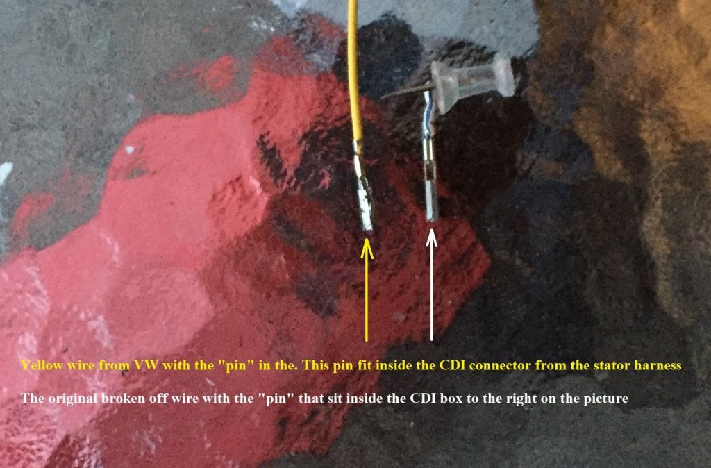

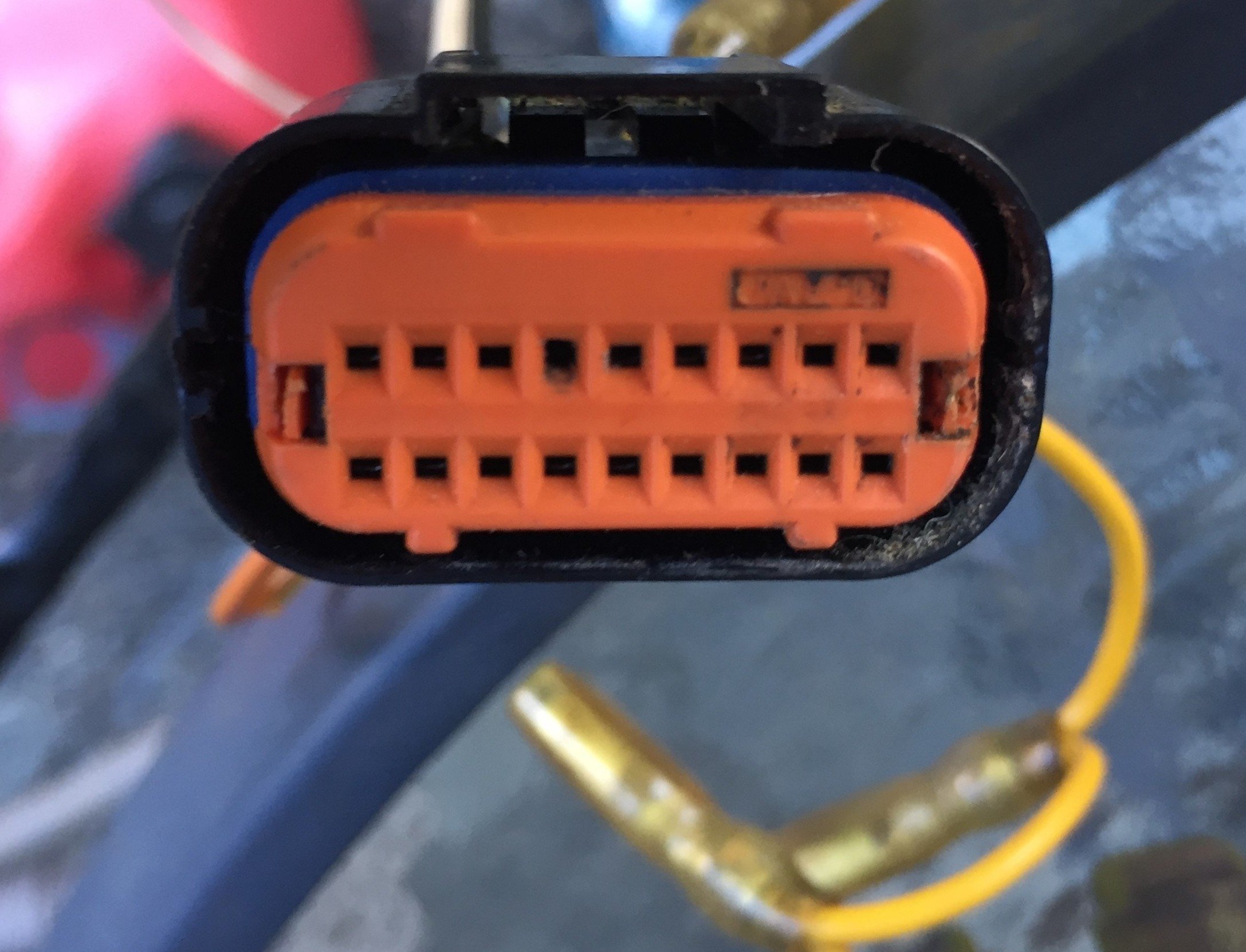

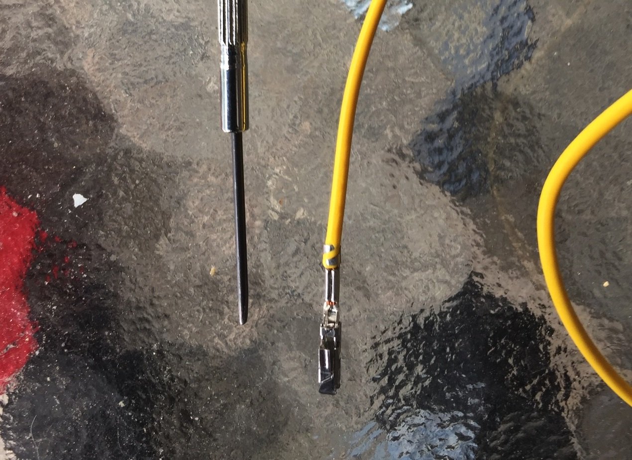

  6. There are no soldering needed after i replaced the wires.
    The new yellow wires with the "connector pins" on each end fit in the CDI box connector so you only have to pull out the 2 broken wires with  "pins" in the end that sit inside the CDI box connector and replace them with the yellow ones from VW
    I have already replaced the broken wires. I pulled out the 2 "pins" that the 2 broken wires with the crimped on "pins" from the CDI box copnnector and replaced them with the new yellow wires fom VW
    After i replaced the brooken wires in the CDI box connector i have now a even spark on the spark plug for every stroke of the kick starter (done by hand just to check the spark)
    New yellow wire with the "pin" to the left and the old originak broken off wire with the "pin" to the right
    Yellow wire with new pin from to the left. Original pin on the broken off wire for the CDI box connector. Pic 1.jpg
  7. I am posting this in case any other here on the forum have the same problem
    I had 2 broken wires on the CDI connector on one of my bikes and off course the wires where broken almost down inside the CDI box connector (see the picture)
    I was not able to find identical "connector pins" that sit on each wire inside the CDI box connector but i found "connector pins" that can be used to repair this problem
    VAG or VW have the "connector pins" with the yellow wires and they can be used on the cdi box connector
    The picture below shows the CDI connector on my 2005 Gas Gas TXT Pro with 2 broken wires. The white wire with a blue stripe(see red arrow)goes to the coil
    The black wire with a white stripe(see blue arrow) goes to ground on the coil bracket
    The picture at the bottom with the yellow wire shows the "connector pins" that you can buy at VW. They are a little pricey but the alternative is to buy a new stator with harness i think..

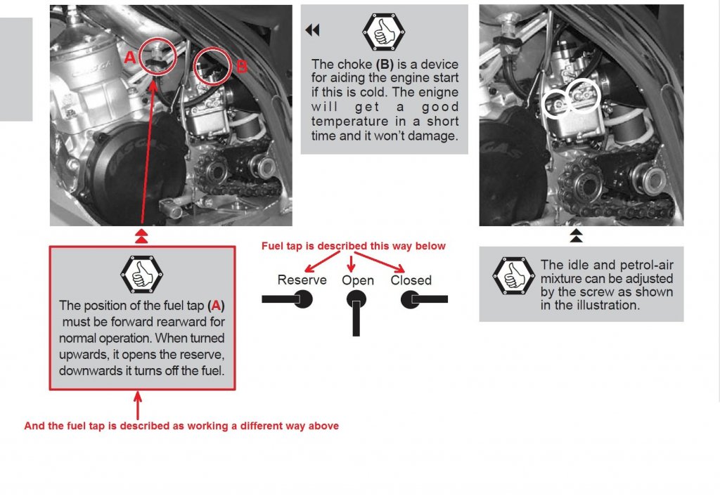

    I will off course change the oil but i thought i would run the bike up to temperature before changing the oll
    Also note the fuel tap instructions from the Owners Manual. It shows 2 different ways of working the fuel tap which is kind of strange. Perhaps the bike came with 2 different types of fuel taps?

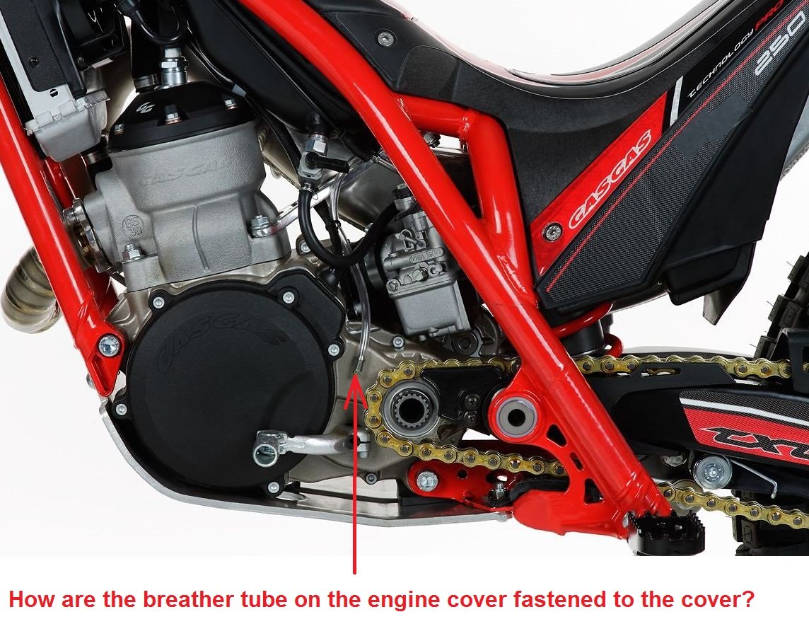

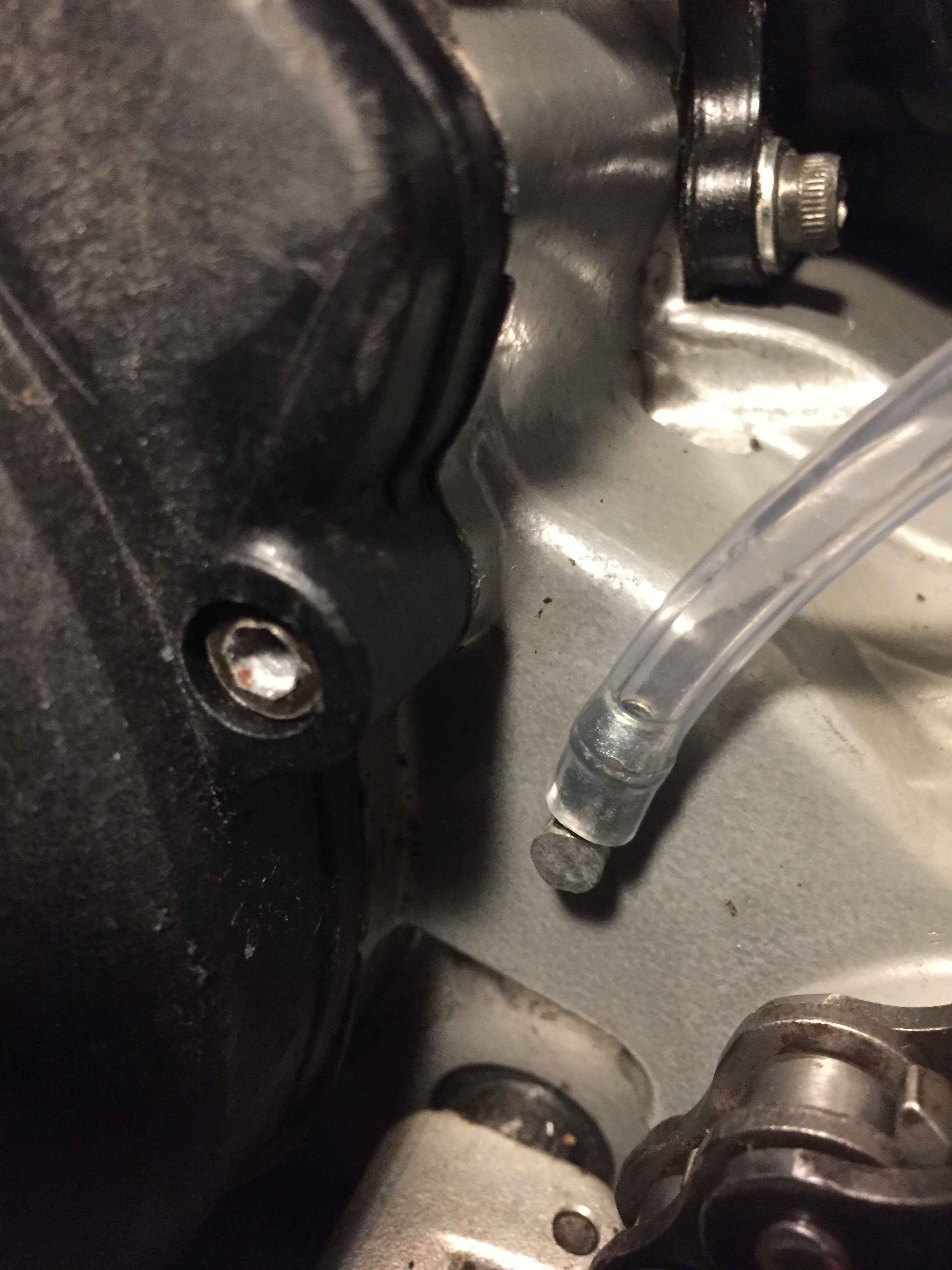

  15. Any of my fellow members here knows how the breather tube that sit on the left side in front of the gear lever is fastened?
    It is missing on one of my bikes and the one i received today looks just like it supposed to be pushed in..
    See the red arrow on the picure below for the breather tube i am talking about
