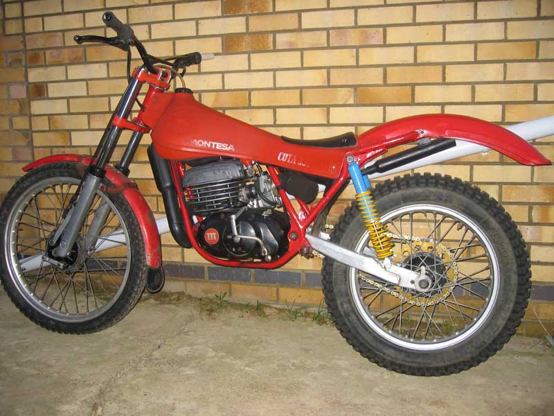

My intentions are to get the bike rideable at the moment. When and If I get her running sweet I will then set about a 'cosmetic overhaul' as the funds allow it.
It is looking slightly better now and I hope to give her a blast soon.

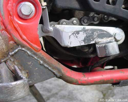

Hi Steve
Was trawling through the Todotrial website and found a couple of pics of a 330 with modified footrest mounts...these would seem a bit more sensible.
Martin
Good spot Martin, Thanks.
Don't think much to the welding. Simple solution on the back brake though, might do that myself when the time comes.
