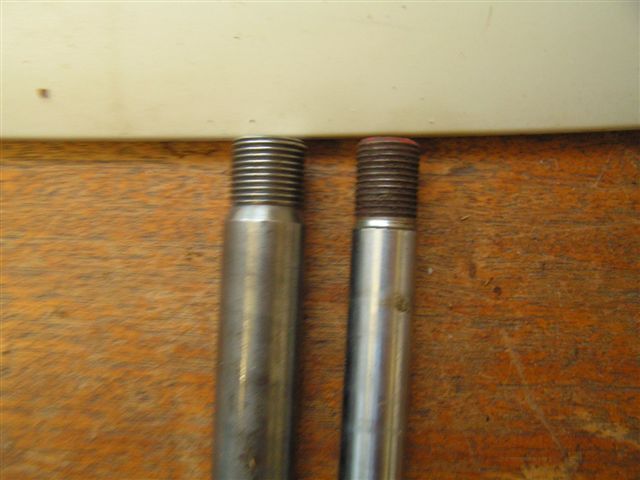

post-1226-1169045274.jpgThe swing arm spindles are 2 different sizes, back kick 16mm and forward kick 20mm. As far as I am aware, all frames were threaded. The back kick clamps the thread on the left. The forward kick clamps the plain rod on the right. Hope this helps.
