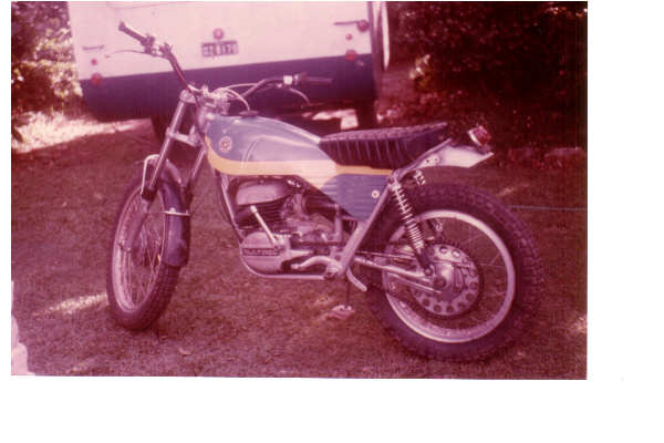

Hey Pete Bulpedro. I agree with you about the M85. They are quite OK once geared low enough. The closest Alpina to the Sherpa T of the same vintage.
The M85 was my first Bultaco and I rode it in trials and enduros back in 1976. I remember it cost $450 and in quite sad condition when I bought it in 1975. Here is a picture taken in 1976 after I repainted it.
