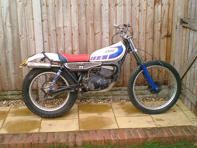

thanks for the advice. It does indeed have 434 stamped on it. Will a later twinshock ty250 swingarm fit as the current one has a hole worn though it from what looks to have been a MX tyre rubbing against it! It has the mudgaurd bracket but the silencer one is missing.
I have spent 2 hours today removing all the remaining bodyfiller from the tank, someone had tried to reshape it for some reason but its back to how it should be with only one dent to refill.
I have been given this rolling chassis as a donor, the wheels and forks are good and the talon sprocket is almost new.
When I cut the shock mounts off do I just weld the stubs onto the seat rail? seems a bit crude to me!
mines a bigger mish mash,some one cut the rear mounts of my majesty,frame and swingarm. i willswop the swing arm but the frame mount will be remade on a lathe and rewelded on.
