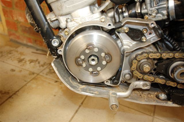

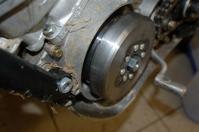

March 24, 200917 yr Julian Wigg fitted the biggest weight he could to the mag and it transformed the motor of the bike. Will get a photo later if I can.
March 24, 200917 yr I wondered about adding a flywheel weight to the revvy little thing. I have asked a few people about this and no one had done it to theirs so I gave up. I would be very interested indeed in this and very grateful if you could sort out the piccies! Would this be something that Julian Wigg could sort out for me? If so, do you have contact details. Do you find that after a strong rev, it takes a long time to come back to low revs? I'm concerned that if there is an obstacle that needs a good handful of revs followed by a tight turn, that the thing might still be revving and striving forward. Hope that makes sense!!!? Thanks!
March 24, 200917 yr Wish you were nearer then you could try it its made soooo much difference. First off it is really difficult to stall and the take up is much more linear than the buzzy moped engine it starts off as. I can do figure of 8's with it without clutch.
March 24, 200917 yr Do you have the details of the weight fitted? Was it possible to fit the weight with the standard cover or did you need some kind of spacer to accommodate the additional flywheel weight? When you say "without clutch" how do you mean? The clutch on a TXT50 Boy is surely just there to really pick up the revs for a big climb or step???
March 25, 200917 yr Many thanks for posting the photos dabster! This appears to be a GasGas 50 cadet or something as opposed to a GasGas TXT50 "Boy" as the photos show a gear shifter. The Boy is a small wheel automatic. I bet that the extra weight made a huge difference to the bike as you say, but I'm not sure how it would work with an automatic???
March 25, 200917 yr Many thanks for posting the photos dabster!This appears to be a GasGas 50 cadet or something as opposed to a GasGas TXT50 "Boy" as the photos show a gear shifter. The Boy is a small wheel automatic. I bet that the extra weight made a huge difference to the bike as you say, but I'm not sure how it would work with an automatic??? If its the same motor I would give it a go, its the motor that makes it more difficult to ride, my 10 y o girl was useless till the mod.
