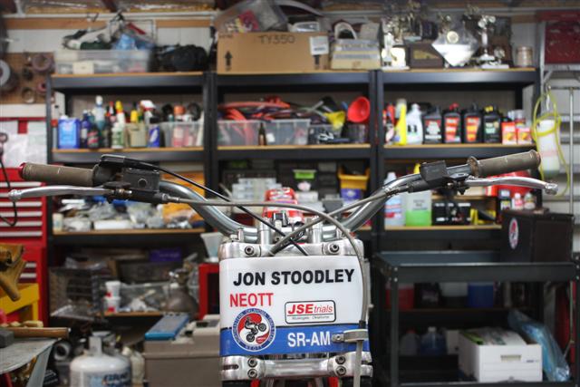

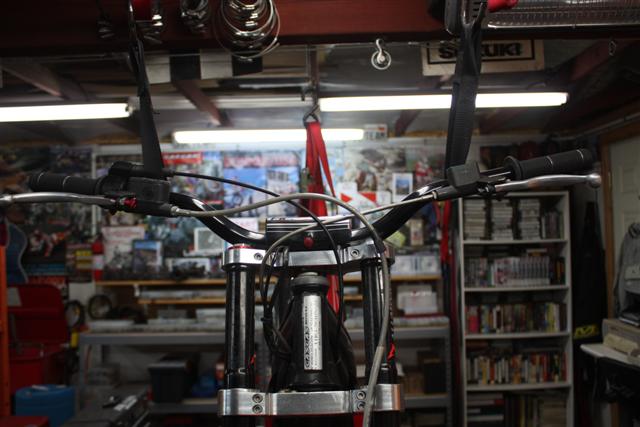

At 6 4, I would imagine taller bars will help a lot. I've been using a set of Hebo bars (HR30009285) for about 3+ years now and it really helps the back. Here's a comparison to the slightly taller black GG bars (some are really low):
