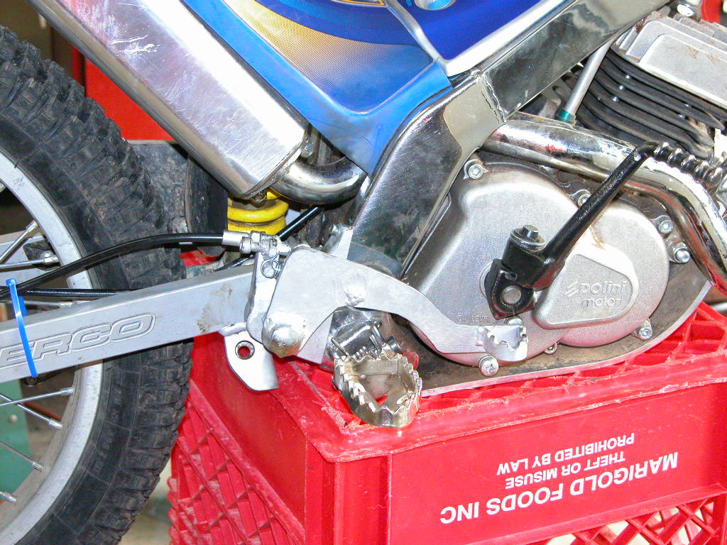

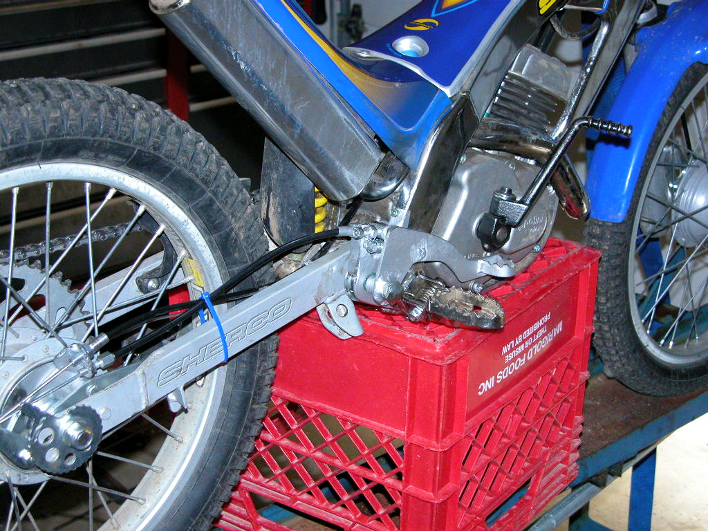

On my sons (Dean's) I ran both a hand and foot brake connected to the rear. I felt it was important with the centrifugal clutch to have access to both. However, several folks are running the rear brake pedals I made without the hand lever.

The pictured one is the prototype. The finished ones now are slightly different and have a better fit and finish. they also do not use the top screw shown in the picture.

There is a little tab that it bolts too on the frame.
I double and cap it and use a shouldered bolt as a pivot.
You have to drill one 3/8" (10mm I think) hole in the frame for the assembly to mount.
On Dean's I would also modify the rear brake backing plate to accept both cables.

I started thinking I would take either the KTM or the POLINI one and modify it. But at some point I was going, cut here, weld here, bend here, move this and it still looked cobbled. I just said crud, this is what I want it too fit and look like and started from a blank piece.
Here are the pieces laid out.
Very nice job Alan! How did you worked that aluminium? Looks like no cnc.
It is just steel. 1/8" stock, about 3mm.
Bandsaw, grinder, small dab of cussing.
This was the prototype, the finished ones have nicer lines.
