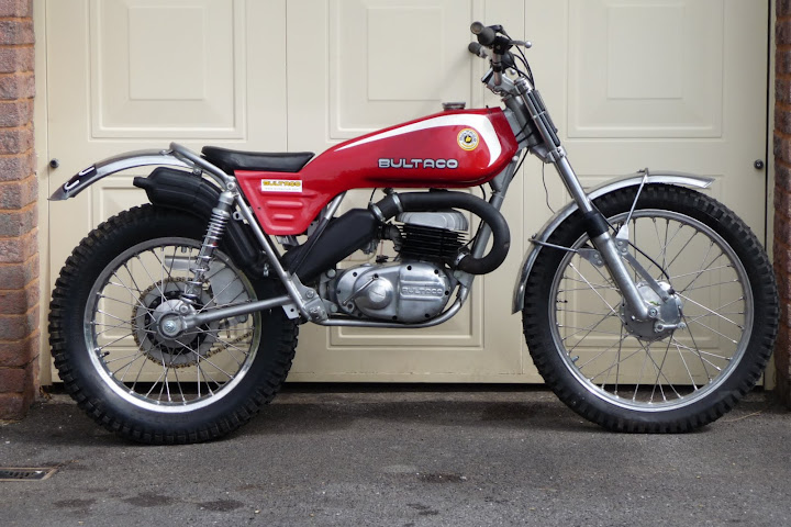

Hi
Well nearly finished.
It has done two trials and is getting better (I wish I was).
http://lh3.ggpht.com/_BIYAknJT7JM/S9xiSKKS...20/P1010772.JPG
Runs a lot better with the new rear box and have just modified the yokes and fitted a 48 rear sprocket to try out.
Have managed to get hold of a barrel of the correct type but need to heat it up so that I can twist the liner by about 3mm to line up with the ports.
Regards
Martin
C:\Users\Owner\Pictures\bultaco 09\P1010772.JPG
Edited by Triple_X
