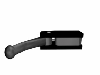

Well i said i would design a new lever and this is a basic 3d prototype view of it. It works by using an offset centre pin creating a cam effect when rotated.
The movement is 4mm of travel but i can make it whatever i want. The force required to operate the clutch is 50% of what it is normally.
This also means it would be easier to control the slip of the clutch as there would be double the distance the lever would have to travel to engage the clutch fully over what it is now.
The pin in the centre is on an econcentric bush allowing for fine adjustment.( and I mean FINE ! )
To see a quick 3D animation of it, look Here

Very vey good idea Ian, do you have the machinery or access to the machinery to be able to make a prototype?
Lloyd
Yes , Im lucky that I own a design engineering company ;)
I noticed kids using 2 fingers on the clutch lever because they couldnt pull it in with 1 finger. So this would help them out for sure :(
