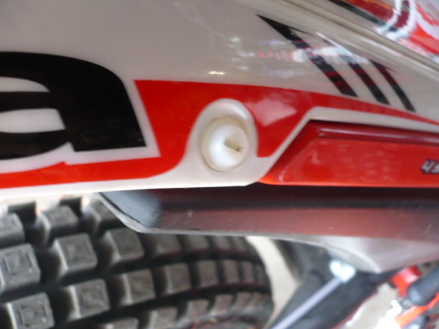

heres the hook up.
first, remove the fender{mudguard}
trim the lip of the edge that goes over the air box.
install plastic screws in the rear holes, you can use door panel push clips from an auto parts store as well,
screws look nicer, so..
when you loop it, or back it into a rock...it will pull the plastic screws out, and let the fender flop up, rather then snap off.
FYI: 2013 fenders will fit 2009 and up bikes, you have to order the air box cover as well, make cleaning the air filter much easier. only mod you need to do, is drill a hole in the fender for the very front screw. see my post on the 4T

the white plastic screws i used were found at the local auto parts store...cost 1.29 for a pack of 10
i watched a younger rider buddy,. ground loop his 2013 with my fender mod.
pealed the fender back..didnt break,
he found the 2 screws in the dirt. put them back in...and it worked just fine..
before this mod, he had replaced the rear fender 2 times in 3 mos...
told me, hes looped it, and tacod the thing daily...has yet to snap the fender.

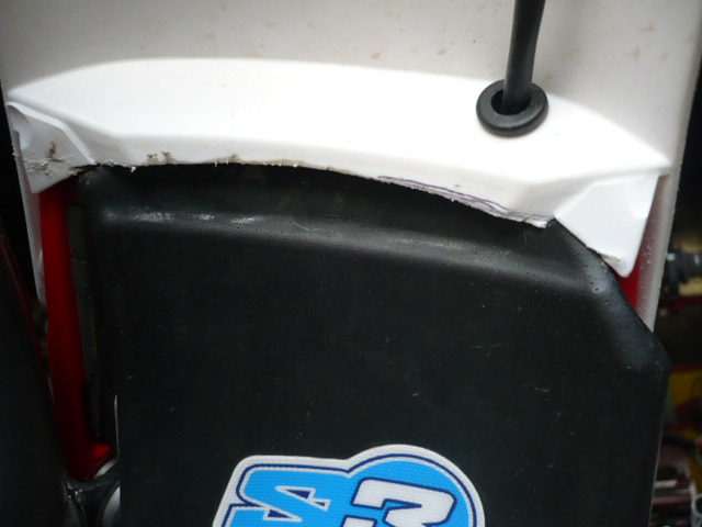

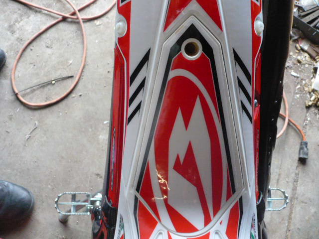

I liked the look of the black Top Trial Team mudguard kit. Well what a disappointing experience fitting a TTT flexible mudguard turned out to be. While the plastic is flexible enough, the item arrived without any installation instructions. But that’s OK as there is a low-res two page document available on the web sites of several of the Top Trial Team UK resellers. All goes well until Step 8. “Cut out the corresponding template from the suppled sheet”. This is the template you use to cut into your original guard in order to shape the Beta OEM guard ahead of the Top Trial Team part. But where's the template? It seems to me that the document on the web should have THREE pages. Oh well, with some care and attention I cut the old mudguard (a brave move when it is perfectly good to start with) using a hacksaw and a Stanley knife. This cut creates the “V” where the front and rear guards meet. The fit as seen from above is good. Just likes the photos on ebay.
However, when you screw the Beta ‘front half’ of the guard back into place you are effectively pinching in the sides, so physics dictates that the centre will rise slightly as the sides get pushed in. When you screw the TTT ‘rear half’ of the guard into place you are effectively pulling down the sides, so that the screw holes line up and the centre gets lower. This results in the Beta Guard sitting higher than the new Top Trial guard with a very sharp looking "V". Doesn't look bad in the photo but in real life I think "Damn, wish I'd just stayed with the old guard".
IMG_4605.jpgI
I’ve had a vasectomy so the placement of this sharp looking 'V' it doesn’t worry me unduly. But its not the sort of finishing detail that I expect to see and it lets the rest of the bike down. I wish whomever brought this product to market had spent a little more care in the design and execution. A couple of extra mms here and there and the fit quality would have been spot on.
Also I read somewhere in the forum that you can re-use the rear part of the OEM mudguard that you cut off. As I see it, this is rubbish as the TTT new metal support - nicely made and it does fit beautifully on top of the air box under the mudguard - adds height to the under guard area so that there is no way the OEM mudguard can stretch to fit over it while still using the original mounting holes. This is just one man's experience of course and while the panel-gap is not Lexus quality I had hoped for better.
The solution: is to drill a new hole in the Beta guard and anchor the Southern most part of the guard through the rear air filter mount with a 25mm screw.
