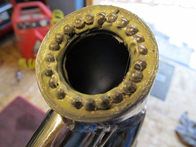

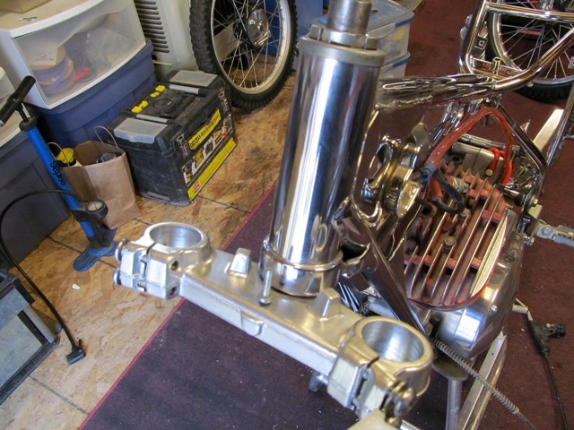

I took the front end on the TY apart to clean and grease and I,m having some trouble reassembling it.I tighten the spanner nut on the steering stem just enough to feel no back and forth movement.Then I tighten the bolt on top of the top triple clamp that threads into the stem and it tightens up to where it will not turn freely.I tried to just snug the top bolt and it still does it.If I back off the stem spanner nut enough that it doesn,t bind then I have back and forth movement.What am I doing wrong?
Doesn't sound like you are doing anything wrong, perhaps more a lack of experience or "feel". Assuming you cleaned the balls and cups from all the dead grease and then regreased and put 19 balls in the lower and 22 in the top then you are heading in the right direction. Tighten down the stem nut with either a C spanner or light hammer and punch and now turn the lower yoke back and forth a few times to feel the tension. It will tend to bind on the full locks and may feel a bit "gritty" if you are using the old balls.
Fit the upper yoke and stem bolt and now line up the yokes and fit the forks. I would fit the wheel and brake cable and now give it a few turns left and right on full lock. It will be slightly tighter at the full lock position. Test the fore and aft movement by applying the front brake with the bike off the stand and adjust the C nut if required. Tighten down the stem nut and then the rear horizontal bolt when its lined up.
Most likely you will need to adjust this all again as the grease squeezes out and beds in the balls

The reason it gets tighter when you fit the top bolt is that there is a small amount of axial clearance in the threads of the stem and the castellated nut, so when you tighten the top bolt, the castellated nut moves downwards slightly, which tightens the clearance on the ball races. I find I have to set the castellated nut slightly loose so that when I tighten the top bolt it ends up perfect. Sometimes it takes a couple of goes to get it right.
I suggest you leave the stem clamp bolt and the tube clamp bolts on the top triple clamp loose until you have got the top bolt tight and the castellated nut set in the right spot.

I did what feetupfun suggested and got it to work acceptably,but not slick.I decided to take it all apart again to re-clean and inspect more thoroughly.There were 23 balls on top,not 22 as Tony said there should be so maybe that was causing it to bind a little.The balls are in good shape (always a good thing!) and appear to maybe be new so maybe the guy I bought it from added one too many. The other problem I see is the very top race is pitted from what was probably rust.It,s only about a quarter or so of it,but maybe enough to cause it to feel a bit rough.I,m going to polish on it and will report back after it,s back together.
That,s funny OTF,LOL.I guess I,m not sure where I got the termm "triple trees",but now that you have me thinking about it,that term really makes no sense.I can see "triple clamps" but I don,t know where the "tree" part would come in.
Roughness of the race will definitely cause you grief. I hope you know for about $50 you can buy a full set of tapered needle roller bearings, or if you are an originality-is-important type person, you can still buy the standard Yamaha races and use loose balls for about $80.
