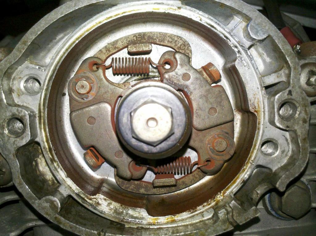

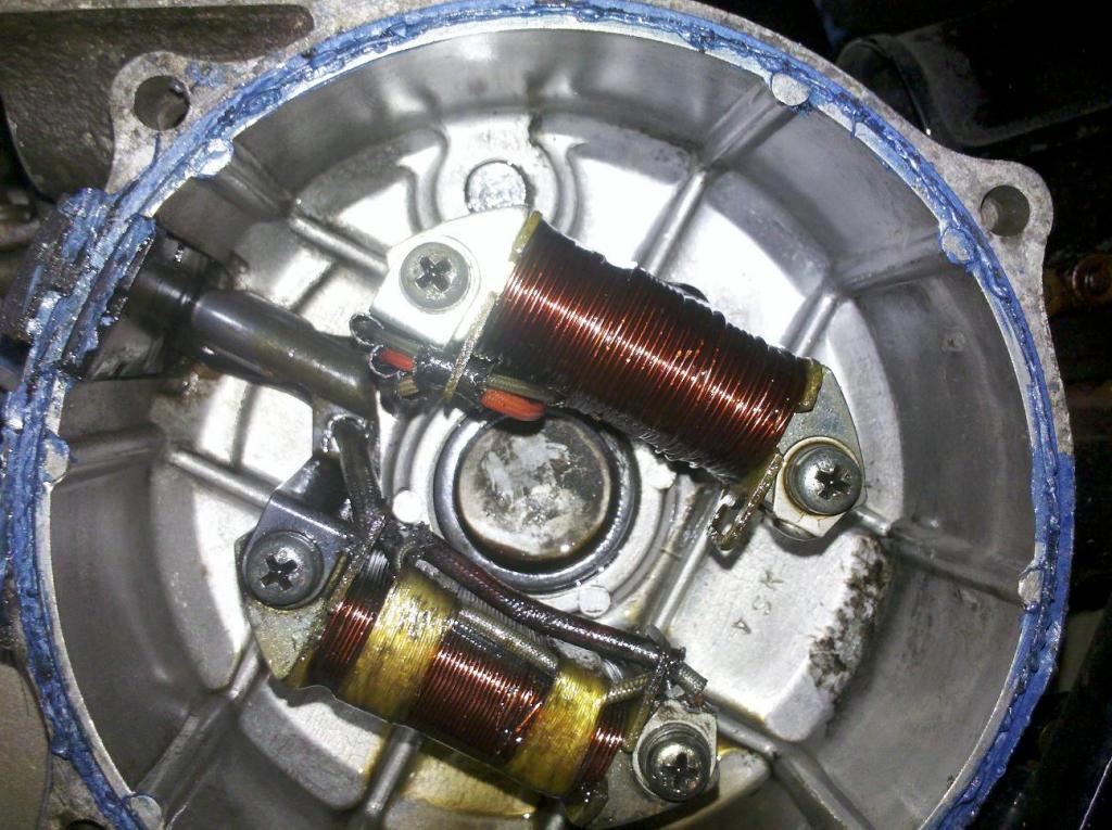

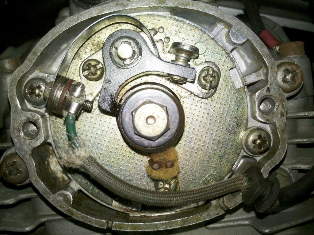

Thanks for everyones input. See attached images of points/advancer/Stator/flywheel.
Does anyone know if the TL ignition should have some sort of a suppressor or resistor in the plug cap/lead?
Could someone compare the the magnet placement vs timing marks on the flywheel?
The ignition stator is on the bottom in both the picture and on the bike.
the old man honda link with the part number information is very helpful, thank you so much!
sorry I cant help with the magnet positions at the moment, but it does look the same as the TL set up I think I have got a spare I will try to have a look.
The advance unit does look different to mine (from memory, not seen it for a while) yours does look very dry, a bit of lubrication might help things move a little easier.
