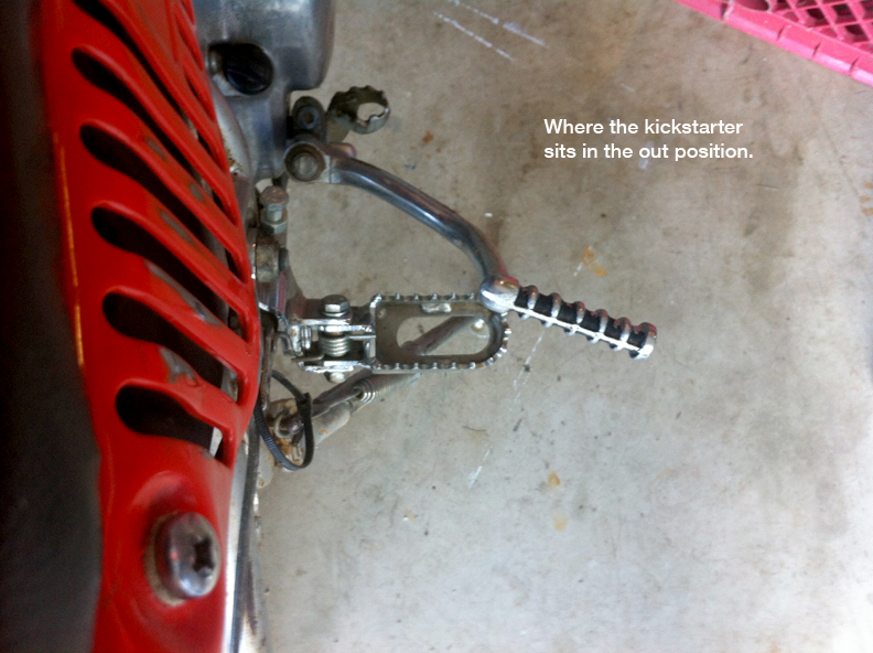

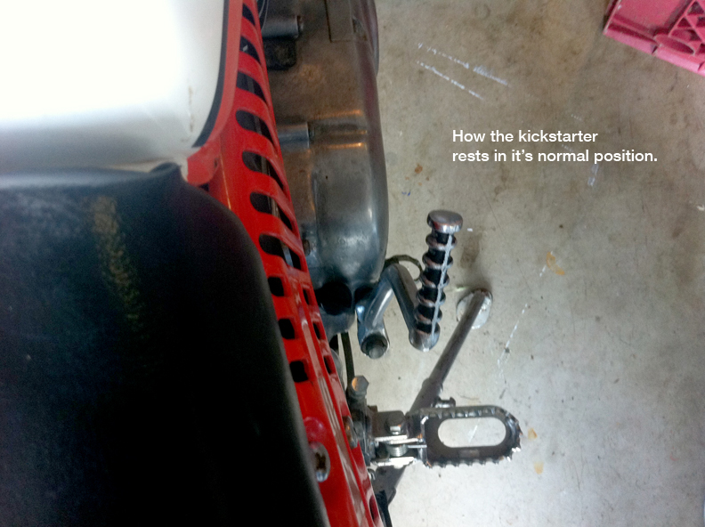

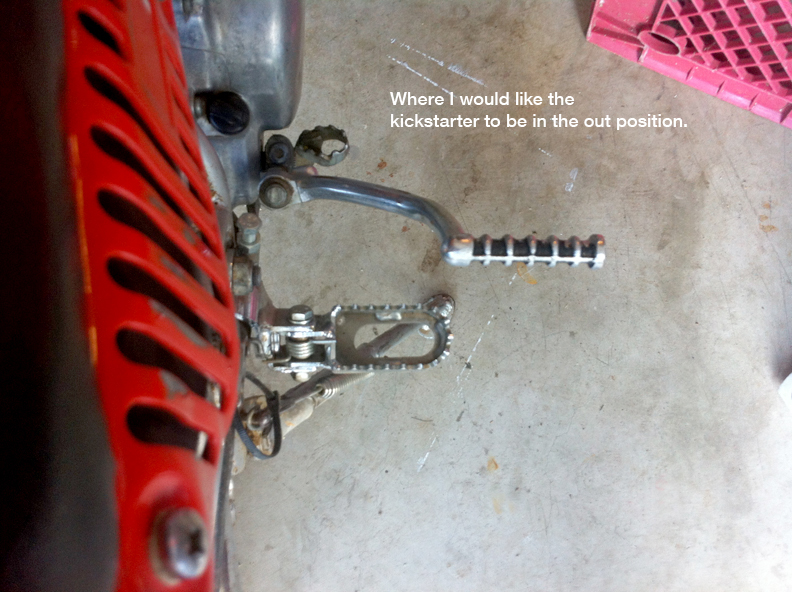

Please see the attached photos. I believe that some component of my kickstarter is not right. I know this bike is pushing 40 years old and most of its life is a mystery to me but I find it unlikely that the solid steel kickstarter is bent. But it looks to me that this is the case. Other 175 owners -- Does you kicker fall out as far as mine does? Does it sit as far out from the bike in the 'normal' position as mine does?

definitely bent, part where your foot goes should be over the side casing when folded in more towards the red exhaust guard

The lever is bent at the pivot. I have 3 of these bikes and they all bend with time. If you keep them running well you only need a smooth 1 or 2 kicks. Back fire or kicking over and over, not taking the free play out before kicking all make it bend more. I ride the AHRMA events Cal. OR. and WA. and countless hours of practice and mine has been bent back into shape about every 2 to 3 years. I put them in my floor press support it so the bent part is up press slowly with the lever cold until it is how it should be.The foot lever will tuck in to the pipe and will be in line with the pegs. I have done this to at least 5 levers and 3 of my bikes several times and have not broke one yet.The levers are very weak. A easy starting bike will make it last longer. They bend back easy and have not got much weaker as I can tell. I would like to fit one of the WR 200 levers as shown on this site if I could find one .

They are quite flexible, and can be bent easily with a
3 foot long pair of pipe grips.. Stilsons, holding the
part in a hefty bench vice.... No heat required.
Yours seems to be bent at the root, about one inch from the pivot.

I did finally come across a large piece of pipe with a wide enough diameter to slip over and bend it back into place.
