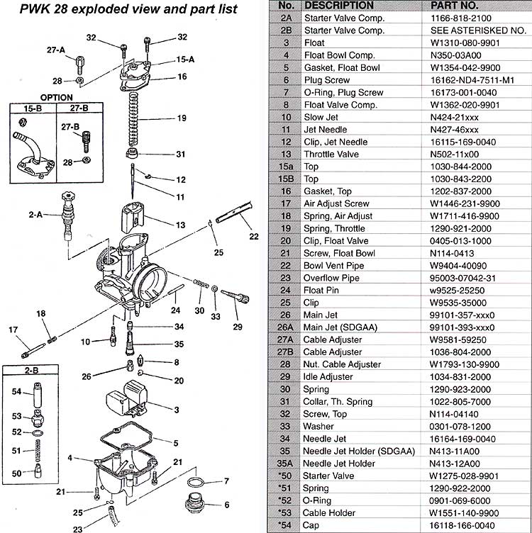

I had a small brass pipe drop out the carb when reassembling today I think it sits in the bottom of where the main jet went and protrudes into the main inlet area of the carb,can anybody confirm this??
Is it your emulsion tube?, bunch of tiny holes in it and a hood on top where it's exposed in the Venturi
If so it goes in from the top and the main jet screws into it holding it in place
That sounds like it sticks out but can't see any holes in it
That bit that dropped out is the needle jet, it is like a top hat shaped piece of brass and is held in place in the body by the needle jet holder.
Put it back in the bore where you took the needle jet holder pt 35 out, with the smaller diameter going in first then it sits on it's shoulder and just protrudes into the air bore of the carb body. Then refit the needle jet holder. This jet sometimes falls out when you turn the carb over with the needle jet holder removed, so always take care. The bike hardly runs if that part is missing!!
It is part 34 -Needle jet on the Keihin PWK28 parts list.
Hope that helps.
Edited by overdale
That's spot on mate exactly what I needed,had been searching the net for a decent exploded diagram,thanks very muchly
