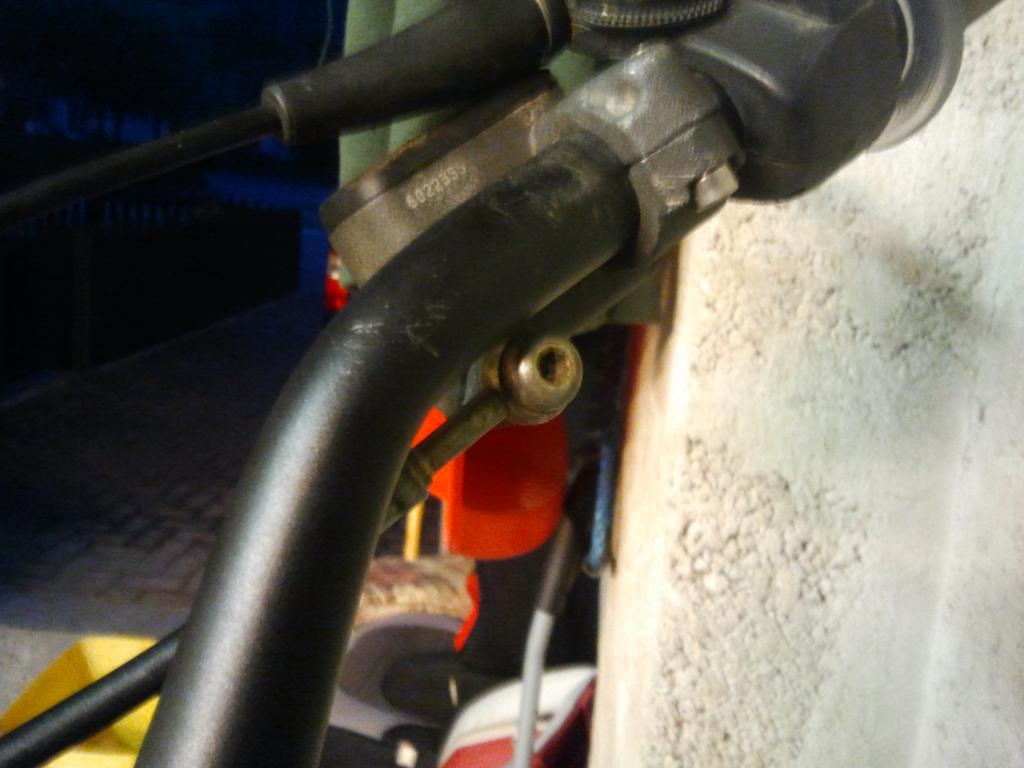

In this picture the brake pipe coming out from the bottom of the resevoir prevents me from adjusting the brake lever to suit my need also you can see the throttle housing sitting atop of the resevoir

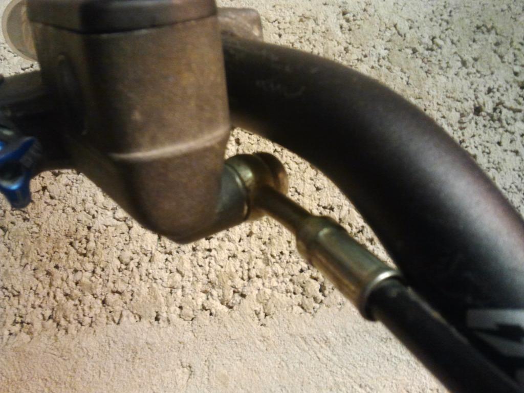

This picture shows just how tight to the bars the pipe is, Is this all normal???

possibly you could loosen the banjo bolt and rotate the brake hose down a tad bit so it follows the same angle as the bars. Giving a little more downward swing for the master cylinder?
Or take a chance and bend the metal part of the line a little bit away from the bars?
The throttle can be oriented anywhere...360 deg.... even with the cover below the bars.
Those banjo bolts can be TIGHT.
Mine won't move.
But I have loosened them slightly and changed the angle of the hose without letting air in.
