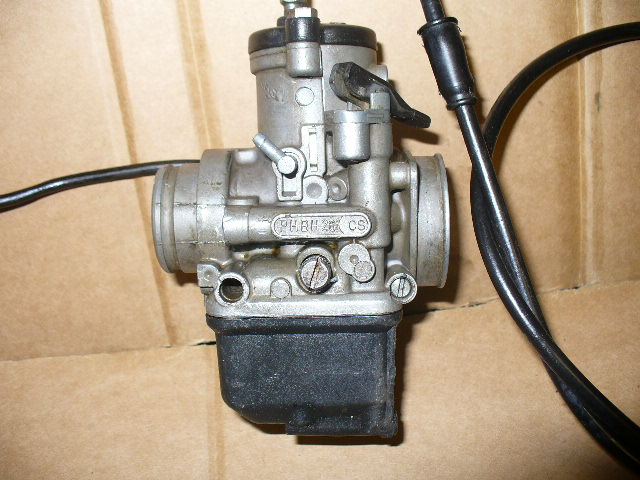

This way I noticed a corrosion inside the old needle jet diffusor, as if eaten by the wurms (magnified..)
This PHBH carb certainly has an air mixture screw. Its setting seems to have a big effect on the first half opening of the slide.
Hi Chuck
Thanks for the suggestion. I did check the reeds before, but you are right, I will check again.
I now know that I need a magnifying glass to see some of the issues. Not sure if it is my age or the sensitivity of the bike..
PHBH 26 PS is a petrol screw.
PHBH26CS is a air screw.
Edited by b40rt
