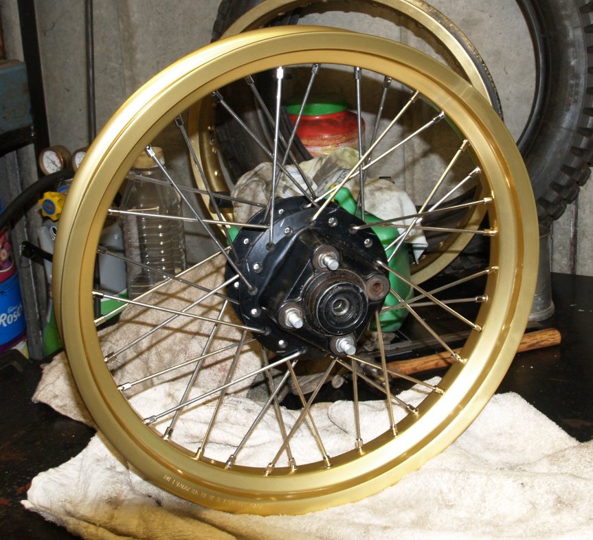

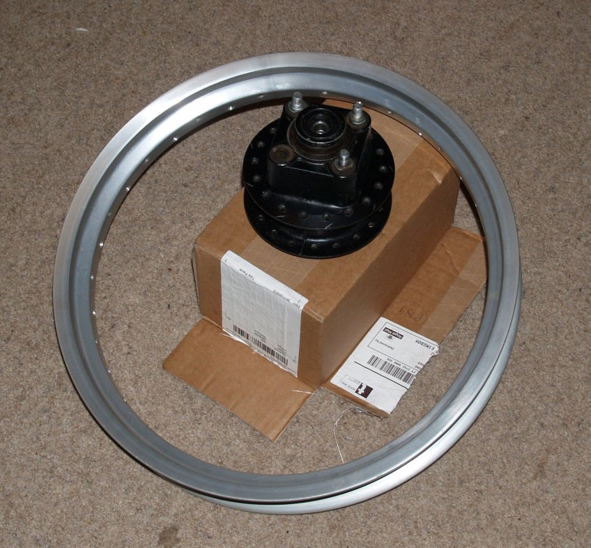

Came in the post today,
Unsure if I should anodise them as I've been told it might come out patchy.
Look very nice as is, very tempted to order a set as have some other bits ordered and could all be shipped together :D
The new ones are slightly different, if you look at my first set of photo's and these. The pinch bolts on mine are at the side compared to the front on the older sets, plus other slight differences. Look alot better.
Get them, look great!
