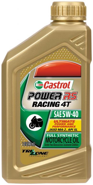

Now what? I cant run my bike without oil! So it was off to Google to find out what oils for wet based clutches where out there. No motorcycle oil manufacturer out there talks about viscous coupling specs of their clutch engine oil. So it was trial and error. To cut a long story short after testing many different oils I tried a bottle of Castrol 5W 40 RS 4T engine Clutch oil and it did the trick.
I can put my bike on the stand now start it, pull the clutch in and the back wheel stops. The clutch is consistent. I am happy.

Not sure If Andy will allow me to post this oil bottle. But here goes.
PS: The RS on the label stands for "Reduced Slippage".
